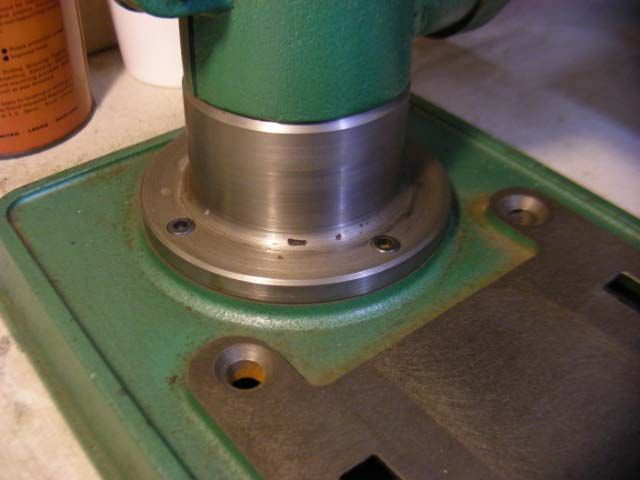

                                ega
                                  @ega
                                  MikeK:
                                  I would encourage you to try the weldment approach. Here is one I made to rescue a condemned hobby drill press:
                                  Rough turning the disc and tube allows easy vee joint preparation and after welding the result is re-machined (mine hasn't quite cleaned up).
