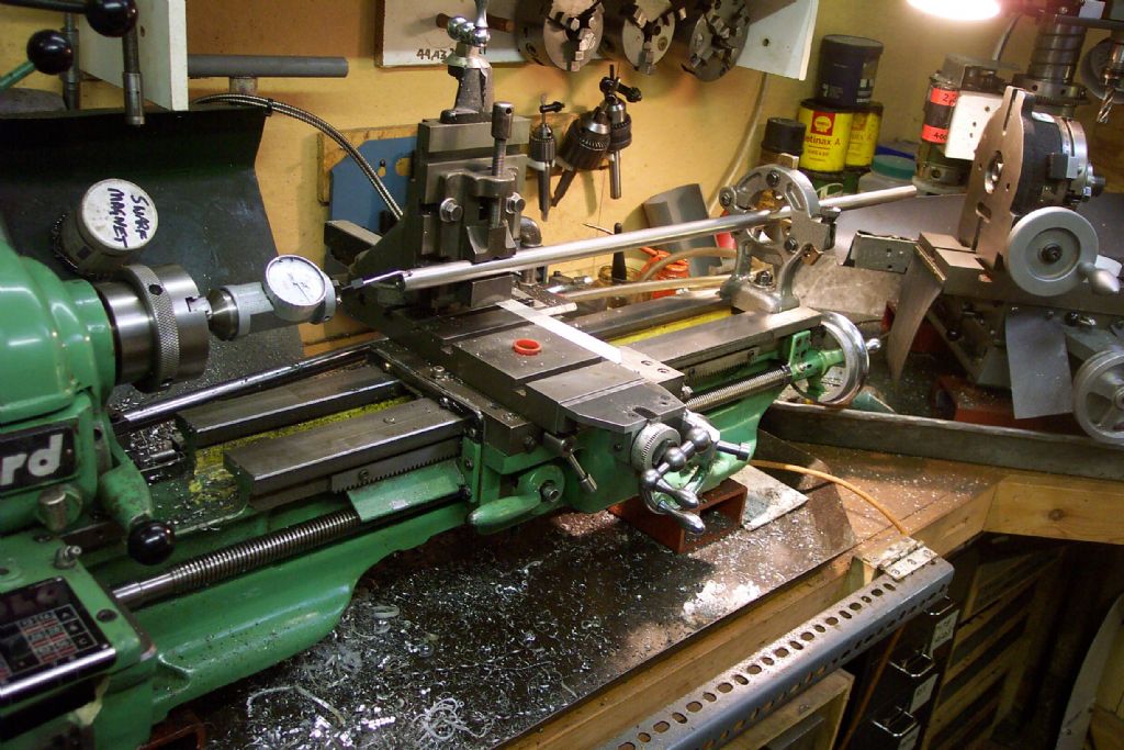

      Hello,
      I am new to the forum and have just bought a Myford Super 7 which I was hoping would replace my slightly worn Boxford. I have noticed the spindle bore is really small on the Myford so the question is how could I accurately centre drill 20mm round bar 240mm long?
      Maybe sounds a daft question but I was used to placing bar through the spindle and only have about 10mm exposed from the chuck to dial it into centre and then drill.
      Any suggestions/ advice would be great otherwise I'll have to trade the myford for something slightly bigger.
      Thanks,
      Chris

          The usual way would be to use a fixed steady but if you have to do this regularly it would be a bit of a faff.

            Hello Chris
            This works well with the appropriate accessories. Length and diameter [within reason] are not a problem

              Again I would suggest a look at my web pages on using a fixed steady, as per David's method. Look here for the appropriate page,

                Thanks for the reply's it looks like a steady is an essential part for the Myford that I don't yet have.

                  I needed a fixed steady for a job on my S7 . So i made a simple one and it works well

                    You could make your own – see HERE
                    You will need a facility for milling but otherwise it's pretty easy.

                      A quick and dirty solution is to clamp a chunky piece of wood to the cross slide and drill/bore to bar size from the head stock. You can always slit it to the center with a couple of screws to clamp it.
                      Seeing as you are only centering there will be little or no radial load.
                      Will do for a one off job.

                          Thank you, but the idea isn't really that novel. It was a furniture commission job, the bars were 16mm grade 304 stainless steel 800mm long, to be drilled and tapped M4 at one end, there were I think 12 such bars to do.
                          It worked very well, the steady at the tailstock end was only there as a loose support, all the thrust for drilling came from the X slide. Setting up was a doddle using the co-axial indicator which allows viewing from one side over a full rotation around the work. It had been a christmas present to myself the previous year. I did test it against the more traditional method with a finger DTI, using a mirror to view the difficult sides; there was really no contest.
