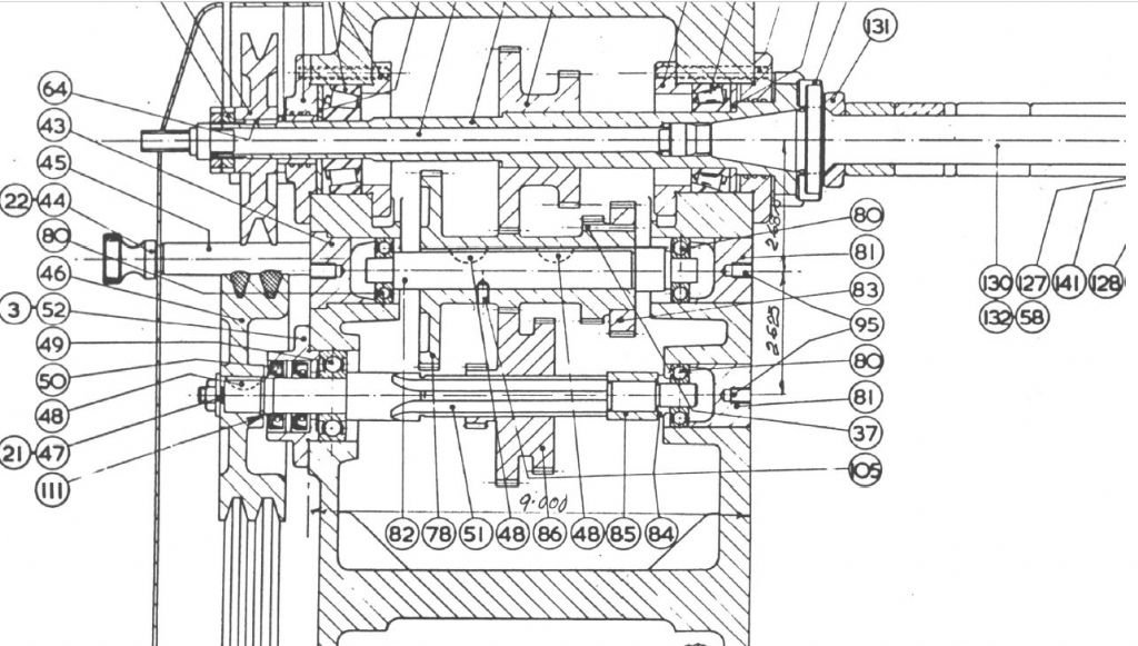

                                    martin cross 1
                                      @martincross1
                                      Having re read the manual I now have. It does refer to spindle drive and gear box. ‘shafts in the gearbox are well supported by ball bearings’. No mention of bronze anywhere.
                                      #448090
                                      martin cross 1
                                        @martincross1
                                        Thought this might be of interest. 2A internals.
