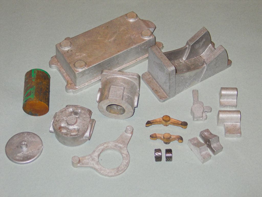

                              Phil P
                                @philp
                                What you need is a pair of gears like the ones in front of these castings.
                                My dad made those many years ago on his CVA hobbing machine.
                                Phil
