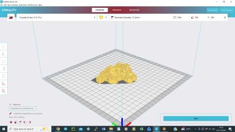

              I have just found the drawing I converted using the imagetostl converter.
              The drawing I scanned was black on a white background, but I had to reverse the image to white on a black background (I used Paintshop pro).
              Here is the drawing:
              2ndManV2
              Here is a screenshot of it in the Creality slicer:
              Creality man
              Unfortunately, I dont have the 3d printed part to photograph.
              Hope this helps
              Stuart

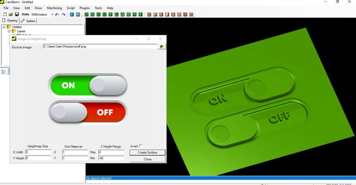

                  CamBam CAM software will convert an image to a surface. See attached picture.
                  You get 40 free sessions and after that it won’t produce g-code but otherwise remains functional in all ways.
                  Martin.
