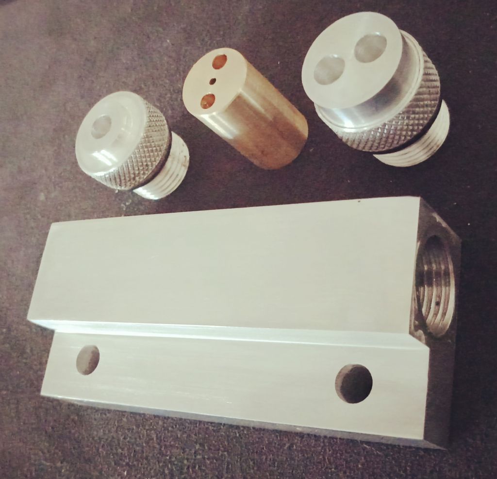

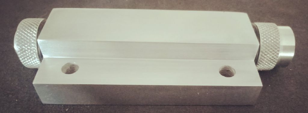

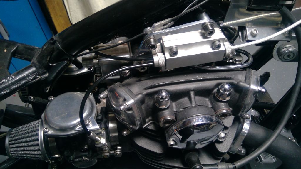

      1.jpg2.jpg3.jpg5.jpg6.jpg7.jpg8.jpgI made this splitter a couple of years ago. The XS650 has two BS38 carbs as stock, the 74 model had a twin cable throttle, one cable for each carb. Adjusting the throttle slides was accomplished by an inline adjuster on each cable.
      A very fiddly process using the tiny adjusters, so I built this cable splitter and replaced the twin cable throttle with a single.
      The splitter body is aluminium bored 14mm and threaded each end, the slide is brass and the end caps are aluminium. Picture was taken before I slit sawed cable entries. When finished I plugged the holes in the end caps, assembled the unit and dunked it in my anodising bath. The finish came up rather nice.
      Rather than have a splitter flopping around inside the tank tunnel, I opted to fix It to the right top engine mount. I spun up some 3mm nipples, fixed them to the cables and dunked them in my solder bath.

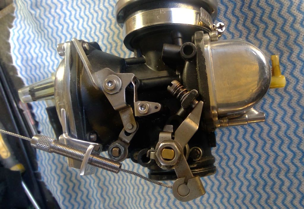

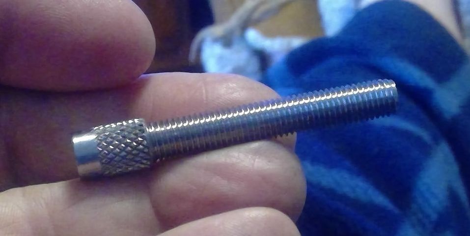

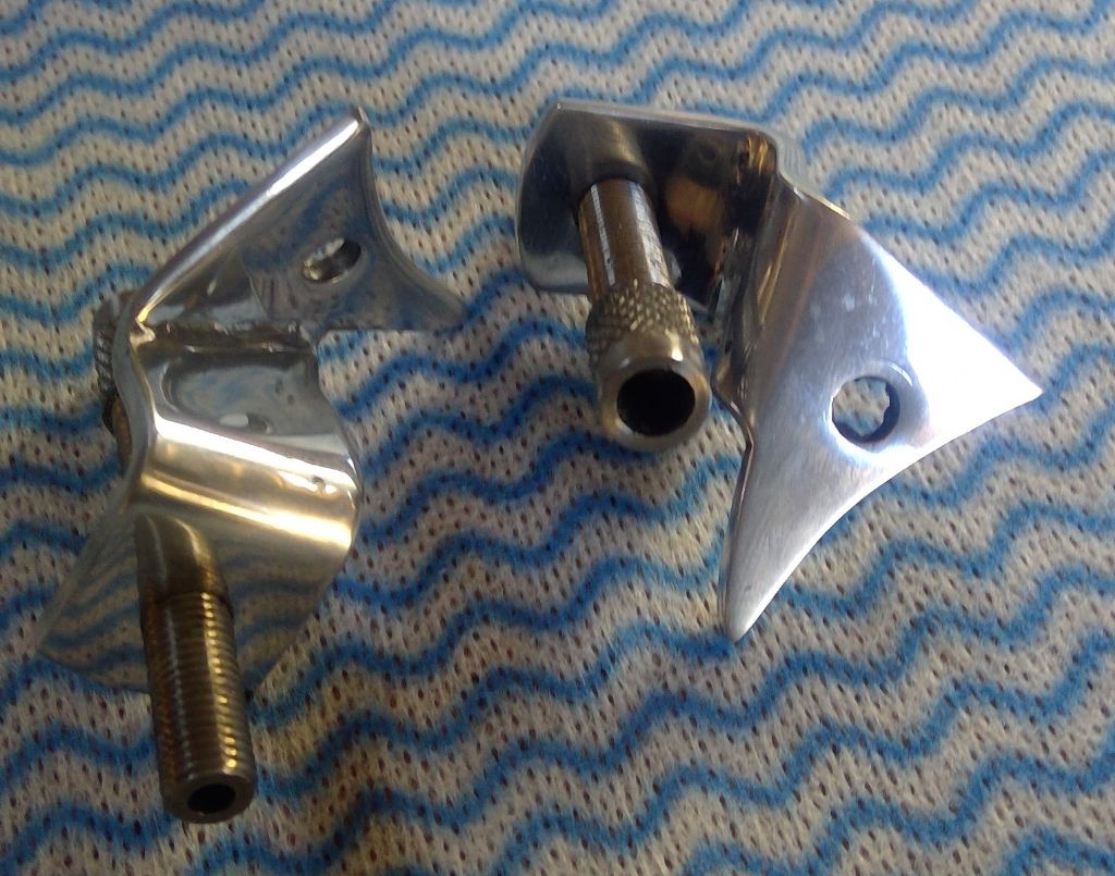

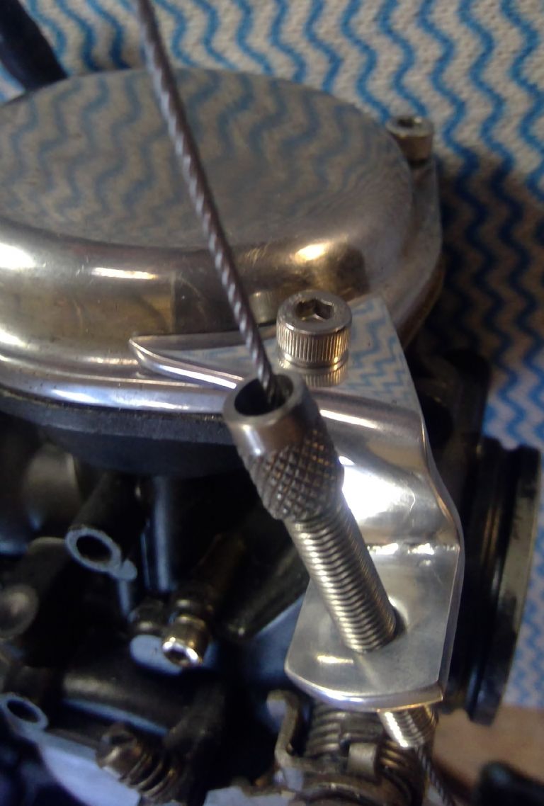

      To fix the cable to the carbs and allow for butterfly adjustment, I made a couple of brackets and spun up an elongated stainless adjuster. Yes, there is a lock nut for the adjuster, just not assembled in the picture.
      This mod made syncing carbs a breeze.
      Later on I binned the carbs, bought a couple of VM34 roundside's and installed them on custom manifolds. The carbs came with a small plastic splitter, but the round slide cable pull is quite a bit longer than the BS38 cable pull, so, the splitter didn't have enough pul, it9.jpg now languishes in the useless parts bin.
      I may make a splitter for the new carbs later on.

          Another very nicely made gadget !
          Would there ever be any danger of the internal slider sticking in the bore owing to corrosion, and jamming the carbs open? (I note the O rings on each screw-in component, but moisture could travel down the Bowden cable from the throttle grip end). Did the unit operate dry or did you lubricate it?
