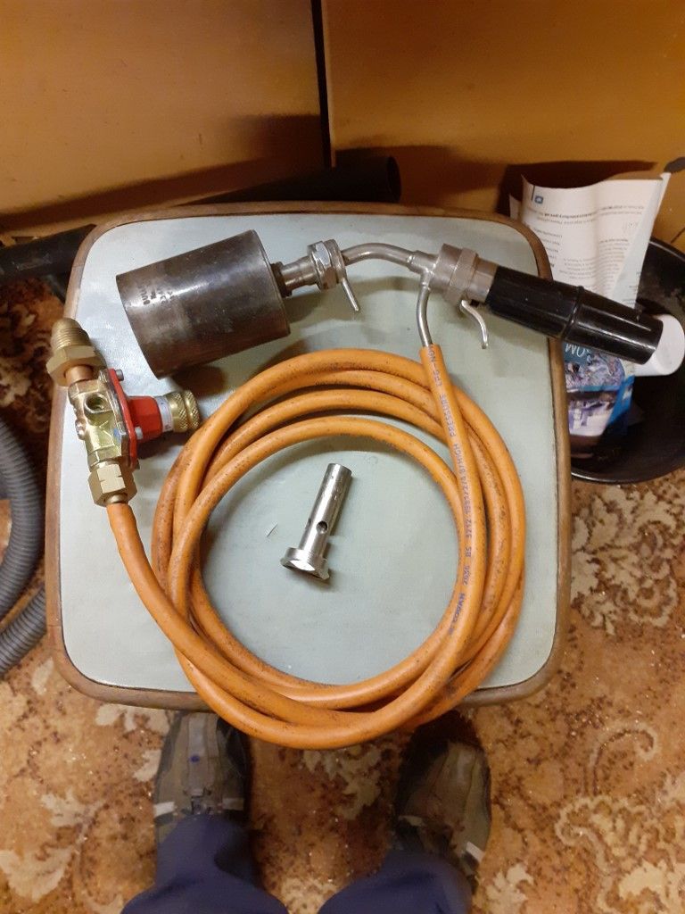

                                            I have a bullfinch and you say it is no good for boiler making yet it seems to put out a lot of heat surely I would have thought it could be used for that purpose or have I not understood this.
                                            Here is the one I have so going by what people have said, I would need to change this for another brand.
                                            "NOTE" the hose has just been pushed on the ends and WILL BE secured before I use it.

                                              #435182
                                                Derek, comments were about the Bullfinch 404 (4100) which the OP mentioned.
                                                You need to get a large amount of metal upto heat when boiler making and the smaller Burners of the 404 won't do that, think of it like painting a ceiling with a 1/2" brush. vs a Sievert roller.
                                                Give me a day or so and I'll see if I can get my Sievert to braze a small part.

                                                  OOPS sorry missed that. all the same would my set up do for boilers
                                                  Thank you for pointing out my mistakeblush

                                                      Vic, seem my reply to Derek re the 404/4100 Bullfinch, this only has 3 burners (high temp not so high wattage). Bullfinch do other torches that work like a Sievert and take high Kw burners.
                                                      Derek, yes your style of Bullfinch with the burner shown will be OK for upto medium size boilers, I used to have the same torch myself.
