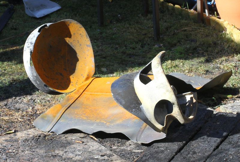

        Hi I'm new to this. I'm wanting to build a small steam locomotive perhaps 5" or 7-1/4" gauge.
        I have a steel fire extinguisher (powder) that I can use as a boiler and that's about 5" diameter.
        What kind of thickness should the boiler walls be if I want a reasonable operating pressure?
        Is steel suitable for boilers with the concern of corrosion?
        Second. I'm using the marine style boiler design with a cylindrical fire box, is 4" cast iron drain pipe suitable? The only concerns I know is that cast iron is hard to stick weld and I want to weld the tube plate to it.

            Creating own boiler without the knowledge and approval of the boiler inspector is a bomb without knowing when it will explode.

              Julian's suggestion to join a boiler club is the best way to start your project. Your loco will have to be certified by a club inspector before it can run on their tracks. The 5" and 7 1/4" gauge for locos normally refers to the width of the rails, not the diameter of the boiler a 7 1/4" gauge loco has a boiler about 10" diameter, similar to that on my 6" Ruston Proctor TE.
              Steel is a suitable material. Anti-rust treatment and storage procedures are used to prevent corrosion. Copper is better but more expensive.
              I am in Australia and have to build the boiler to the AMBSC Boiler Code – Part 2 – Steel Boilers. A summary of the requirements are:
              250-700 kPa (36-101 psi), Fire tube boiler – 50 litres max., Water tube boiler – 25 litres max.
              Barrel diameter 4” – 14” Dia., Barrel thickness not less than 6mm
              AS 1074 pipe fittings are not suitable (standard pipe fittings from hardware shop)

                      Assuming you want to run the loco on a public track then any steel you use will have to have the correct paperwork from the supplier so you can basically forget about using any form of recycled materials.
                      5-6" Boiler would typically need to be in the region of 6mm thick steel for the barrel and plates. This allows a cetrain amount for wastage (rusting) but the use of a boiler treatment will slow the process but still not allow you to use thinner material.
                      Forget the Cast iron
                      What is your welding like? it will need to be tested which means sending it off for non destructive testing. Are you able to specify the correct weld prep to get a strong enough joint for the design pressures?
                      As said talk to your local club boiler inspector where you intend to run the loco.
