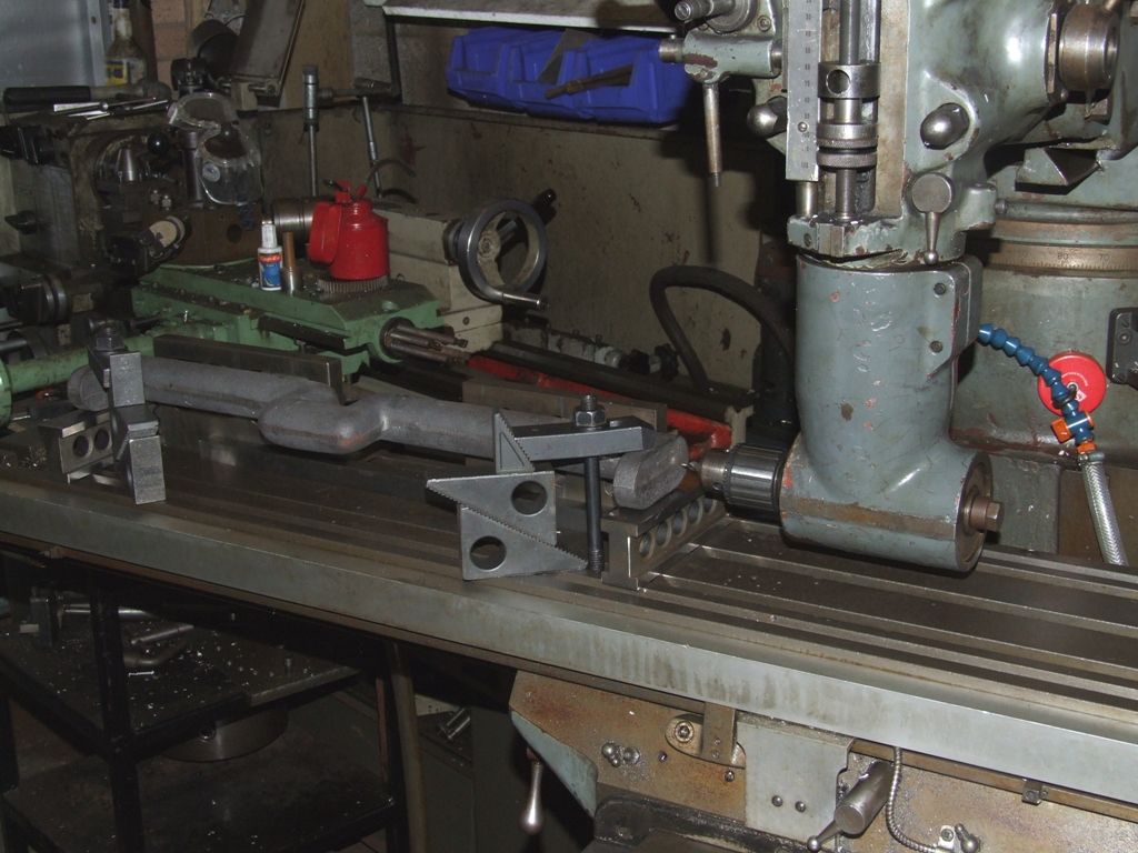

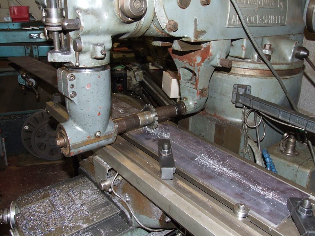

                            I can vouch for the JohnS drawbars; I bought the longest one for use with my horizontal attachment. The problem is that as the quill has to be partly extended to fit the attachment the standard drawbar disappears into the head and hence is difficult to tighten. The longer drawbar has an extended hexagon section so that it doesn't disappear.
                            I tell a lie, I've actually used my horizontal attachment twice. Once to precision drill the centres on my traction engine crankshafts prior to machining:
                            And to machine V-grooves on the inside of the flats for the rear wheels, to simulate the join, as per full size:
