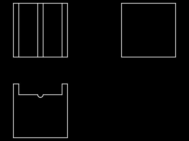

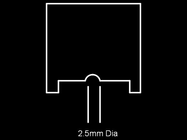

      Hi Guys,
      half circle bore.jpegI intend boring a half round groove of diameter 2.5mm into the bottom of a 15mm mild steel cube. Not sure what tool to use any suggestions welcome.
      Regards
      Chris

          I think you will need to explain more clearly what you are trying to do.
          Is this a circular groove in a face? (Say for an O-ring face seal)
          'Bottom of cube' could be anything.
          Ian P
          #515910
            You could make a D bit or use a 2.5mm ball ended milling cutter, in both cases just plunge straight in.

                      Looks to me Chris has drawn a 2.5mm diameter dimple in the part, so as said a form tool or a 2.5mm Ball Nose slot drill could be plunged in 2.5mm for the desired shape.
                      Emgee
                      #515932
                        1.25mm plunge would be betterwink

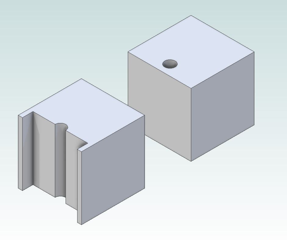

                                  Hi Guys, thanks for posts for clarity the half round groove goes right across the face in a straight line.
                                  Regards

                                    But now we know the groove is right across the part then it seems a round nose form tool/slot drill is the tool needed.
                                    Emgee

                                        So it is beginning to sound like a groove 1.25 mm deep across the face with a 2.5 mm ball nose end mill.
                                        Personally, I would be wary of doing it all in one cut, half the diameter of the end mill, even with a very fine feed.
                                        (Unless you have LOTS of spare cutters to hand! )
                                        Maybe gradually take out out some of the material with a 2mm end mill, for part of the depth, and then finish off with the ball end cutter.
                                        Howard

                                          Chris now we know what you need to do my suggested ball nosed milling cutter would do but if you don't want to buy one then you can actually do it but simply drilling a 2.5mm dia hole right through the cube and then using a standard milling cutter to form the rectangular recess shown on your sketch which will split the round hole in two.

                                              Posted by JasonB on 29/12/2020 13:09:33:
                                              Like it Jason, clever. many thanks.
                                              Chris

                                                Though Chris said 'groove', I read his drawing as a dimple!
                                                As this is a classic engineering problem with 2D drawings, may be worth mentioning the answer. It's to provide two or more views of the object, which together provide all the information needed to derive the 3D shape.
                                                Basically, draw what the object looks like from three sides, like plan, front and side:
                                                Actually this object only needs two views to show Chris said and meant 'groove'.
                                                Far more to Technical Drawing and Draughtsmanship than this example, but the basic idea is simple enough.
                                                Jason removed ambiguities by developing the object in 3D CAD, which I generally prefer because the 'real' shape can be viewed from any angle. But 2D drawings are also useful, and good ones are a positive joy to look at – art!
