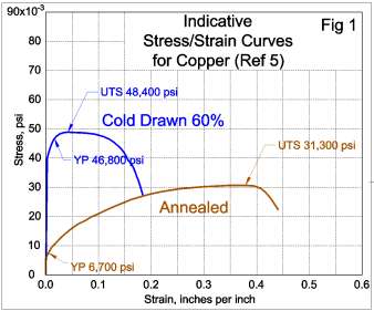

            The UTS Method Explained – Part 2 – Fudge Factors
            The UTS method takes the Ultimate Tensile Strength (UTS) of un annealed (i.e. hard) copper and multiplies it by a so-called “Safety Factor” to arrive at a safe allowable working stress for the copper.
            This is completely fallacious as I’ll prove below.
            Please note that some of the information below is borrowed from the article “The Yield Point Method ” by Les Smith and Alan Brown, published in Model Engineers & Workshop magazine in Volume 134, Issue 4765, June 2025 edition, page 26.
            1. The Properties Of The Two Materials In Question; Hard Copper (UTS) Method and Annealed Copper (YPM) Are Totally Different.
            Just look at the Stress/Strain curves for Cold Drawn and Annealed copper shown below:-
            Copper-Boilers-Stress-Strain-Graph-Copper-02-240807-90cm
            Clearly the mechanical properties for the two grades of copper are totally different. They might as well be different materials – as indeed they are – the only common denominator being in the name – copper.
            But the UTS method takes the value of the UTS for hard copper and multiplies it by a so-called “safety factor” to arrive at a safe allowable working stress for annealed copper. Where is the engineering logic to take a mechanical property from one material and apply it to a different material?

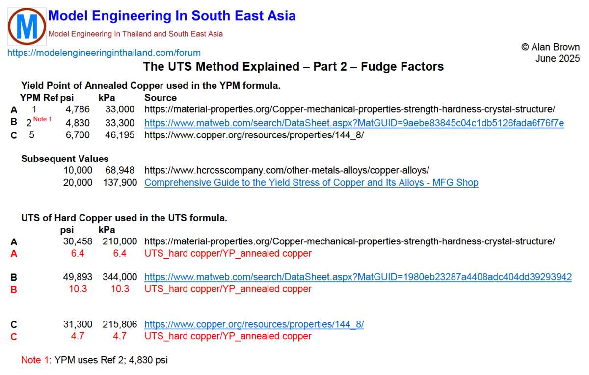

            Where Did These “Safety Factors” Come From?
            If anyone knows please come forward.
            But I’ve discovered something quite interesting.
            If the UTS of hard copper is divided by the Yield Point of annealed copper, guess what?
            The resulting ratio for three sources of information yield:-
            4.7, 6.4 and 10.3.
            Say a range from 5 to 10.
            Isn’t it interesting that these are so close to the so-called “Safety Factors” of the promoters of the UTS method of 6 to 10.
            Food for thought?
            More coming in the next post.
            PS
            Here are the sources of information and the calculations for the ratios mentioned above:-
            The UTS Method Explained – Part 2-250606

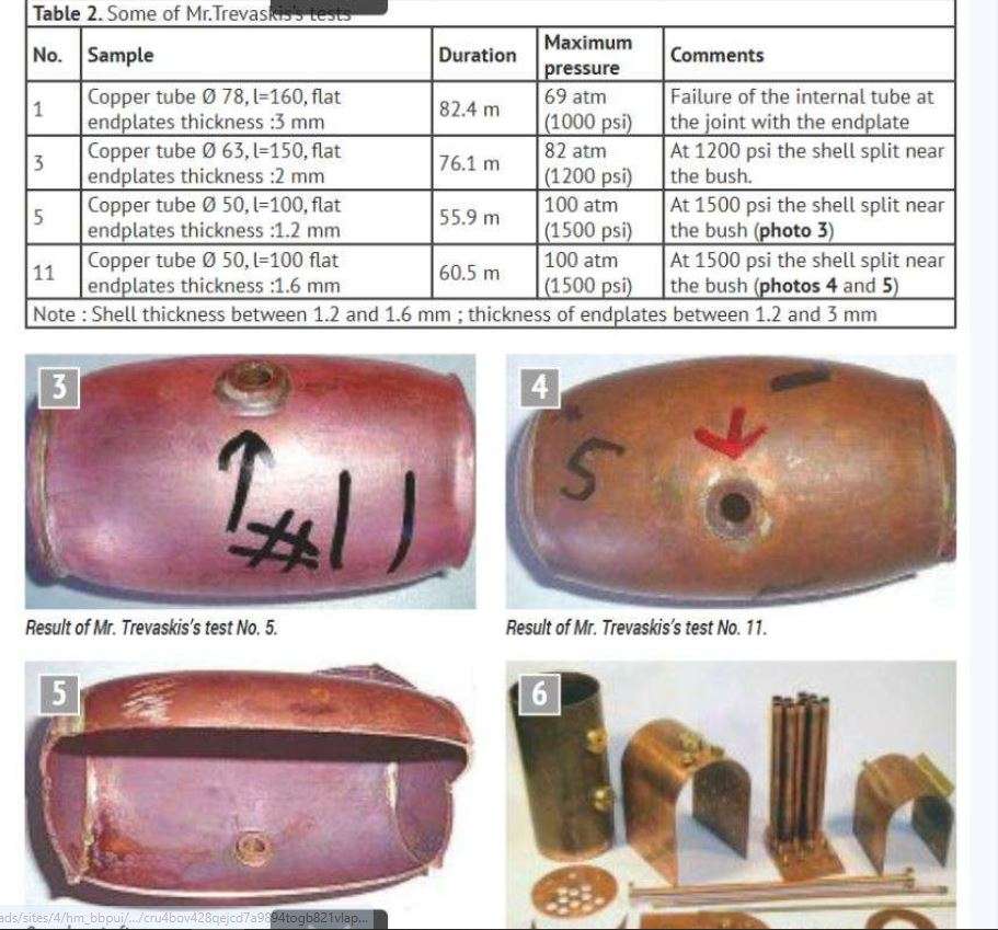

                                  #801586
                                    Michael I did ask for similar in my 1st or 2nd reply. Even happy to accept FEA if cost or other factors prevent real copper boilers being made.
                                    There is an article in ME4651 that shows some test boilers pushed to bursting, the failure is mostly around bushes. It would have been interesting to see some samples with the inlet on one of the endplates so nothing to affect the tube. Photo from article
                                    If I get a moment I might run the two calculation methods to see what the minimum thickness for thos eexamples works out at.

                                        On JasonB Said:
                                        Michael I did ask for similar in my 1st or 2nd reply. […]
                                        I accept that, Jason … but it’s not quite what I was suggesting
                                        Those were boilers, but I think it would be worth backing-off a little, and simply collecting more evidence … from many samples of simple tubes of various sizes
                                        [it’s mathematically simple to normalise the results]

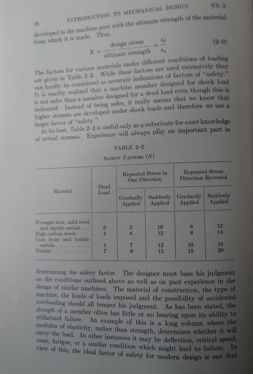

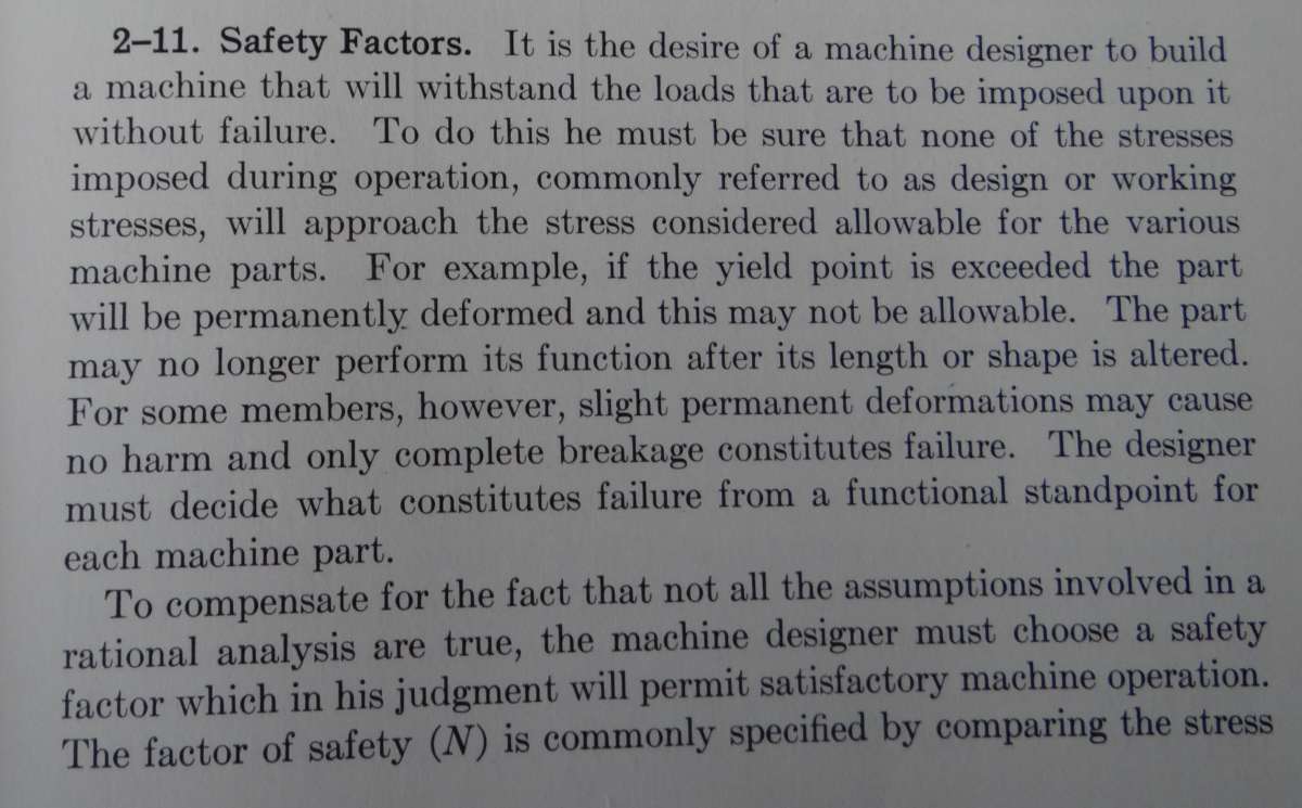

                                                Happy to oblige!  There is nothing ‘so called’ about Safety Factors, they’re well established, dating back well over a century.
                                                Here’s a couple of pages from JEFFERSON T.B and BROOKING W.J Introduction to Mechanical Design. New York: Ronald Press Company,   1951.  (Chapter 2)
                                                DSC06904
                                                DSC06905
                                                is used only to indicate the margin between the actual stress computed as accurately as possible and the stress that will cause functional failure under operational conditions.

                                                  I remain unconvinced that reaching the yield or proof stress in an annealed copper boiler represents “failure”.  This is an assertion by the authors, but not borne out by facts such as:
                                                  • Stays and areas around the corners of fireboxes yield according to FEM analysis on a typical boiler.
                                                  • Jason shows pictures of simple boilers that have gone way beyond yield and ultimately failed from joint failure at a stress concentration.
                                                  • Luker reports a significant strengthening after yield as the material work hardens and stresses are redistributed around the structure.
                                                  • Taking material past it’s yield point is an established method of strengthening thick cylinders.  Also known  as autofrettage.

                                                      The UTS Method Explained – Part 3 – Safety Factors
                                                      The factor of safety (FoS) in engineering, particularly in the design of steam boilers, is a measure of how much stronger a system is than it needs to be for its intended load. It is defined as the ratio of the ultimate strength (or failure stress) of a material to the allowable stress (or Working Stress – WS) applied in operation.
                                                      Mathematically, it is expressed as:
                                                      Factor of Safety = Ultimate Strength / Allowable Stress
                                                      Example 1
                                                      From the article “The Yield Pont Method ” by Les Smith and Alan Brown, published in Model Engineers & Workshop magazine in Volume 134, Issue 4765, June 2025 edition, page 26.
                                                      Taking a known published design for a G.W.R. boiler for a 5” gauge loco from Page 150 of The Model Steam Locomotive as an example, where:
                                                      Diameter, D = 4.75″
                                                      Working Pressure, WP = 110psi
                                                      Test Pressure = 2 x WP = 220psi
                                                      Shell Thickness, T = 0.092″
                                                      Using Barlow’s Formula. S = (P x D) / (T x 2)
                                                      WS (Stress) = (220 x 4.75) / (0.092 x 2)
                                                      WS = 5,679 psi
                                                      Ultimate Strength for annealed copper = Yield Point for annealed copper (to avoid permanent distortion) = 4,830 psi
                                                      Factor of Safety = 4,830 / 5,679
                                                      Factor of Safety = 0.850
                                                      Yet the UTS Method proclaims a FOS of 8 (Average)
                                                      Clearly the UTS Method is both incorrect and misleading, because it does not allow for the Yield Point of annealed copper.
