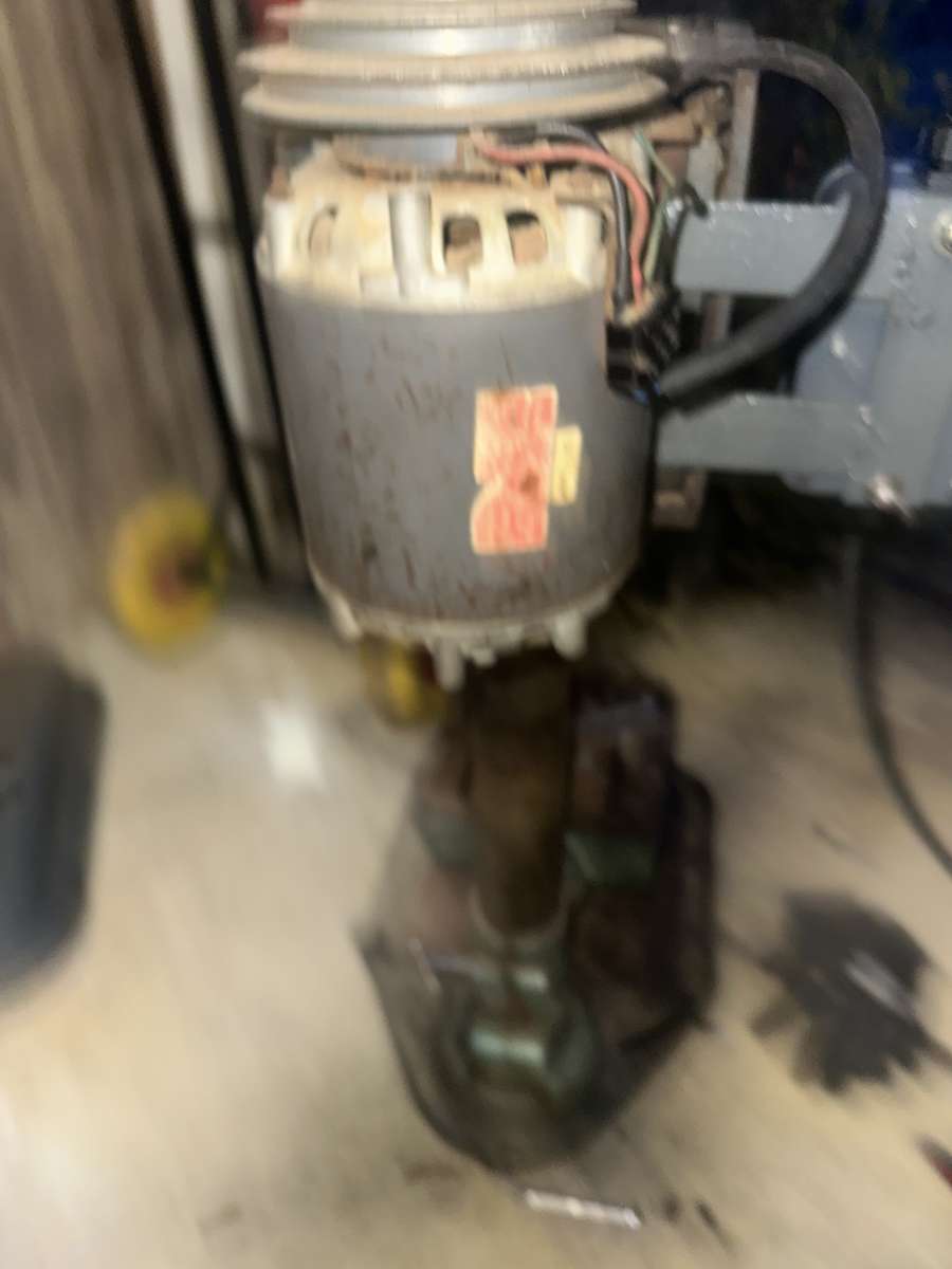

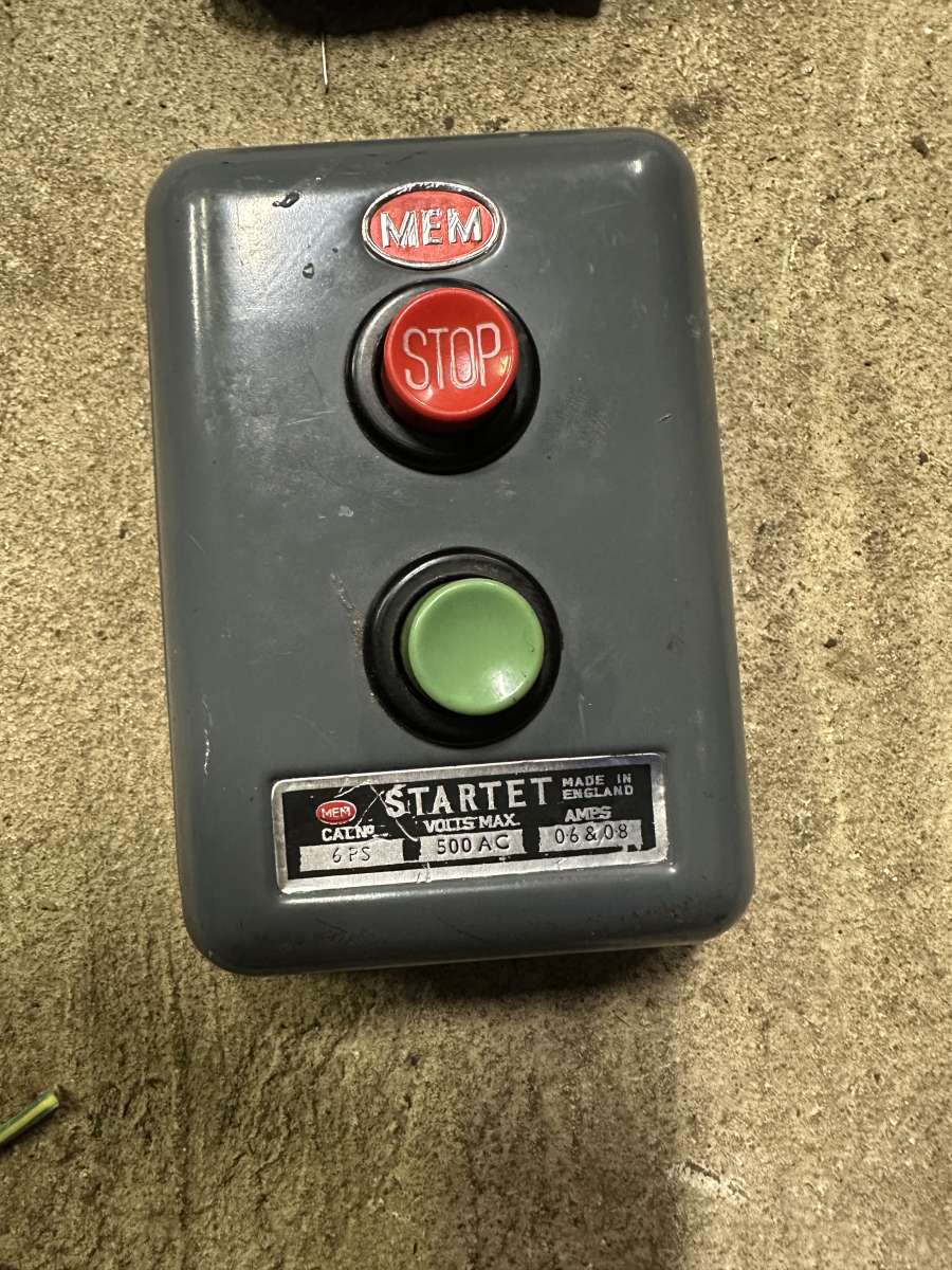

      I recently bought a Meddings bench pillar drill (originally 3 phase) that someone has converted to single phase 240V My floor standing drill has an old ‘Startet’ starter/overload switch so I decided to fit one to the new drill, and made up the brackets and fitted it today but it keeps tripping. I cant read the motor label as its worn off, but on the higher Startet rating of ……..
      ….. hang on…. !!!! I read it a 8 amps but its 0.8 amps no wonder its tripping!! I have actually spent three hours fitting this today FOR GOODNESS SAKE
      Who ON EARTH would need a starter at 0.8A though????
      I started typing this post to ask what the problem of tripping might be, it now looks like either I need a higher rated starter or I will reconfigure mine to work just as an on/off switch.
      So, what is the likely amp rating of a motor for a hefty bench drill any ideas ?

        who would need a 0.8A overload = a small 3 Ph motor eg a suds pump. As for your drill you will need to give more info, does the data plate not show FL amps a wild guess would be 2-4A but depends, could be 1.5 – 1.8. Every motor should have an overload device ! Many do not.  Noel.

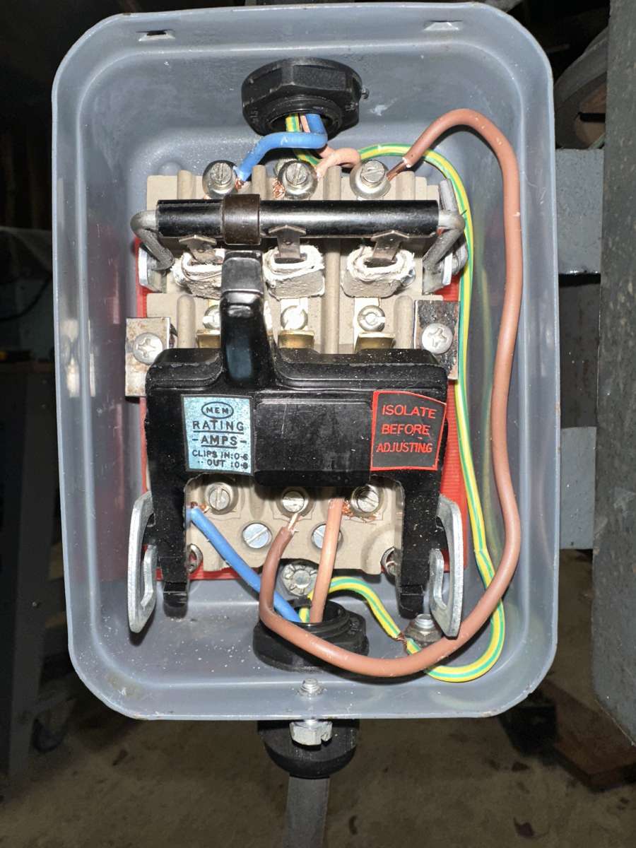

        Robert Atkinson 2
          @robertatkinson2
          That starter has asbestos in it. wrapped around the contact arms. Probably best to carefully remove the entire starter, double bag it and dispose of it.

              If it actually is asbestos, leave it well alone and put the cover back on. It is not a hazard inside there and undisturbed.
              The usual non-metallic materials inside equipment like this are thermosetting plastic, e.g. ‘Bakelite’ and its descendants, and synthetic-resin bonded fabric or paper. Not asbestos.
              The point though was the current rating of the starter-switch, not its materials.

                That fluffy-looking white blanket wrapped around each of the contact arms is almost certainlyAsbestos.
