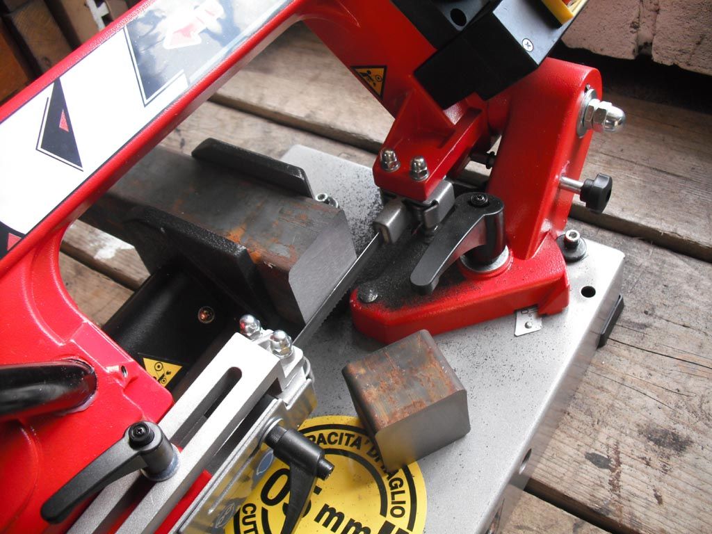

        I recently purchased some 50x50mm square bar which I am going to cut into tool post sized pieces for my CL300 lathe. Trying to do this with my 125mm angle grinder in a cut off gadget, has shown up it's short comings. Not going to the pub has left me with some surplus cash so I am considering buying a small band saw. I say small because I am restricted for space and would want a bench top mounted one which would fit in a 600x600mm (2ftx2ft) area. I have looked at the advertisers on this site and the only one which fits the bill, is the HV85 from Chester Machine Tools. I am looking for information from any one who has had experience of this or similar models.
        Thank you in advance
        Anthony.
        #470305
          Look at a Femi or copy, only need about 1ft width of bench and are light enough to pick up one handed and tucked away if you want the benchtop space. A search for Femi will bring up several posts.
          This is mine, 120mm x 120mm capacity and will do your 50×50 in under 2mins.

                            Hi Jason. I have just looked on line and seen the Fermi model 780. Is this the same one you referred to?
                            #470382
                              I have the 782XL details here, was going to get the 780 but they were doing an offer on the 782XL which meant it was only about £10 more so why not. Looks like I gave slightly the wrong size but I have cut bigger than quoted size with a bit of jiggling about.

                                        Well, I've jumped in and ordered a Fermi 780 bandsaw which will hopefully be delivered on the 20th of this month.

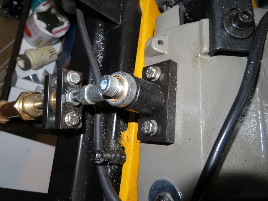

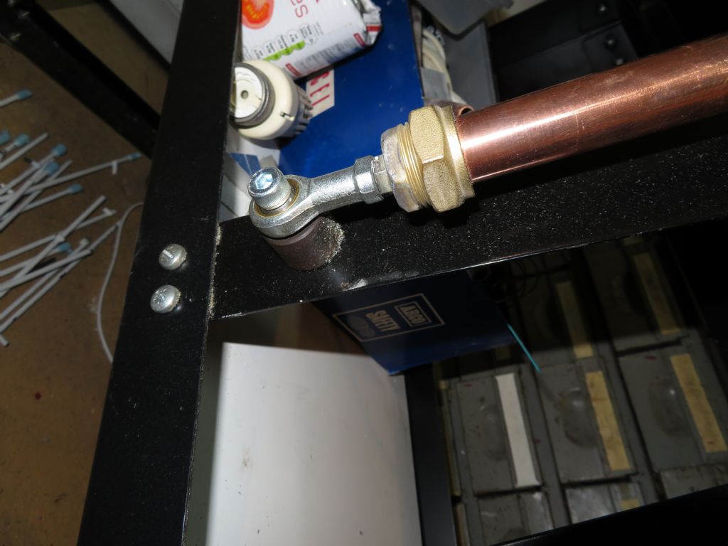

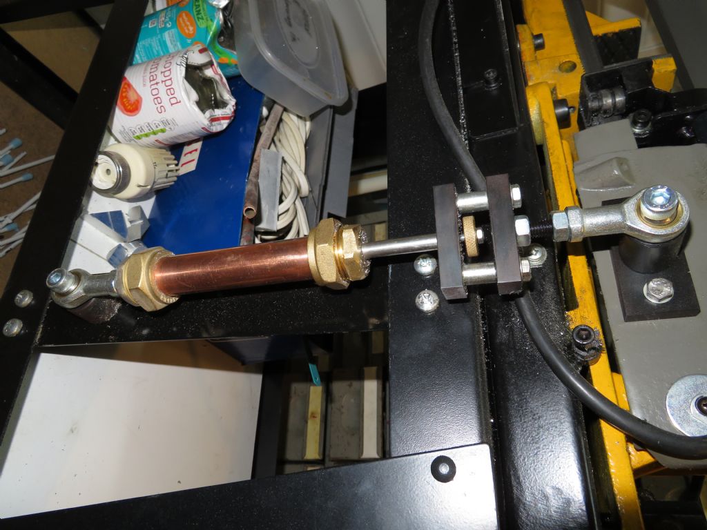

                                              img_2411.jpgimg_2410.jpgPosted by larry phelan 1 on 09/05/2020 14:32:13:
                                              I have a 6×4" model from Chester, which just eats the work, hacksaw has an easy life these days.
                                              No use to you, I know, but just for the record.
                                              Oven man, I would love to fit a hydraulic down feed, any info on that ?
                                              Hello Larry. Here are some pictures of the hydraulic downfeed fitted to the Chester HV80. The cylinder and piston bit is based on the design by Mike Cox with the top and bottom bits custom made to suit the HV80. Nothing is square or vertical so the rod end joints work well. Mikes design was for a 4 x 6 model so you could use that without any major modification. You can find all the the details on Mikes Workimg_2412.jpgshop website.
                                              Hope this helps
                                              Peter

                                                  I had an Email from Amazon the other day, saying my bandsaw was delayed and would now be delivered on the 26th of the month. I was quite surprised to receive a text from DHL this morning, saying they would be delivering today. About 1 hour later, it arrived.
                                                  As you can see it came with a european plug fitted. I don't have an adapter, so I cut it off and fitted a british 13amp plug to see if it worked. I hope I haven't voided the warrantry.
                                                  The saw looks well made but the user manual is terrrible. It has been written for every EU country and there is quite often just one line of English on a given page. I think some drastic photo copying and editing is called for to produce a useable book which will be considerably thinner. The only thing I can fault the saw on is the 20mm gap between the end of the vice jaws and the blade. It is now set up on the bench and I will be trying it out later.

                                                  Anthony Knights
                                                    @anthonyknights16741
                                                    Made the first cut today with my new toy .Brilliant!. Thank you to all who answered my original query.1st_cut.jpg
