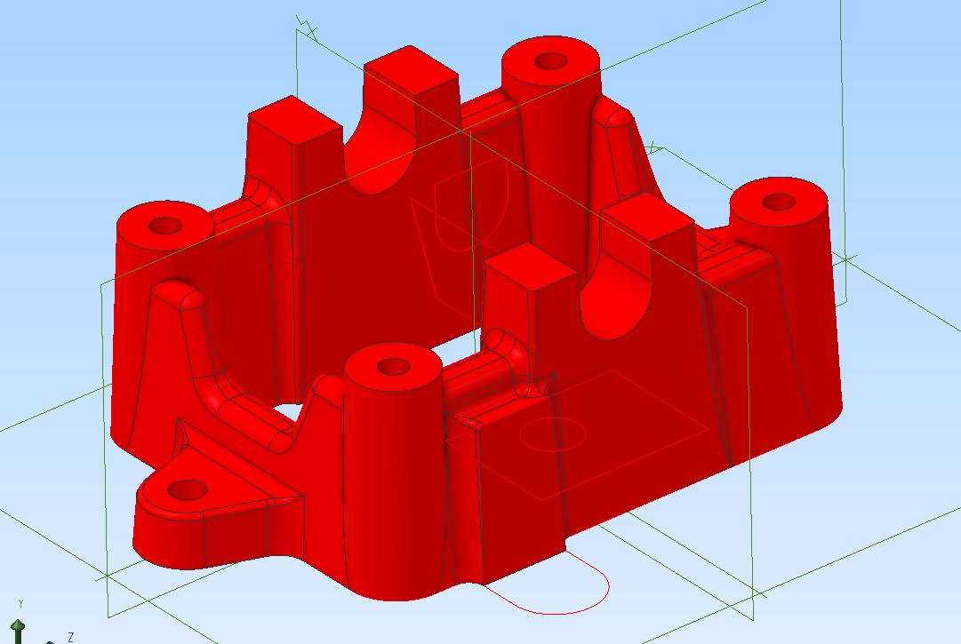

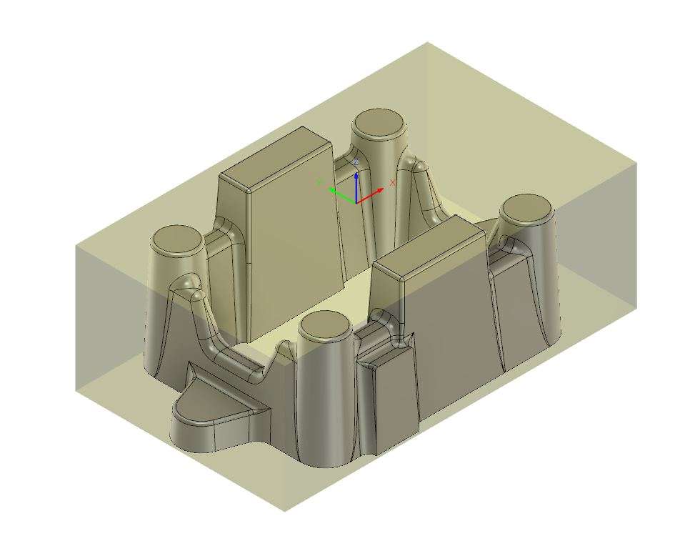

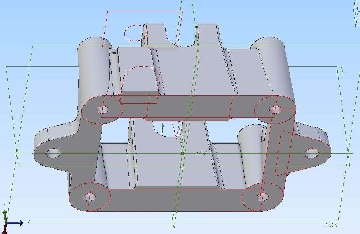

                            #820344
                              On Clive Foster Said:
                              completely gets in the way of 3D CAD thinking where you start with primitive and remove the bits that aren’t what is wanted!
                              A lot will depend on the part you are modelling. Simple things may be easier that way but much like Julie I tend to “fabricate” the part from a series of primatives and then possibly cut some of them away or they may just stand on their own.
                              Take what I’m drawing up at the moment which is the bed plate for an engine which will be cast so there is draft on all the verticals..
                              primative
                              I did not start with a solid rectangular block. Instead I drew 4 circle in the corners and extruded then, then the walls between, then the thicker bearing supports and the mounting lugs. Only then did I cut out the various holes and the two “U” shapes which can be seen as red lines on the centre axis. A view from below shows the various sketches in red that were extruded with suitable draft angles to make up the part.
                              primative 2
                              It is only when I get to the CAM that I tend to start with a solid block.
                              primative 3
