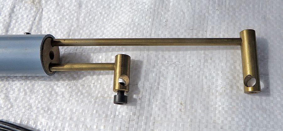

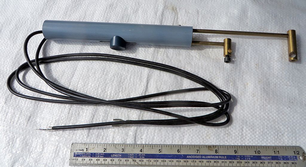

      Hi All,

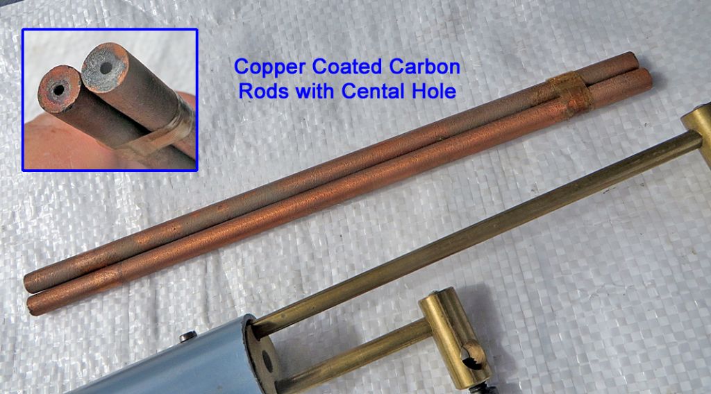

      Just going through last weeks auction items and found this oddity:
      Comes with a couple of bundles of these copper coated rods which appear to be carbon with a small central hole all the way through.
      All I can think of is some sort of carbon arc setup, looks highly dangerous if that is the case.
      Help welcomed.
      Cheers, Martin

        #603977
        Dave Halford
          @davehalford22513
          Carbon arc brazing torch with cables that are too thin as usual.
          Exciting to use though
          #603978
          Paul Rhodes
            @paulrhodes20292
            Martin your spot is correct. A carbon arc brazing unit. Bring the rods steadily closer till arc commences then commence heating/brazing. Unsophisticated perhaps but works well.
            #603980
            Adam Mara
              @adammara
              I have an old XP welder, and it has similar carbon rods, which are for brazing rather than arc welding, never tried them though!
              #603995
              Don Cox
                @doncox80133
                Good for giving a suntan, make sure that all exposed skin is kept to a minimum, obviously appropriate eye protection needed too.
                #604012
                noel shelley
                  @noelshelley55608
                  Keller of Norwich used to market. Noel.
                  #604060
                  Howard Lewis
                    @howardlewis46836
                    Definitely an arc brazing torch.
                    I've got one, not used all that often, Very hot so has to be kept moving, but handy when needed.
                    Bit if a knack to keeping the arc correct.
                    REALLY need to cover all bare skin, otherwise severe sun burn.
                    Howard
                    #604064
                    Speedy Builder5
                      @speedybuilder5
                      You can use them to increase the carbon content of mild steel thus making the contact area hardenable – but you also get surface "erosion".
                      #604086
                      bernard towers
                        @bernardtowers37738
                        Im with you there Noel they were sold from Kellers of Norwich on Cattle Market Hill.

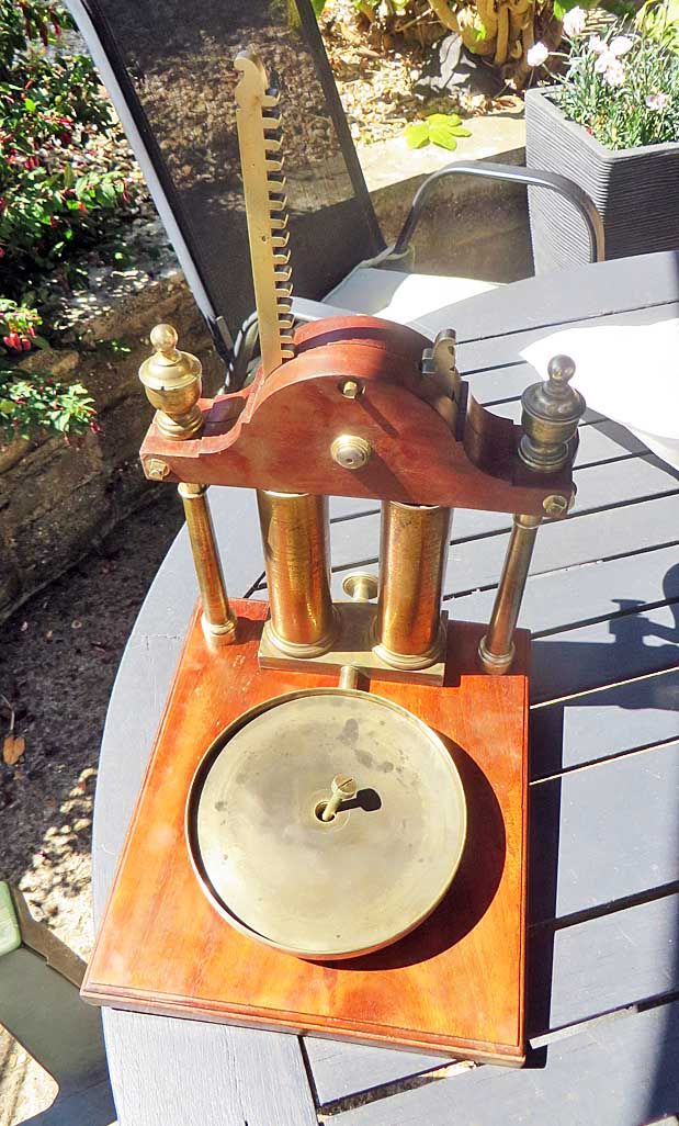

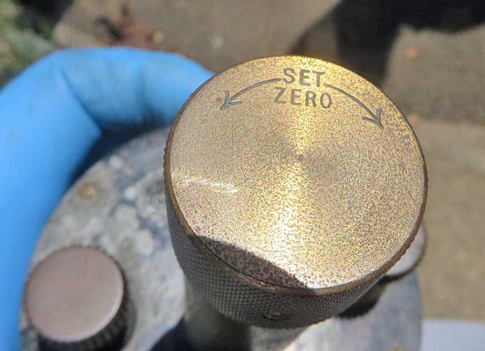

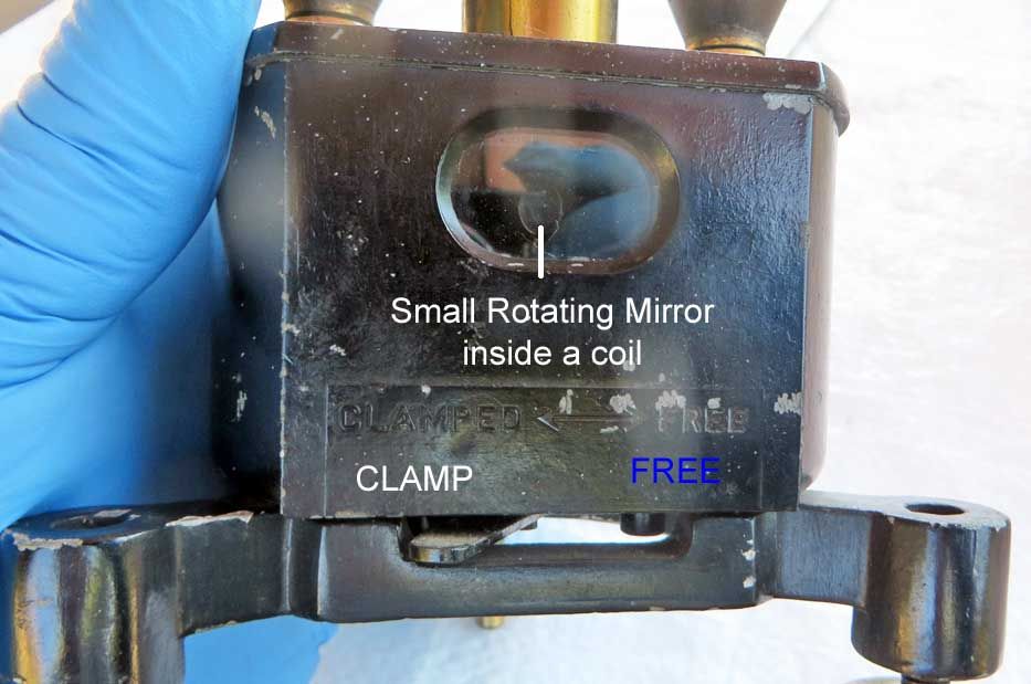

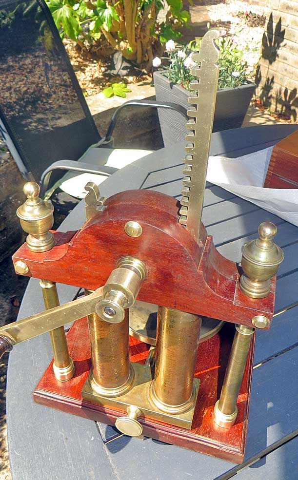

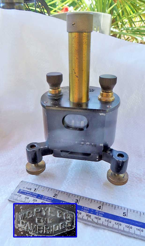

                          Hi all,
                          Here are two more mystery items from the weekends car boot haul, probably from a school physics lab, not sure what they are.
                          They appear to be incomplete but I do not know what is absent:
                          Any info would most welcome!
                          Cheers, Martin
                          #608945
                          DC31k
                            @dc31k
                            Last one is I think a moving coil galvanometer. Shine a light at the mirror and you can measure the angular deflection when a very small voltage is across the terminals. Connect it to a coil and plunge a magnet in and out.
                            #608946
                            peak4
                              @peak4
                              I'd agree with the galvanometer, and I think the second item is a vacuum pump missing its bell jar.
                              Similar to this one
                              https://www.bonhams.com/auctions/26661/lot/57/
                              I remember replying to this article on The BBC last year with some more detailed info, but I must have deleted the email now.
                              https://www.bbc.co.uk/news/science-environment-59562636
                              Bill
                              Edited By peak4 on 09/08/2022 19:14:26
                              #608947
                              Willem Kotze
                                @willemkotze19252
                                The last item is a galvanometer. Reflected light beam for indication amplification. Low friction. Google "Galvanometer".
                                Willie
                                #608948
                                Martin King 2
                                  @martinking2
                                  Hi Peak4
                                  If a vacuum pump would there have been a bell jar on the platform perhaps on a rubbers seal?
                                  Martin
                                  #608950
                                  peak4
                                    @peak4
                                    Posted by Martin King 2 on 09/08/2022 19:12:09:
                                    Hi Peak4
                                    Martin
                                    or maybe a grease/leather seal, I'm not sure.
                                    See my amended earlier reply too
                                    Also include Ballistic, in your Galvanometer searches.
                                    Bill
                                    Edited By peak4 on 09/08/2022 19:20:52
                                    #608965
                                    Bazyle
                                      @bazyle
                                      Melted wax was also used as a seal. Used for suffocating butterflies or introducing something to kill them in the more elaborate ones.
                                      #609112
                                        Agree bell-jar and vacuum pump. Nice find! I expect the pump seals are leather and will need to be replaced. Plastic might work. You can still buy bell-jars, try ebay etc.
                                        The glass bell was probably sealed with Vaseline rather than hot wax because wax was used for more permanent seals. The four experiments I remember showed:
                                        • air is necessary to transmit sound. (A clockwork bell gradually went quiet as the air was pumped out even though the clapper is seen to be still working).
                                        • air is necessary to combustion. (A lit candle goes out when the air is removed)
                                        • air is necessary to life. (A mouse dies when the air is pumped out.)
                                        • alcohol boils when the pressure is reduced even though the temperature doesn't change.
                                        #609675
                                        Martin King 2
                                          @martinking2
                                          Hi All.
                                          Many thanks for the info on these items.
                                          The vacuum pump is now on its way to a French Instrument collector after a huge amount of interest on EBay.
                                          Cheers, Martin
                                          #609689
                                          Martin Kyte
                                            @martinkyte99762
                                            I would have said that the last one was a ballistic galvonometer. The max angle of deflection being proportional to the total charge passed.
                                            regards Martin

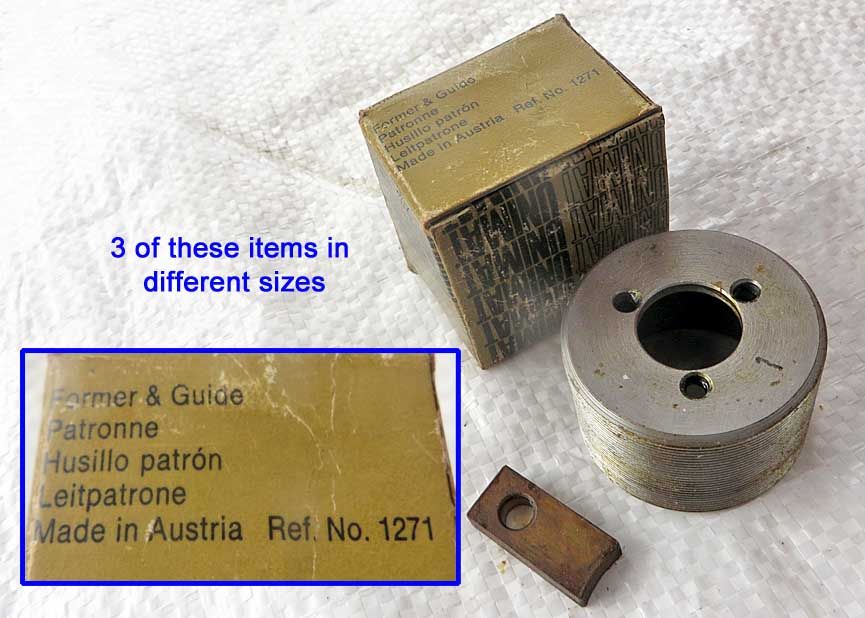

                                                Hi All,
                                                Yesterdays haul at Shepton Mallet included a stunning cased UNIMAT SL with power traverse and loads of accessories including three of these boxed components that I have never seen before, marked in different sizes?
                                                Small part is bronze with thread to the end.
                                                Any thoughts please?
                                                Cheers, Martin

                                                  mgnbuk
                                                    @mgnbuk
                                                    Part of the Unimat SL screwcutting kit – see this video
                                                    This video shows the kit being fitted from scratch.
                                                    Nigel B.
