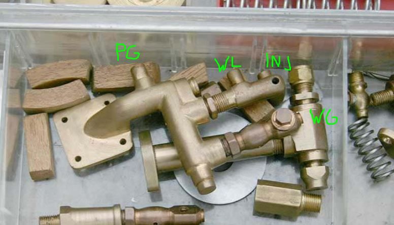

                  Bill, you must be looking at different engines to me. The first three on station road steam all have the water gauge, injector feed, water lifter feed and pressure gauge all off the same manifold as per the drawings.
                  Richard, at the end of the day it will be your boiler inspector who will have the final say so talk through any solution swith him before cutting metal.
                  #431245
                    This photo shows the manifold that fixes to a pad on the top of the boiler so all 4 items are off the manifold
                    One option may to enlarge the front left fixing hole and use a banjo type fitting and run a short length of pipe from that to the top of the water gauge. Though check clearance to gears.
