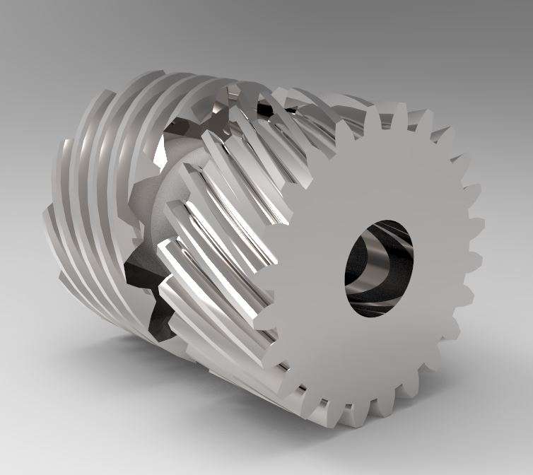

          I am fairly sure that ATOM has “scripts” where you will find one for spur gears, it is in my Pro version.
          There is also a more extensive add on that can be downloaded which was suggested to me by one of the Alibre “staff” who is a regular here when I wanted to do helical gears. This is the link to the latest version which was altered to give what I needed. It will do DP and MOD, external, internal, helical etc and you can then use other Atom features to modify the output such a the bore and a boss if needed.
          Edit, I just checked and it does not look like Atom has scripts so the gear generator in my link would be the best option, it produces quite nice gears
          gear pair

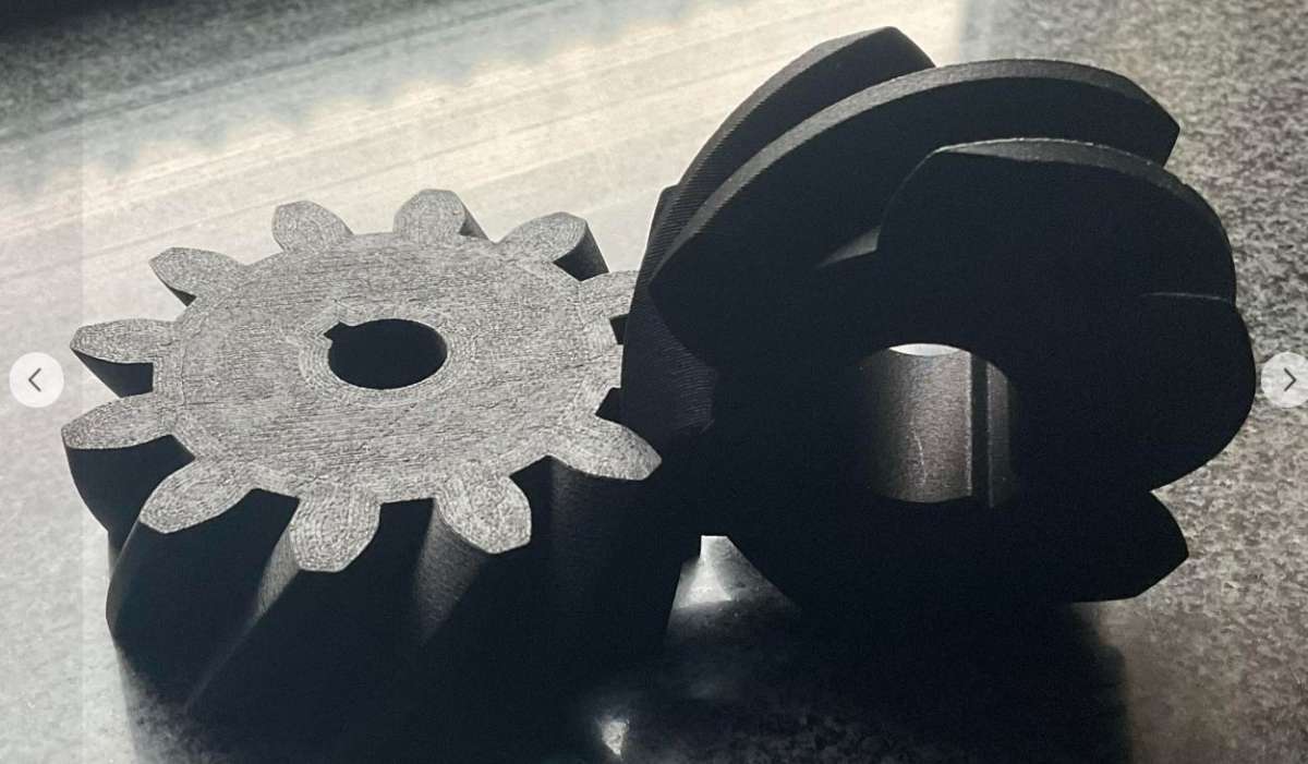

                These were done in Atom3D using the above mentioned utility thatI suggested someone install and printed in Carbon reinforced filament, solid fill with a Bamboo Labs printer. Keyways also easy to add at the drawing stage. They are for a full size fractional HP engine
                helical

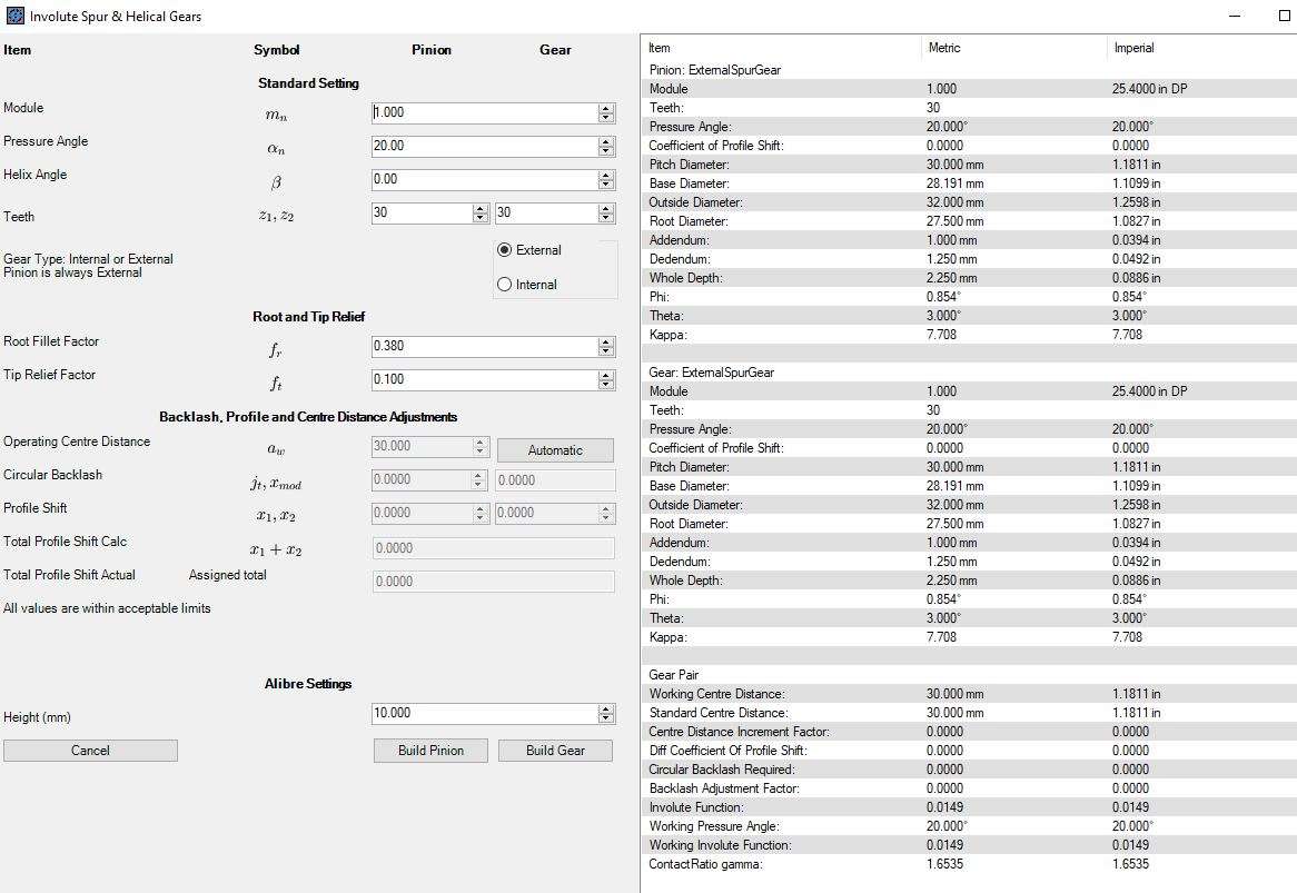

                  The utility is quite good as there are lots of things you can adjust, even if not 3D printing it can be used to get all the machining data such as depth of cut and OD. Also does Cycloidal for the clock makers as well as bevels, rack & pinio.
                  gear utility
