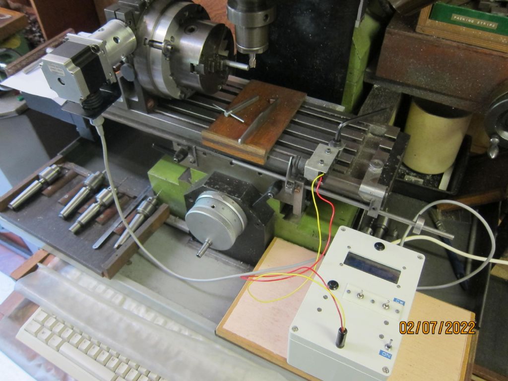

      I have made up the Carl Wilson's Arduino controlled indexer as described in MEW249 and have been using it for machining Hex bar stock on my 3-axis stepper motor controlled milling machine. So far, so good but I would like to be able to fit a microswitch on the X axis of the mill in order to auto advance the Arduino by the required 60 degrees in place of (or in parallel with) manual activation of the On-Off-On Mom switch provided by Carl. .Can anyone suggest how this might be done as early tests have not proved to be successful.

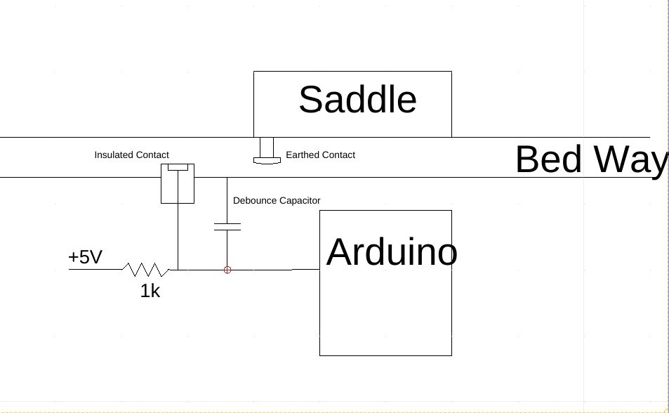

              Might be easier to make a wiper switch to fit on the lathe. I think it's easier to do off/on/off and have the Arduino invert the logic.
              A contact mounted on the saddle, which is earthed, passes over an insulated contact held at 5V via a resistor, causing a pin the Arduino to register logic 1,0,1:
              Main problem is likely to be debouncing and cleaning up the signal presented to the Arduino. Unfortunately, good earths by sparky electrician standards are often a heap of filth in telecommunications! Trouble is microcontrollers are switched by low voltages and react in microseconds. They easily detect that most mechanical switches don't make or break cleanly and bounce many times over tens of milliseconds. They also react to any other low level electrical noise present.
              Step one is to try the circuit without a debounce capacitor. If operation is unreliable, try adding a capacitor between 0.01 and 0.1 microfarads. It may be necessary to experiment. With luck the capacitor stores enough charge to fill short negative spikes so the Arduino never sees them, and also decouples any AC on the line to ground, but it's a mild bodge. More elaborate filtering and debouncing may be necessary.
              Mucky signals are the bane of microcontrollers. Might even be the reason why what's already been tried isn't working.

                  You should be able to just put a push putton or microswitch in parallel with the relevant side of the existing on-off-on toggle switch.
                  What problem do you have?
                  If it's random operation try using screened cable to connect the switch.
                  Robert G8RPI.

                    Have now been able to get the microswitch circuit working as required, Not sure what the original problem was as all that was required is to wire the microswitch across the On-Off-On Mom switch and bring it out to the front panel via a 3.5mm jack plug as seen in the photo. Net result is that the RT is now activated through 60 degrees at the end of each pass along the X-Dirn to complete the Hex cut
