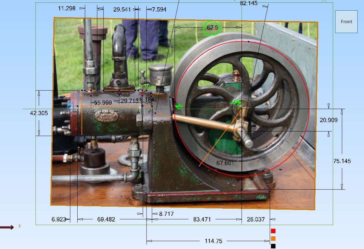

      Examining Jason’s examples and turning to the Manual I found how to trace from a photograph, but must have missed something.
      I wanted to ascertain dimensions and proportions from an image of the original. Given this for my steam-wagon engine, and it is prominent, I want it right to a reasonable degree, but have a sinking feeling I’ve been working under a gigantic scaling mistake for all the years since I started it.
      I thought if I use both an Alibre tracing and test measurements by rule they should co-incide closely enough to verify my original measurements made too many years ago.
      Once I worked out what I thought I was meant to do, I kept all scale controls to 1:1, and used mm to make the sums a bit simpler (so I thought). There is that calibration tool to refer the tracing to a known dimension but I could not see how to use it, or even if it works in Atom.
      First I found if I saved the image, admittedly a scan of a photocopy of a photo, in the proper .jpg format but in an Alibre drawings folder, the CAD software itself could not find it. I copied the file to the desktop and that made Atom happy.
      I put only the main outlines on the scan, and though the proportions all seem right the numbers are rhubarb!
      I now had a set of 2D outline sketches to queer dimensions, on one page. I extruded them a couple of mm to create a single 2D Alibre drawing. I typed the derived dimensions into a spreadsheet, hoped conversion and scaling are correct, based on the (physical) model’s actual width, and added the inch equivalents for the model as text notes alongside each one.
      Then found the miniature engine would be at least four inches too tall!

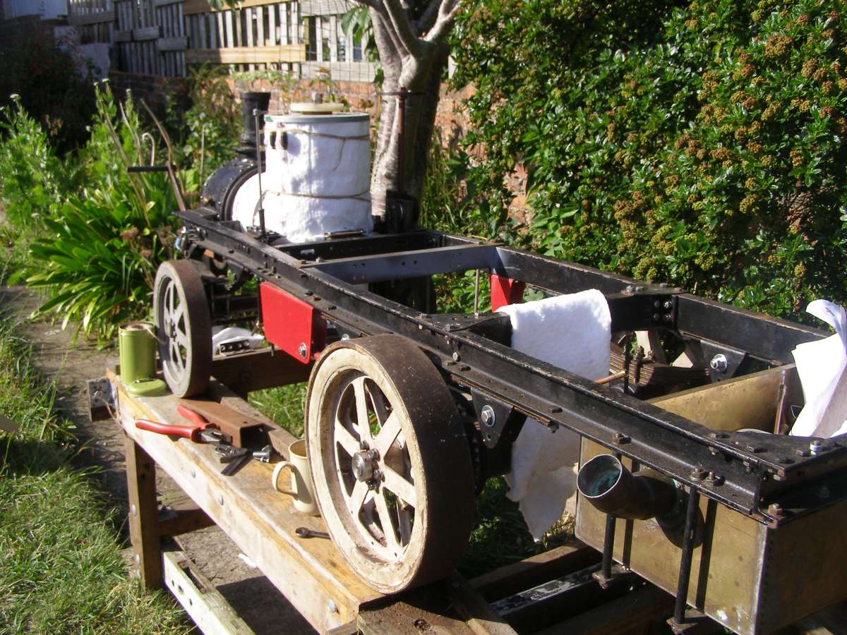

      2) The whole ruddy project, fighting against a complete first-attempt failure, decades of house moves, struggle to learn CAD hoping it would help me design a working model from a few tatty old photos, lots of re-made parts, phases of clinical depression when I nearly scrapped it, a heck of a lot of money and time, is seriously wrong!
      Effectively, this tracing has revealed I’ve built a 4″-scale chassis, wheels and superstructure around a boiler nearer 3″ scale size. So to make the engine so far drawn to fit as it should, means having significantly to change its external appearance, yet it is a very prominent part of the vehicle; part of the original Hindley wagon’s peculiar character.

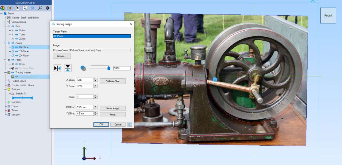

        When you put an image into Alibre to trace from there are two things to do with it.
        1. Scale to size.
        I do this first by starting a sketch on the same plane that I placed the image on and simply drawing a line to a known part often the flywheel diameter or in your case the base of (presumably) the engine and note it’s length which would be 499mm for your engine.
        Now you say your actual piece of engine that is already cut is 8″ or 203 (not 208) so from that I can tell my image is Larger than the actual model. Quick bit of maths to work out that 203 divided by 499 = 0.401.
        I now right click Trace image <1> down the left of the screen and select edit. From there I change the X & Y scale callibration from 1 to 0.401.
        Here I measured the flywheel radius first of all and then adjusted the image so to suit a 125mm dia flywheel and then could just sketch a series of lines to get the relative size of other parts
        t1
        2. Position
        Not something that has to be done but I will then use the X & Y Offset to position the Alibre Axis lines somewhere convinient say with them crossing at the crankshaft axis or if looking at the front of your engine plat ethe vertical would be down themiddle. This makes it easier to take measuerments from those axis.
        So with things the right size and in the right place start a sketch on the same plane that the image axis is on and every line or circle you draw will be to actual size so that any part placed over the sketch will fit. You can then just draw at 1:1 knowing the part will print at actual size assuming you have your printer correctly setup.
        Here I have also moved the X & Y to cross on the crankshaft axis
        t2
        There are two other things to watch out for, Alibre won’t correct perspective if the image is not square on and if your image has become stretched or squashed you may need to check the scale both horizontally and vertically and enter separate scaling correction for both.

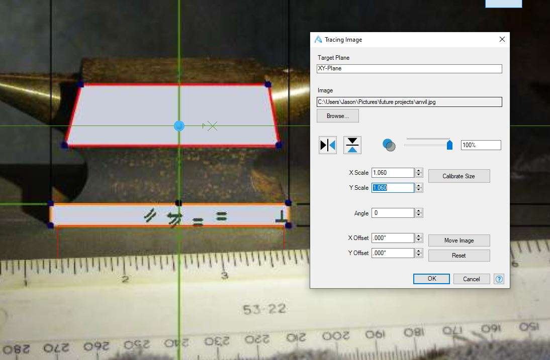

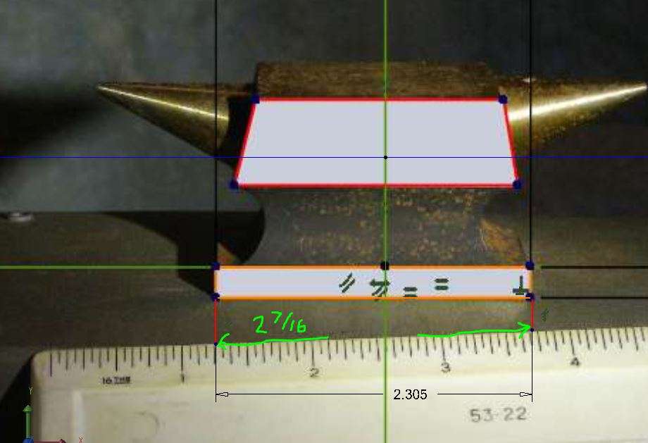

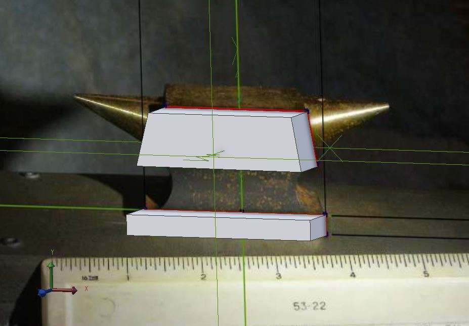

                I’ve just tried again with something much simpler, a Jeweller’s Anvil. I no longer have it, as I gave it to a friend whose hobbies include silver-smithing. So I can’t measure it but the rule gives a near-enough idea for this test.
                I found how to use that calibration tool, but still ended up with strange results shown below, though at least this time I could produce a print that matches the length and height Alibre thought are right; both in physical image and the stated dimensions.
                So tried again, typing into the calibration the length judged by eye from the rule,  but this time leaving the scale values as Alibre thinks.
                I didn’t take it as far as a drawing but at least the tracing dimension, just the length of the anvil’s foot, now closely matched the judged length.
                This was with the length calibrated but also the scale set to 1:1 –

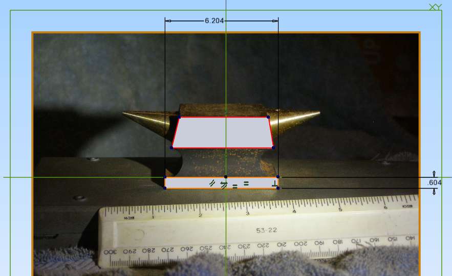

                  You need to work out the ratio between what a line drawn in Alibre shows it’s length to be and the actual measurement, in this case what the rule shows.
                  t3
                  I read the rule a 2 7/16″ and my import of your image the Alibre sketched line is 2.305″ so I need to slightly increase the image therefore 2.4375/2.305 say 1.06 so that is what you enter in teh scale boxes

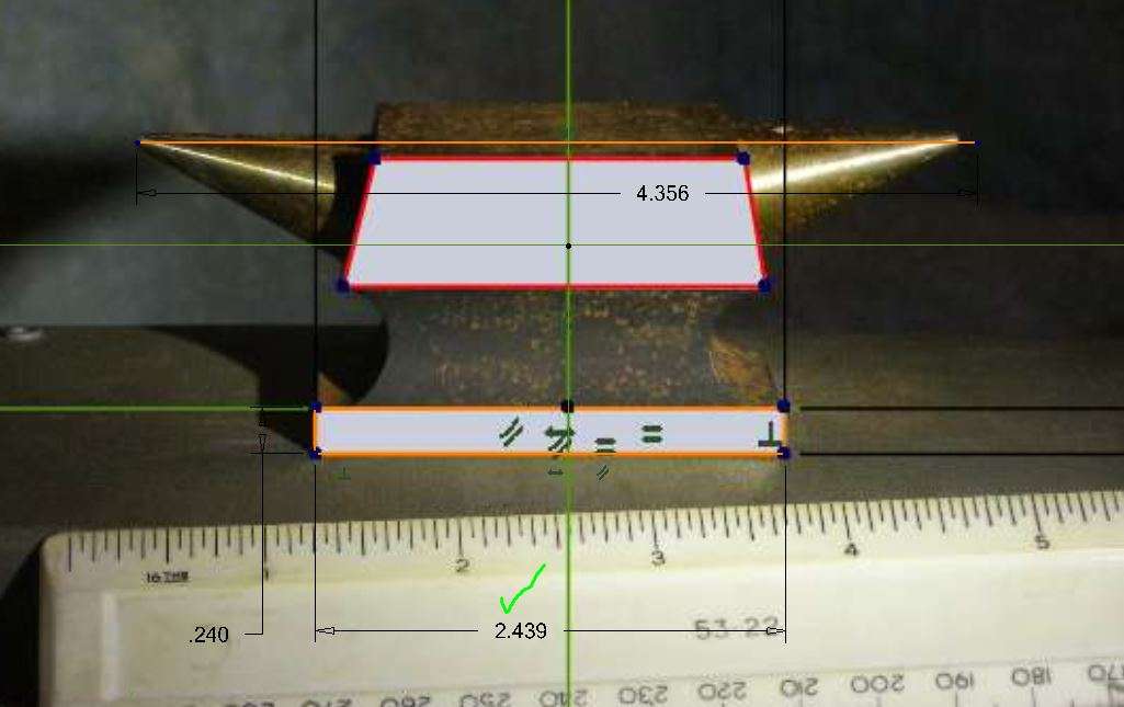

                  t4
                  Having now scaled the image if I go back and draw a line again this time instead of being 2.305 long it is 2.439 by eye and I could adjust it further by giving it an actual length.
                  t5
                  Closed the sketch and extruded it a nominal 1″ about mid point

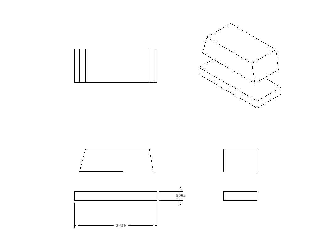

                  t6
                  Produce a drawing for it, alibre defaulted to 1:1 scale and added a couple of dimensions Alibre giving the lengths to the lines I clicked

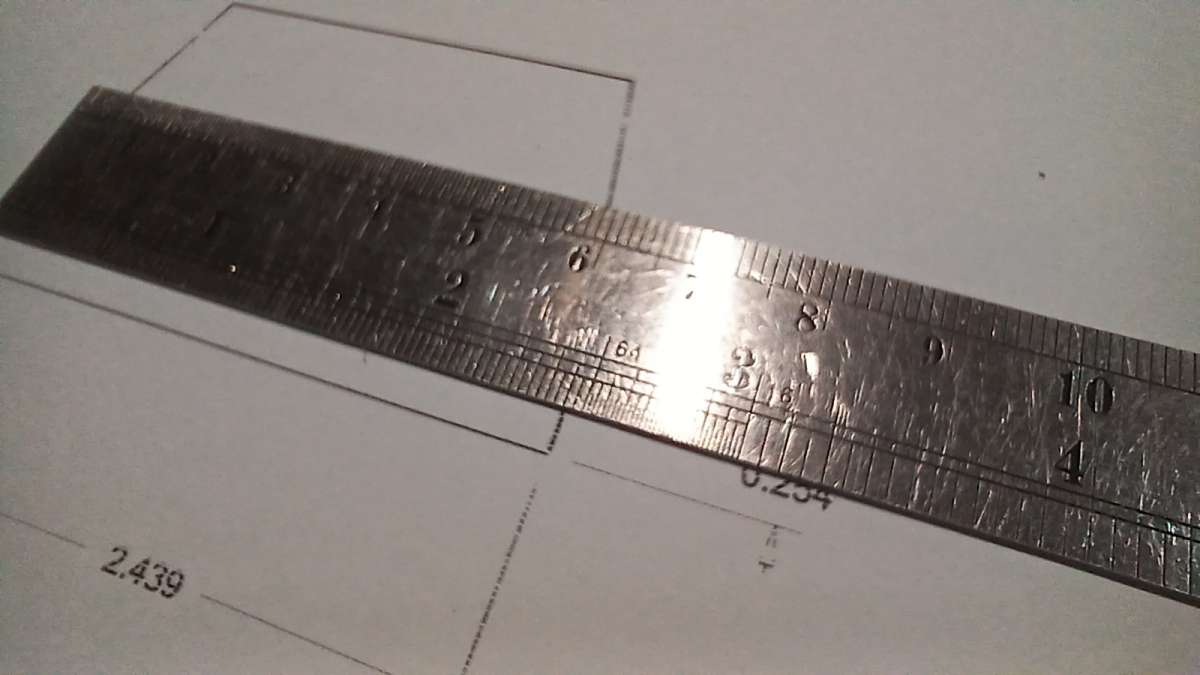

                  t7
                  Then printed it out and put a rule against it, 2 7/16″

                    I’ve just closed another attempt at the original engine scan. Although I managed to calibrate it, it produced so many invisble, untraceable so unrepairable “sketch errors” I had to abandon it.
                    The error table says it can help you find them… it might if could highlight where. It merely names their types.
                    I can only think this was because it was three separate rectangles instead of a single polygon or nested ones, but it seemed to accept more than that yesterday.
                    I’ll have to scale the photo manually. By sheer chance it is pretty well exactly 10mm of photocopy = 1 inch of physical steelwork; and square-on enough for no significant foreshortening and perspective.

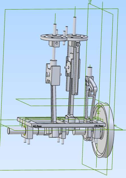

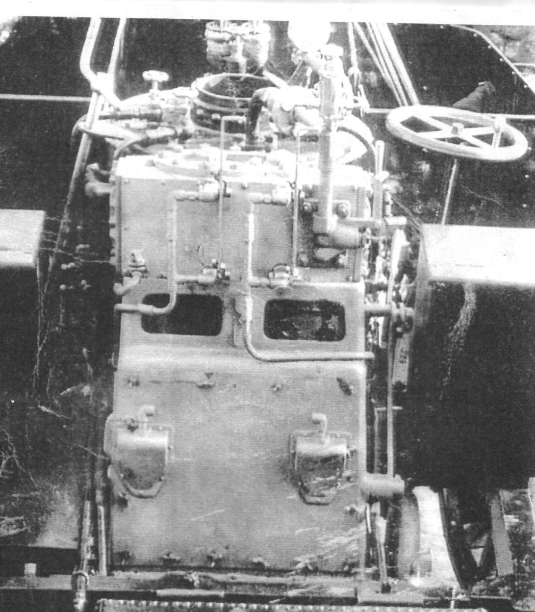

                                      Below the scan of the relevant area of the photo, is the CAD assembly of the model engine so far – taking many evenings and frustrations to create. The finished engine will be 16″ high from sump floor to cylinder top, same height as the boiler, which protrudes just over 8″ above the chassis.
                                      The scan shows the back of the engine, nearly but not quite vertical. The boiler top immediately beyond it is slightly below the engine top, but using the engine as I have partly made it so it matches this photo, will create a massive four-inch discrepancy on the miniature.
                                      My measurements of the old photos had suggested the full-size boiler and engine tops were about two feet above the chassis. This scan, one or two photos showing the vehicle with its driver, and experimenting with a tape-measure while I sat on an ordinary chair, shows my boiler, the bunkers and perhaps crew seats are to the wrong heights.
                                      To place the engine correctly, but as I’ve drawn and part-made it, sinks it to those little protruding covers, so all out of proportion. It also means the entire rear cover, with its little protrusions and large wing-nuts, would not be “quickly detachable” to quote the builder’s catalogue. The cross-member would be in the way.
