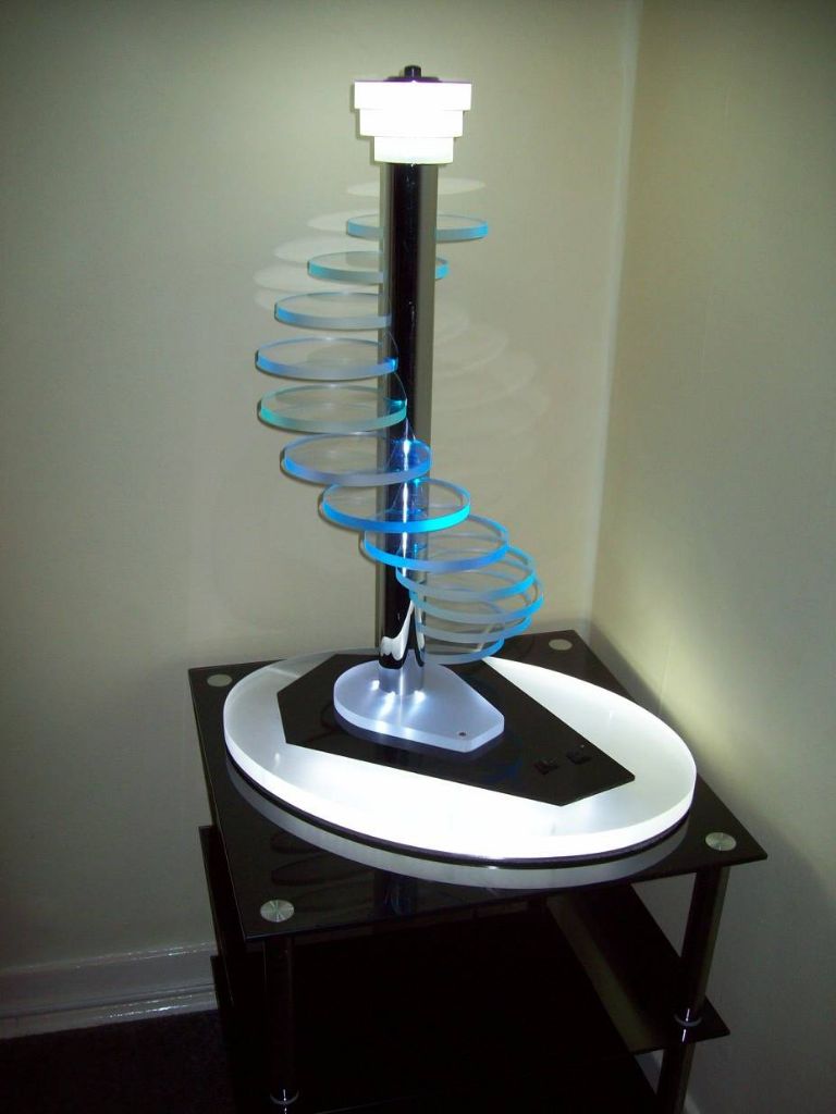

      Making a lamp with a difference, from scrap.
      #549453
      magpie
        @magpie

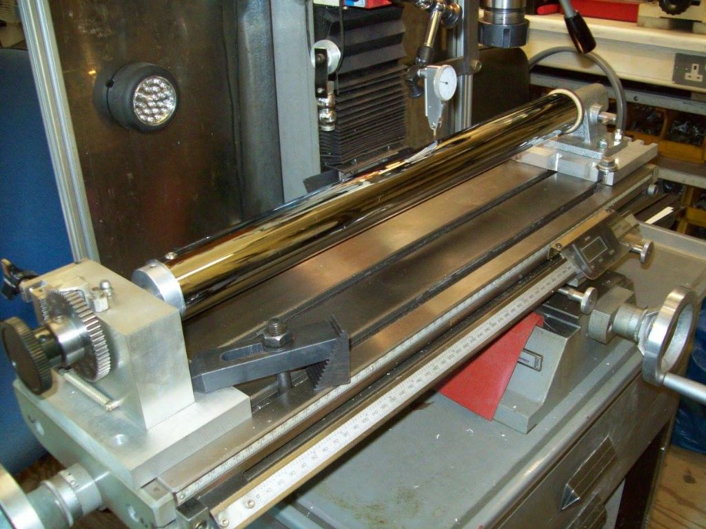

        Start with a length of chrome plated brass tube removed from a very expensive free standing bath tap. As the thread title suggests, a scrap one, and set it up on the mill using my little home made indexing unit. I have a Vertex dividing head, but that was too big to use for this job. More to follow. 22712368_1825059721118970_1449712812345406436_o.jpg

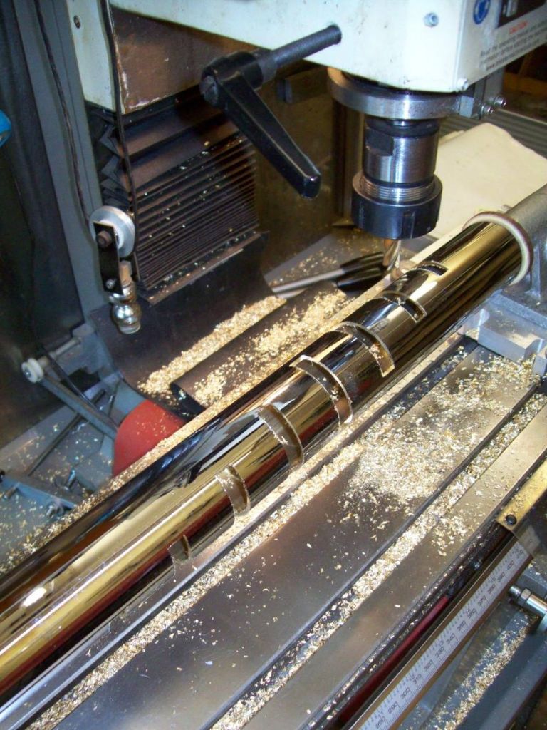

          Next step is to mill some slots in the tube. 22553341_1825061194452156_2577167779378465714_o.jpg

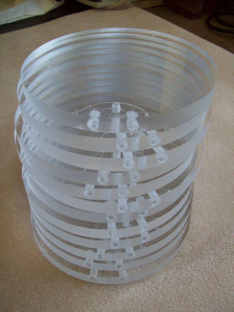

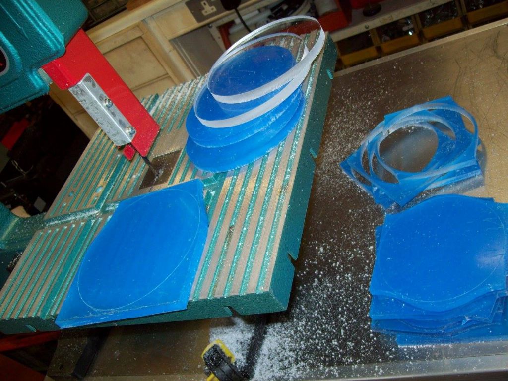

            Take some scrap 'Perspex'. My mate owns the local scrapyard, and they get some great stuff in there at times.
            Mark out and cut some discs to roughly the right size on the bandsaw.22552906_1825061581118784_7801105805431452084_o.jpg
            #549457
            magpie
              @magpie

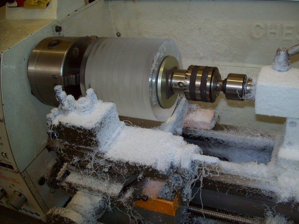

              Next, do a bit of pressure turning. I held the discs together with double sided tape and wedged them in the lathe using a rotating chuck in the tailstock.22770694_1825061971118745_6556671432606863506_o.jpg

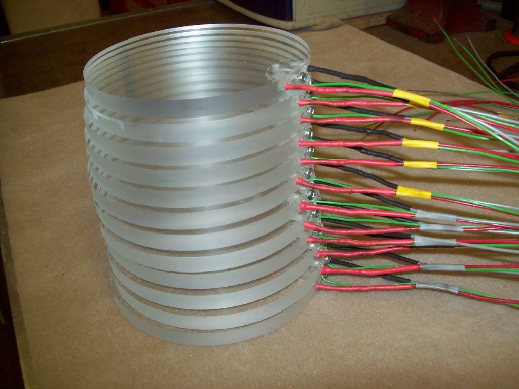

                @magpie
                Drill the discs for the LEDs and tap out a hole for a fixing screw. 22550556_1825065124451763_8466399254925648497_o.jpg
                #549461
                magpie
                  @magpie
                  Then fit the LEDs into the discs.22555641_1825065437785065_7180001951381113353_o.jpg

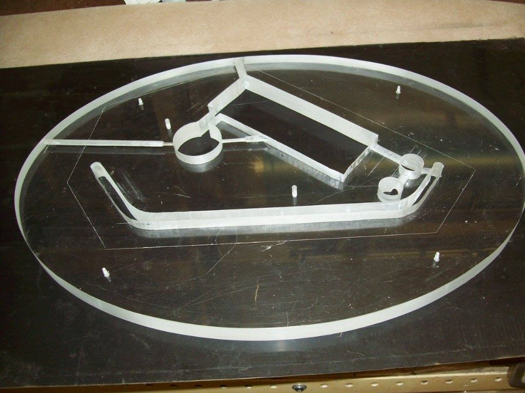

                    @magpie
                    Time to cut the base from 3/4" 'Perspex' and cut the holes for LED driver, switches Etc. 22770563_1825062797785329_3251310117460441620_o.jpg

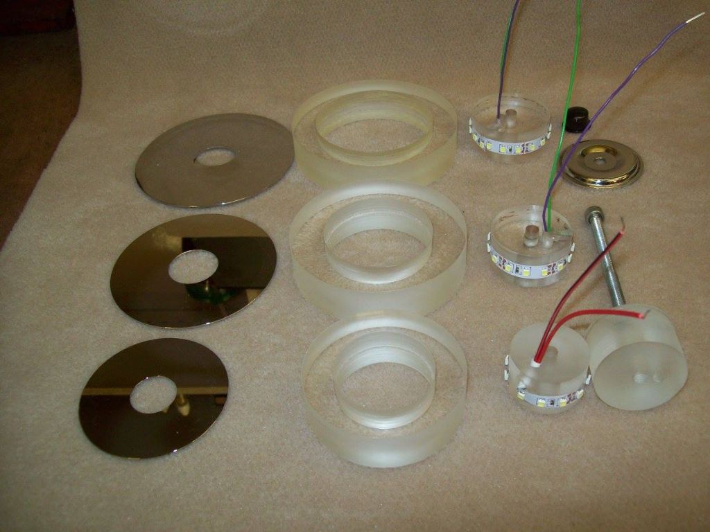

                      @magpie
                      22553209_1825064691118473_2360047594932752677_o.jpgWith the base ready it's time to make some bits for the top. 3/4" 'Perspex' and some discs from hard drives. 22712354_1825064297785179_1041913367405548438_o.jpg

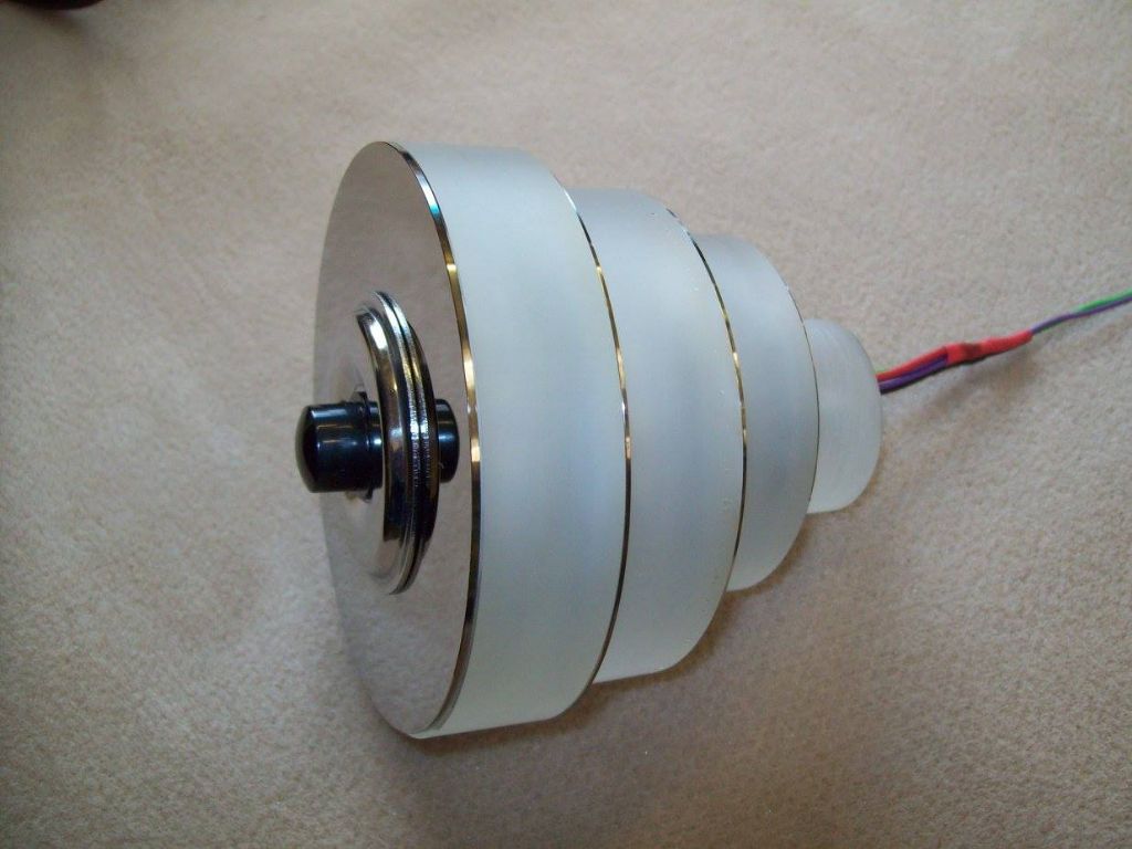

                        @magpie
                        Put them all together and you have a lamp that can have either white discs or colour changing discs. The base and top are white at all times, only the discs change colour. I would post a Video of the finished item but don't know how.22553327_1825066871118255_6557936237153088466_o.jpg
