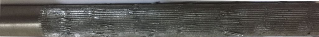

        I normally get along OK with knurling, either scissor or bump, but have never needed to produce a knurl longer than about 1.5 times the width of the knurling wheel.
        However, in off-forum discussions with another member, the possibility of making continuously knurled bar came up. This is my first (disastrous) attempt:
        It's obviously horrible in many ways, but I'm not ready to throw in the towel yet. I have some ideas myself but would be interested to hear any suggestions for improvement. Bar spending £100's on a fancy cut-knurling tool of course!
        Some data:
        – 1/2" EN3B.
        – Cheap and floppy scissor tool with good quality 3/4" diameter x 1/4" width 75 tooth wheels.
        – Full depth wound in at start of cut, lathe running at 65rpm, power feed from right to left in the picture at a tedious 0.01mm/rev.
        – The periodicity, most evident near the head stock end, is about 1.5 – 2 times the wheel width.
        Some of the problems I think I can address but at the moment I don't understand the mechanism behind the tearing of the ridges which results in them becoming whiskers pointing against the direction of tool travel. So that may a place to start understanding what's going on. Or maybe not.
        Any advice/discussion would be welcome.
        Robin.

                You may be going in too deep, first the wheels settle into a pattern that fits around the work and then as they dig in deeper there is only room for 1 less "ridge" so it gets sheered off, think of a gear as you reduce OD you reduce the number of teeth. Also like a gear there is some of the knurl above the PCD and some below so the actual depth below stock diameter is not the depth of the wheels teeth due to metal geting pushed up.
                Some form of tapping/cutting fluid will help as does using a small wire brush to remove swarf

                                  The swarf produced when attempting a long straight knurl is mostly due to the knurl teeth not being an involute or, for that matter, any other recognised efficient gear tooth pattern.
                                  Besides deformation of the workpiece displacing material to form the 'umps and 'ollows of the knurl the actual shape of the spaces will be scraped to give enough space for free rotation of the knurl. As the knurl depth changes so does the shape. Hence the formation of swarf as the knurl deepens.
                                  With the normal cross pattern the effect is masked because one normally never feeds the knurls to full depth so there is a bit of clearance in the equivalent of a gullet between the knurl teeth that the pyramids making up the knurl can deform into. The general insensitivity of knurls of reasonable pitch on work of mutually reasonable diameter is due to the material being shifted up or down during the process so that the final "pitch diameter" permits an integer number of knurls around a diameter at half knurl height.
                                  But there must still be a little space in the knurl gullet above the peak. Force the knurl deep enough to more than eliminate that clearance and plenty of thin, needle like, swarf results.
                                  Clive

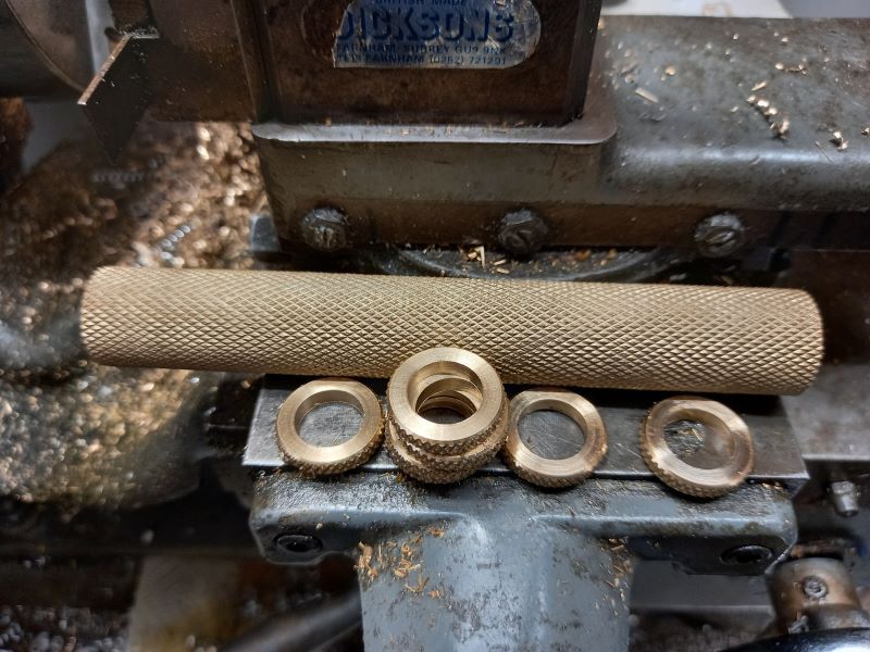

                                            Hi Robin, I started knurling a long piece of 3/4 inch brass and it did just like this example. This is a new to me knurling tool I used, so just loaded more pressure on and forced it to cut deeper, then it started to cut better. If you carefully on the bar left over, you can see the double cut marks. I did another piece and used the same depth setting that I had with the scissor type knurling tool and all worked like it should have. Iam making some knurled locking rings.

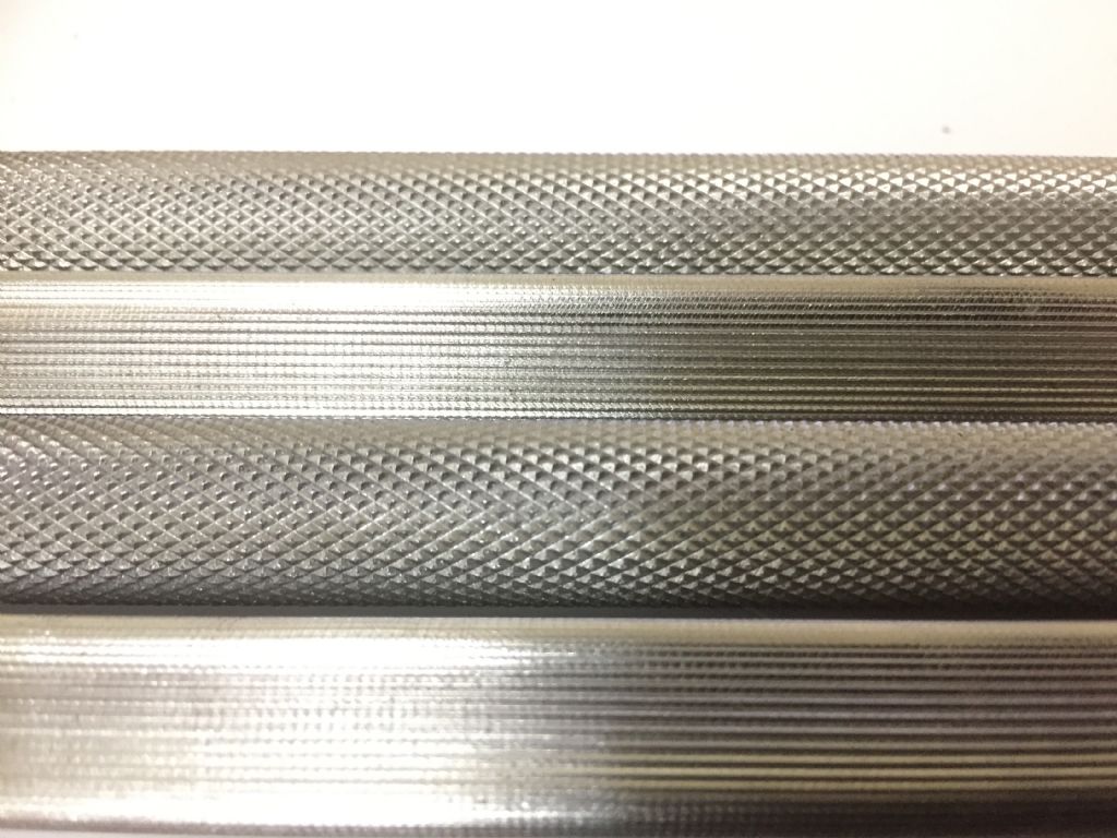

                                              A (possibly final) update on progress with this.
                                              First, thanks for your contribution Neil and apologies for not responding. This project started because a fellow forum member was looking for continuous knurled bar to slice up in much the same way as you have done.Your work looks enviably good.
                                              After some experimentation I managed to make this (at least sort-of) work with the cheapo floppy scissor tool:
                                              Those are details of 250mm lengths.
                                              The pictures are not flattering to either my machining or photography skills – the bars look better in real life – but they do show that the diamond knurls are reasonably crisp and even, and the straight ones are – well, at least straight. And not ragged as in the in photo in my opening post.
                                              I think the main reasons for the improvement were using flood coolant (there were visible amounts of swarf carried away) and not attempting full depth in a single pass. I ended up putting 'a bit of a cut' on at the tailstock end at 200rpm, traversing to the headstock at 0.2mm/rev, then putting 'a bit more cut' on on and reversing to the tailstock. Quite possibly I could have gone faster, but it was working and I'm not on piecework.
                                              The devil in the detail is 'a bit of a cut' perhaps – I don't know what that means, and neither do you .Just what felt right after many trials. Which isn't helpful!
                                              Anyhow, thanks to all for advice.
                                              One day I shall make a Marlco type tool perhaps and see how that goes. I do like a crisp knurl I have to admit.
                                              Robin.

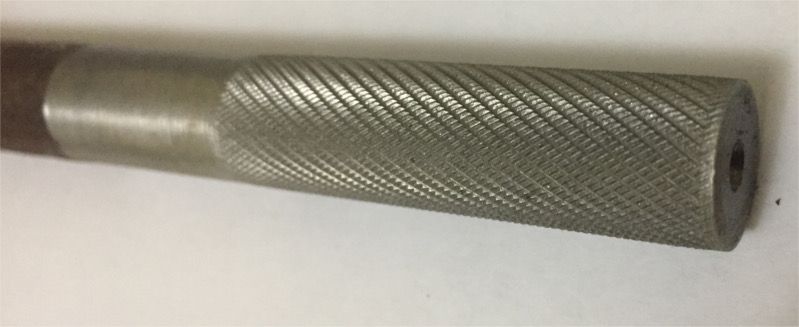

                                                  Hi, I explained my findings of scissor type knurling tools with sideways slop in this Knurling Tool and this photo shows some of the pit falls with them.
                                                  You can see on the left of the pattern where the top knurl has been skewed to the left and the bottom one to the right and this is just a static knurling.
                                                  Regards Nick.
