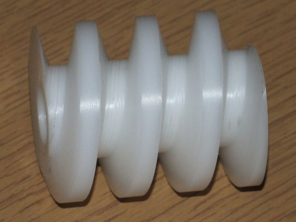

      The drawings call for a 2 start worm with a pitch of 1/2" and an OD of 1.48", plus a quoted lead angle. There is no detail about the thread form, depth or anything else, and the lead angle quoted is wrong. The thread form is diagrammatically shown as Acme, which seems reasonable. My lathe will cut 2tpi, but not the 1tpi as required for the two starts. That left me with two choices for cutting the worm. One, use the vertical mill and a series of ever smaller cutters while driving the dividing head from the table to get the helix. Two, use the vertical head on the horizontal mill with an involute style cutter to cut the thread in one pass, again driving the dividing head from the table. I don't have the requisite 'involute' cutter, so step by step it is. In which case I might as well do it on the CNC mill, as it's less effort. My CAM program can only do 4th axis toolpaths parallel to the rotary axis, or round and round it. Neither is satisfactory; the ideal would be to follow the helix of the worm. So I hand wrote my own G-code, which turned out to be quite simple, just a series of G01 moves with arguments in X and A. At this juncture it was pointed out that a 2-start worm is wrong, as the front wheels will back drive the worm gear assembly. sad So I re-designed the worm as a single start. I could have cut this on the lathe, but since I was so advanced with the G-code I decided to stick with the CNC mill. I won't go into the details of the thread form, but I did change the included angle of the Acme form to 30°, rather than the more common 29°, as I could buy a 30° tapered endmill. The basic code and methodology seems to work well, the next task is to cut the worms in steel, rather than plastic like this:
      I'll also get the hand correct, the worm is supposed to be RH, but the plastic demo is LH.

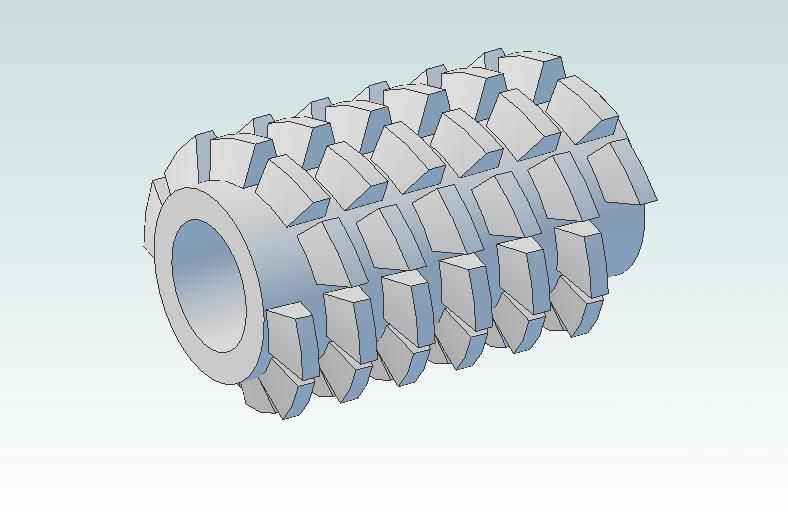

      For the worm wheel the drawings show what is essentially a helical gear. Since the pitch of the worm is rational the DP of the mating worm wheel is irrational, so involute cutters will not be available. Furthermore I wanted a single enveloping worm wheel, not a helical gear. The obvious way to make this is by free hobbing, ie, the hob drives the worm gear as it is cut. I've spent a lot of time looking at hob design and drawing various styles of hob, like this:
      However, I've decided that it is just too involved to make a hob with the proper form relief. I also looked at machining the worm wheel direct on the CNC mill. However, the tooth form required is very complex, and I miserably failed to draw even a rough approximation. So back to free hobbing it is. For the hob I am going to essentially machine a worm in silver steel, which can be gashed to provide some measure of relief, and then hardened and tempered. I intend to add extensions to the hob so that one end will fit into a Clarkson Autolock chuck and the other end can be supported by a centre.

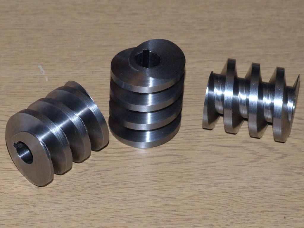

                  Here are two worms I've made in steel this evening, RH this time:
                  I'm not at all happy with them. sad It's all down to feedrates. I used three cutters; 6mm carbide at 4000rpm and feedrate of 420mm/min, 3mm carbide at 5000rpm and feedrate of 320mm/min and a HSS taper end mill at 1500rpm and 120mm/min. I thought that the rotary table didn't seem to be slowing down much on the slower feedrates. In fact it wasn't, I think it was flat out all the time. I'm amazed I haven't badgered at least one of the cutters.
                  Clearly I haven't got to grips with linear/rotary combined feedrates. I understand that if a linear motion and rotary motion are combined in G01 then the feedrate is taken as an 'unwrapped' linear rate, according to a rotation diameter correction factor. Here is where it all gets murky. Both the Mach3 and my mill manual talk about a rotation axis diameter correction, but on the screen it is shown as a radius correction. And does the computation take into account the number of turns the rotary axis makes? I set 16, thinking 16mm radius, but who knows how it is interpreted.

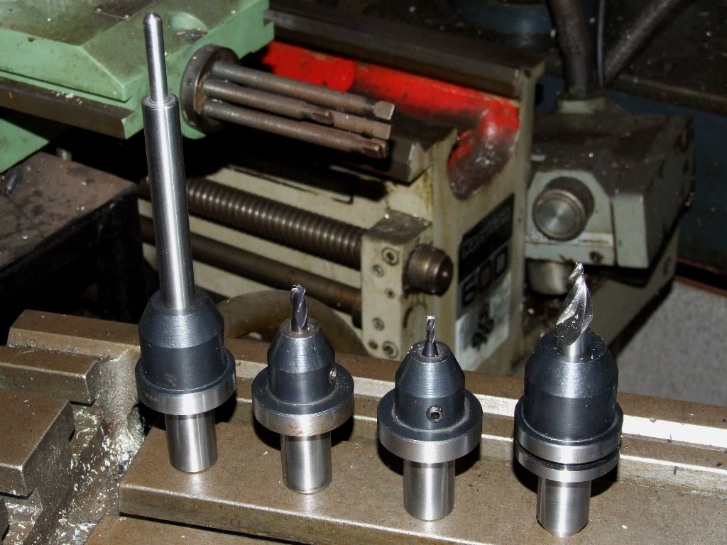

                                Anonymous

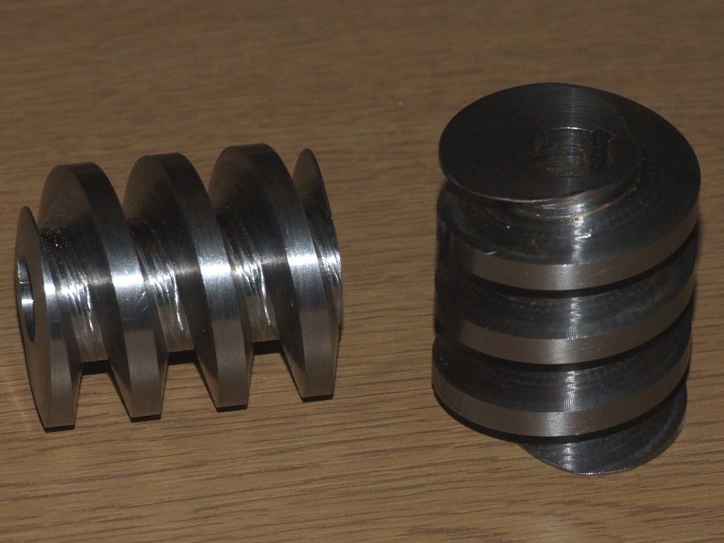

                                  The final worms are made! Like a lot of operations, once everything is sorted out the actual machining is a bit of an anti-climax. However, it is strangely mesmeric to watch the rotary table turn and a helix magically appear in the blank. Here are the tools used; from left to right, the master tool used to set zero and relative tool lengths, a 6mm cutter for initial roughing, a 3mm cutter for deeper roughing and a 30° included taper end mill for finishing:

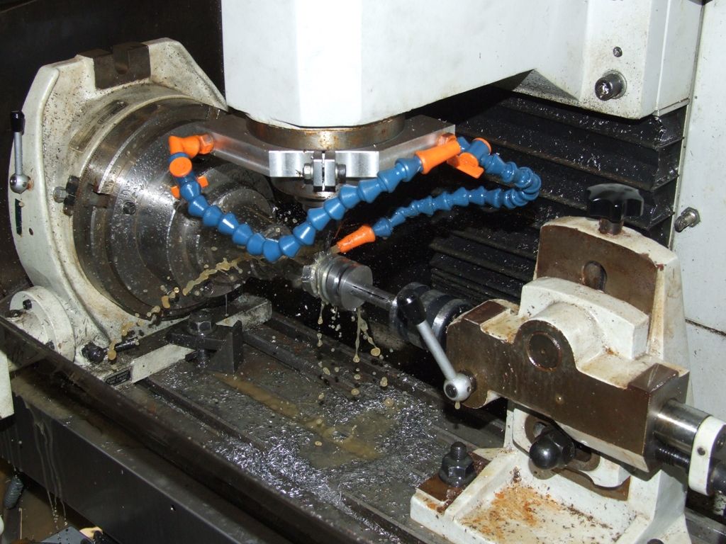

                                  The general set up:
                                  And the final worms:
                                  Why three worms? Because I'm making two engines, but I made three blanks just in case of a boo-boo in the machining.
                                  Regards,
                                  Andrew

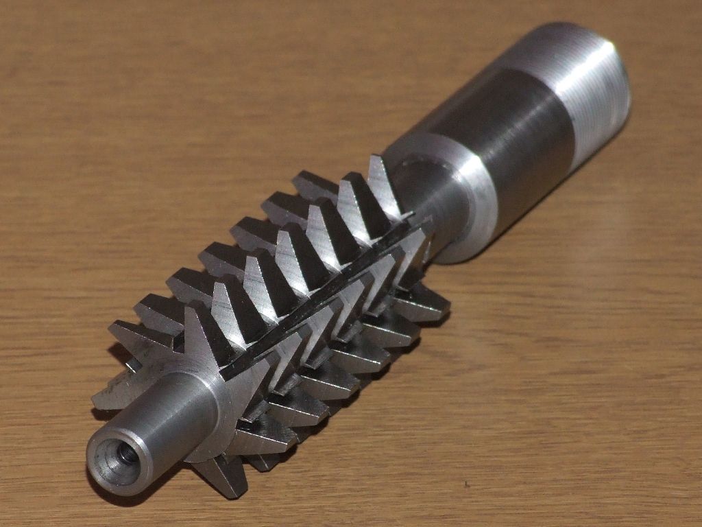

                                          #131869
                                          Anonymous
                                            The hob is now gashed. I settled on 7 teeth, so there is no common factor between the number of teeth on the hob and in the worm gear (22 teeth). Given the width of the worm gear blank it also ensures that each following tooth always engages with the gear blank before the preceding tooth exits the gear blank. Having said that, the teeth look a little weak to me; time will tell!
                                            Some work with a file is needed to clean up the teeth, and add some relief, before hardening.

                                            #131947
                                            Sub Mandrel
                                              @submandrel
                                              > no common factor
                                              Aside from a popular approximation for PI
                                              I always think it's a shame to harden cutters when they look as nice as that! I did worry about insufficient engagement to rotate the blank, but as you say you will have multiple teeth engaged you should be OK as long as you gash the blank deeply enough (I failed to do this once and hobbed a 61-tooth gear for a dividing head).
                                              Edit: thinking about it when the hob first contacts the blank, it's 'natural pitch' will want to cut two extra teeth at the OD than it will cut when advanced to the PCD. Perhaps a way around this is to have the hob fully advanced from the start and make the cut from the side of the blank rather than in from the edge. That way the hob's PCD will remain constant at the required value. Does that make sense?

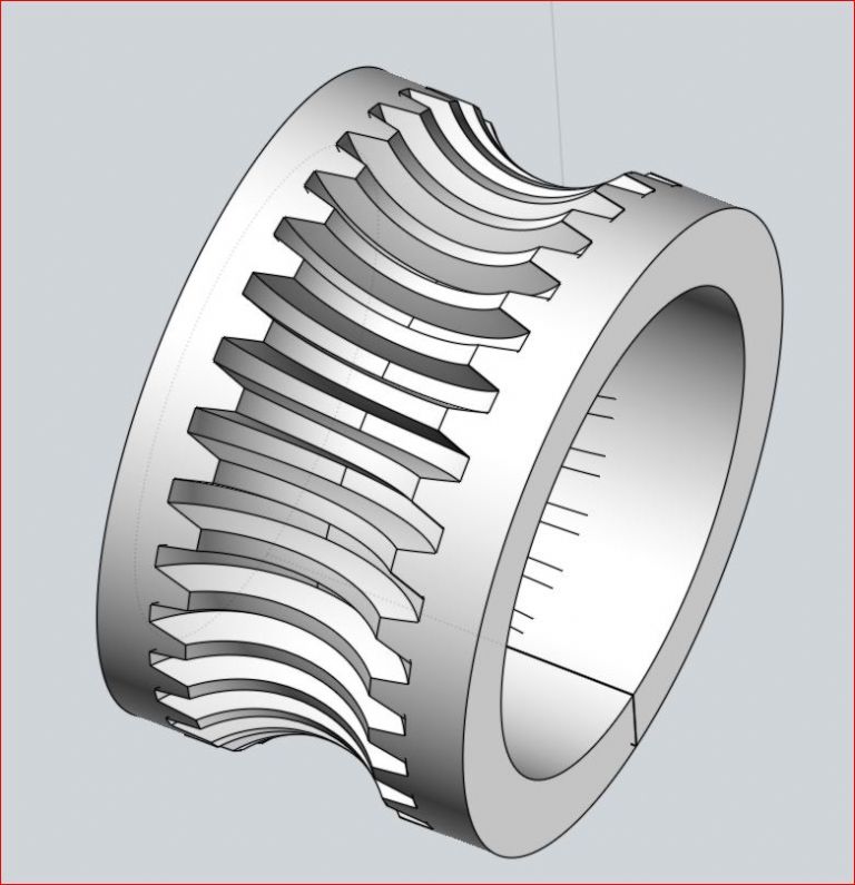

                                                    Andrew, following Martins picture I thought I would see how hard it was to draw in SolidWorks, it turns out it was quite easy – simply draw the wheel blank, sweep cut the rack form along a suitable helix and then copy the cut around the wheel.
                                                    Mark
                                                    PS. This is drawn at arround the scale you need – 20 t 1/2" pitchworm wheel.jpg

                                                      Andrew, is there a simple explanation of why this rational irrational aspect is so?
                                                      Mark, you make that drawing sound so easy. Either you or the program is very impressive.
