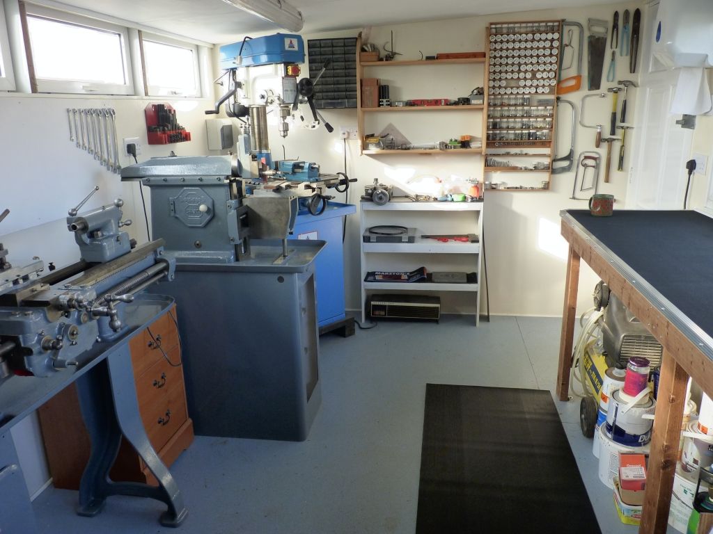

      Hello All,
      My workshop has a concrete floor which I have painted with proprietary floor paint. I put about 3 coats on it. Or rather my Son did, while I watched him as I drank tea and ate biscuits. It is a very good floorcovering, and served me well in my old workshop before I moved house.
      However…I am now looking at something like this:-
      Clickable link.
      https://www.findmeafloor.co.uk/product/699/r-tek-interlocking-garage-floor-tile-chequered-colours?gclid=CMS58srr_8UCFafJtAods3wADg
      a) As it looks nice
      b) Because I can
      Does anyone have any experience with this stuff, or similar? Is it worth me bothering with it? Or is it more trouble than it is worth?
      Carl.

          It does look nice but two things spring to mind.
          A) it's probably a bit more difficult to keep clean than a painted floor.
          B) unless your floor is perfectly flat some of the edges of the tiles may stick up a bit?
          Best advice is to try and find someone who's actually laid and has been using this system for a while.

            Hi
            My originally painted my workshop floor, after a few years some areas were badly worn and getting very dusty.
            I covered the entire floor with this vinyl flooring. Mine is a hard vinyl as opposed to a foam vinyl also advertised. It's not solid, the underside has a honeycomb hollow pattern,
            My Elliott Junior mill stands on this without any problem, just some 3/4" ply to spread the load. It cleans very easily and so far, (3 years) is not showing much sign of wear.
            There are circular and chequer patterns as well.
            I am very happy with it and would use it again, it's not much trouble to lay other than having to move workshop stuff around to clear floor space.
            Usual disclaimer – no connection with the advertiser linked above.

                    Hi Carl
                    Interlocking plastic tiles look great and are nice to walk on. however how will they stand up to metal swarf? I have yet to find a pair of shoes that are immune to it, the stuff always imbeds itself into the soles…. leather rubber or plastic it does not matter. Unless the tiles are rated by the manufacturer to resist penetration by swarf I would stay clear. I am not sure how it would stand up to heavy machinery also? Or do you have to cut around the heavy stuff.
                    My floor is painted with 2 pack and it has stood up well except in front of the lathe and mill, the chips have cut through the finish now but it has stood up for almost a decade.
                    When I do refinish it I will be using a heavy coat of epoxy. There are many brands and types available.

                      Hello Carl,
                      I installed some dense foam interlocking tlies which are about 1/2 inch thick, Axminster sold them at the time ~15 years ago..They form a central strip up between benches.
                      Today there are used in kindergarttens in bright colours—mine are matt black with swarf highlights, but they are comfortable and warm to stand on for long periods. They provide a degree of cushioning for things that fall off the workbench. I have been very pleased with them. They do provide useful crevices for the small object Gremlins to hide and conceal things, but then so does a jungle of swarf.

                                  Bear in mind that these comments are based on a working workshop floor under heavy use. Chips coming off my lathe are very hot and there are large amounts of them.
                                  I started off with conveyor belting scrounged from a local quarry, used but because it's used it has a saucer shape to it and in one run it's not bad but putting two together means the edges often lift causing trip hazards. I just had single runs. Wears well, nothing sticks to it very hard but very heavy if you want to lift to clean.
                                  At one point I tried the foam mats, they lasted a day. Chips just burn their way thru them or part way and leve sharp edges exposed.
                                  Then went onto the rolls of rubber matting 3mm thick, this comes in either checker plate pattern or buttons. I chose buttons as I thought it would be easier to sweep. When new it was fine and very pleased with it but over a three year period it gradually swelled and bubbled up then started to split and it was a serious trip hazard.
                                  Having said that this is 3 years in a very busy full time shop which would equate to 10 years ? in a home shop.
                                  I was ready to replace it with the same or 5mm if I could find it when I discovered the horse mats made from rubber crumb. Bought one to try in front of the lathe which is the worst wear area in the shop. Came off Ebay and in my case 10' x 4'
                                  Been down a year now and wearing well. Last week was a very busy week, flat out with breakdowns all week and not much time to clear up so today attacked the floor.
                                  This was it earlier today and I have raked all the birds nests up and this has been trodded in for just over a week.
                                  Part way thru the clean with a stiff nylon bristled brush and it cleaning up well. A lot of these chips are bright blue but being a crumb finish they don't leave marks. These are about 10mm thick but can be easily handled and when the workshop gets extended later this year I propose to floor the whole shop in these mats.
