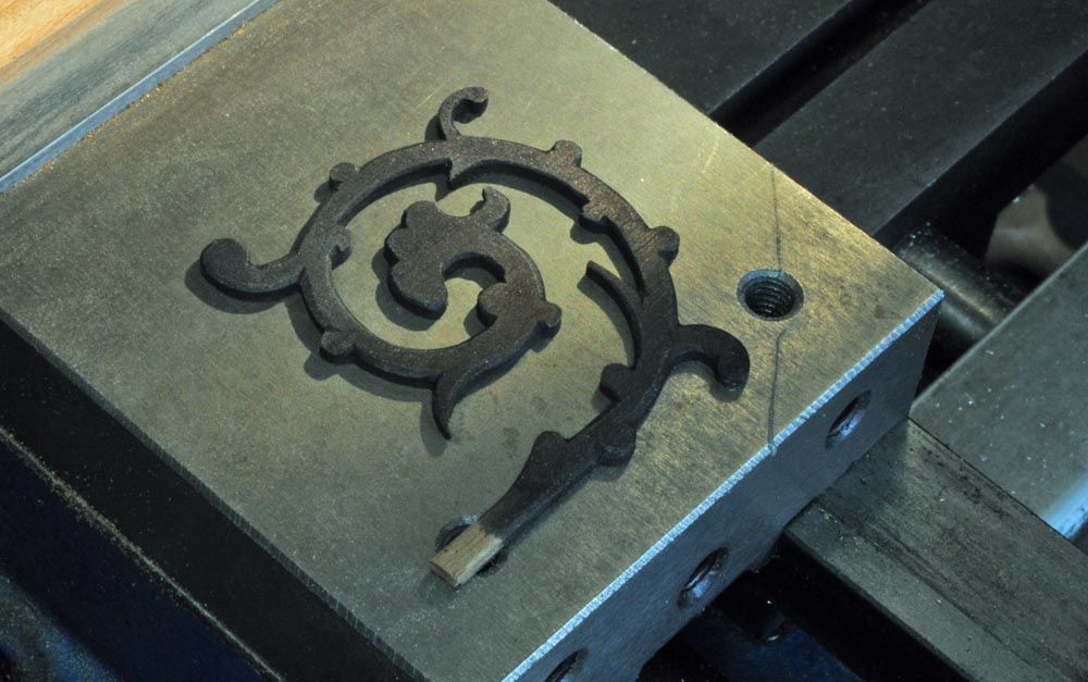

                                              I agree that birch ply is probably the best choice. However, if the look is not acceptable then Pear is pretty isotropic, has no obvious grain and machines well with engineering tools. This will be the bridge of my Baroque guitar, the slot was milled with a 4mm 4 flute cutter.
                                              This is one of the "Moustaches" that will be glued to the soundboard on the ends of the bridge. This is also in Pear but has been dyed black. Cut on the CNC mill with a 1mm 2 flute carbide endmill.
