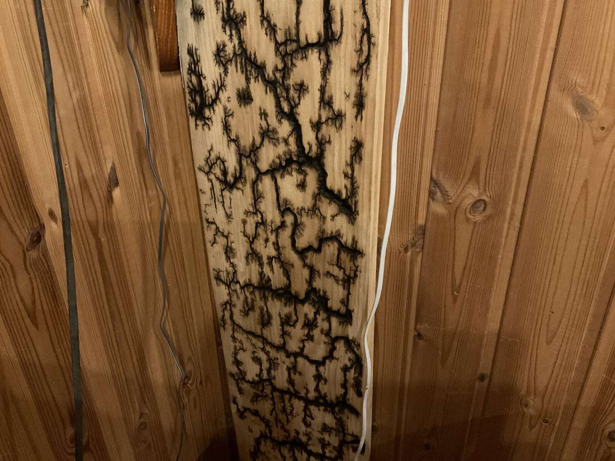

                    I did some a few years ago. Problem is, it’s interesting to build the machine to do it, and fun to make the patterns if you’re careful, but no-one likes the result. I can’t find a use for it.
                    With my machine, you don’t hold both electrodes like so many idiotic videos I’ve seen, just the one that is earth referenced. It’s also current-limited (to prevent the wood setting on fire too quickly) with two fluo light ballasts on the primary side.
                    I won’t let anyone else use it. I think the number of deaths and horrific injuries from these is, at least partly, down to its attraction to arty-farty types who are not science-based and not naturally methodical and systematic. Like any potentially dangerous machine, you need just the right dose of fear when using it. That comes from knowing exactly what it could do.
