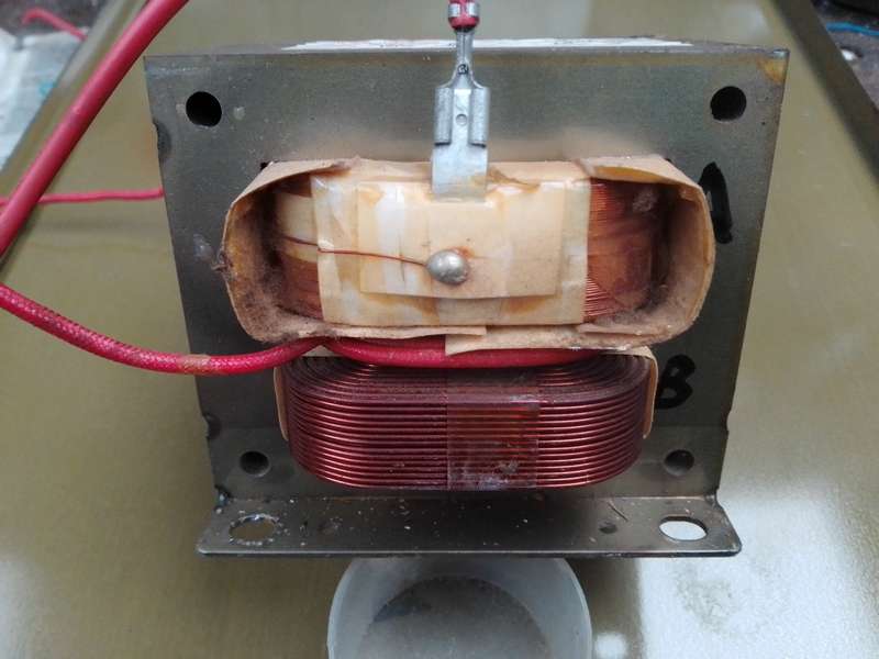

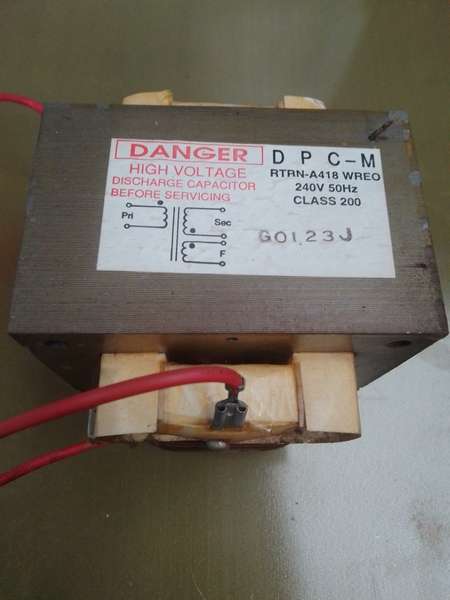

      My old 850W microwave died last week and has been replaced. This transformer is a big heavy lump. Other than using it as a doorstop in the shed or a source for copper wire, What else can i usefully do with it?
      The idea of making a spot welder out of it is beyond my self imposed safety limits and indeed probably my needs. So, what else could I  do with it? Which of the two windings A or B, is the primary?21

              the secondary is the top winding – it can be lethal with a very high voltage – easy to cut through the winding without disturbing the primary (the lower winding ) the aux secondary is just a couple of turns of wire between the primary and secondary windings used to feed the low voltage cathode heater of the magnetron; once the secondary removed quite easy to insert a new secondary of a couple of turns of very thick wire  (insulated) which will produce 100A or so but at low voltage – this makes your spot welder.

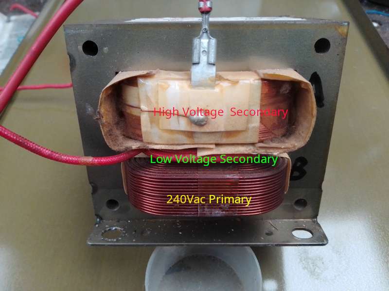

                Elf and Safety Note first: these are I think by far the most dangerous item commonly available for a hobbyist to tinker with.  Being high voltage and high power puts them into Electric Chair territory!
                Breva has survived the first risk, which is the capacitor might still have been fully charged.   They can deliver a nasty jolt, so best to assume they’re still hot.    The usual procedure is to earth them with a suitable insulated cable, with one hand secure in a trouser pocket to avoid an across the heart shock.
                The transformer outputs a couple of kilovolts at about an amp, much more when shorted by flesh because the core is designed not to saturate.   If you get across a microwave oven transformer, it’s delivers beyond maximum power until the 13A fuse blows, or the transformer melts, inflicting horrific life changing burns, even if the victim survives.  Don’t have to actually touch it because the high voltage can jump a few millimetres of air, and may not be slowed down much by a plastic screwdriver handle.
                Also, don’t break into the Magnetron to see what’s inside; they often contain toxic chemicals.
                None of these horrors occur when the transformer is safely installed inside a microwave oven.  Otherwise, approach with extreme caution!
                Most common use for old microwave transformers is making Tesla Coils, though for these it’s safer to use a Neon Sign Transformer.
                https://content.instructables.com/ORIG/FOA/AG4V/I7GRZAL2/FOAAG4VI7GRZAL2.jpg?auto=webp&frame=1
                Neon transformers are designed conventionally with cores that saturate to limit the power output, making them only ordinarily dangerous rather than exceptionally vicious!
                However, it’s usually easy to remove the dangerous high-voltage secondary and rewind the transformer with something more civilised, though the unrestrained core is still a concern.  The HV secondary is the top winding in the photo, visibly many thousands of turns of fine wire.    The other secondary is a few turns of thick red wire, providing a few amps at perhaps 6Vac to the Magnetron’s heater.
                MOV
                Remembering the core doesn’t limit current, possibilities:
                • 1 – 3V at hundreds of amps for electrolysis or electroplating (secondary a few turns of hefty Copper rod)
                • 10 – 50V at 30A-ish for welding (secondary several turns of thick wire)
                • A powerful demagnetiser
                I don’t think its worth making a home-made welder – bit underpowered, and by the time you’ve sourced a box, terminals, and controls, it’s likely to cost as much as a better made commercial model.

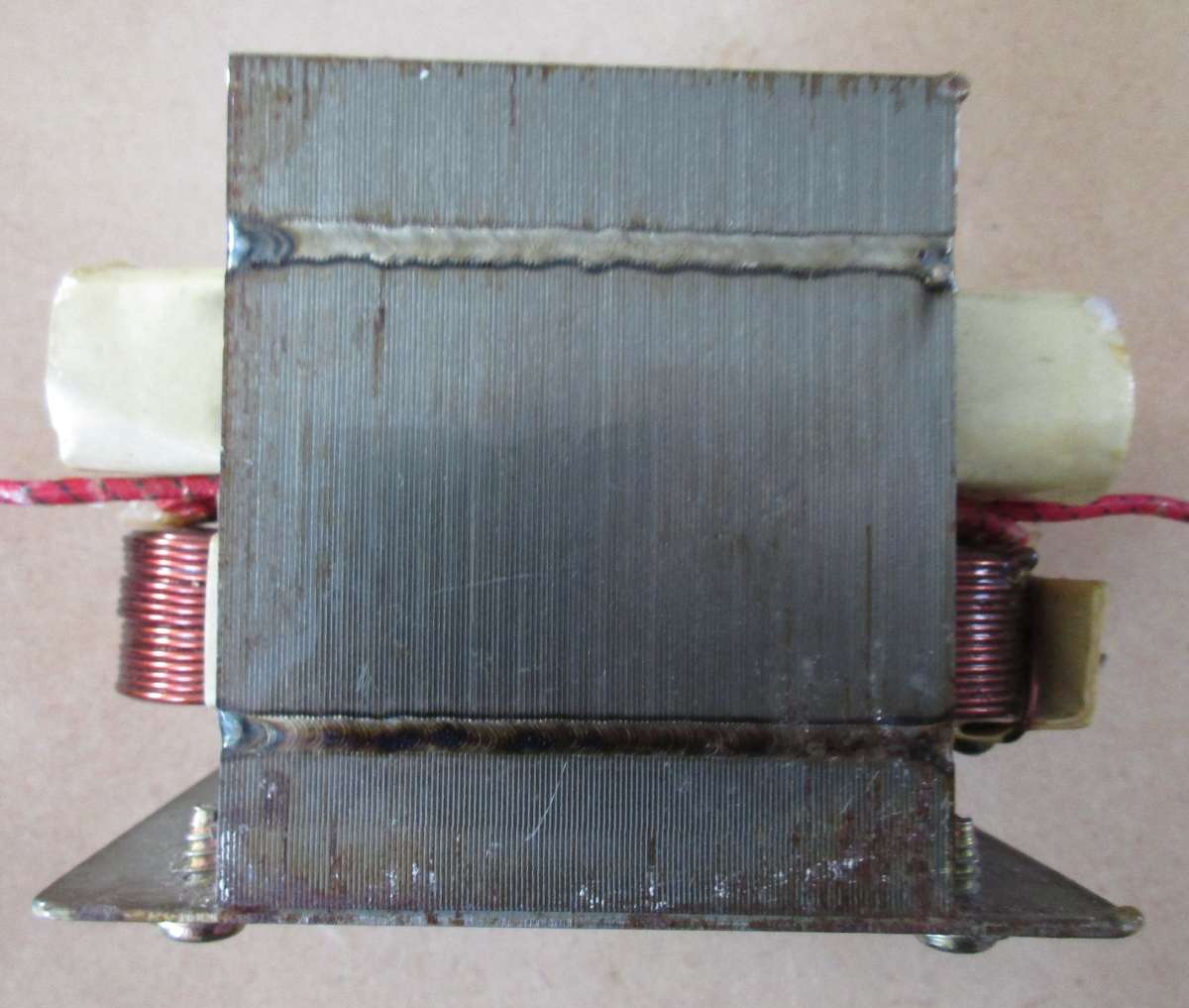

                                    A mag chuck may be difficult with a microwave oven transformer. This is bcause they have a weld run across the laminations making it very difficult to re-arrange them as all E facing the same way to make exposed poles.

                                      The line of weld is hardly a problem. 5 minutes with a triangular file or 5 seconds with an angle grinder will fix that problem. I have done this when rewinding several transformers which have the line of weld.

                                            Hi, I agree with Andrew about the welds, which can be removed as he says, or by plonking on your milling machine and just milling them off, they are barely skin deep as no filler wire has been used.
                                            001b
                                            But you would have to also remove the spot welds holding the baseplate on, which could also be done cleanly with a slot drill on your milling machine.
                                              Coming from complete ignorance, why can’t you just saw/machine the top away to leave an E shape?

                                                Don’t those welds defeat the object of the laminations? They are that so currents cannot circulate around the core.

                                                  Hi Nigel Graham 2, well the one that I have worked OK when it was in the microwave oven that it came out of, and it doesn’t seem to effect the one in the Video that JohnF linked too.

                                                    I have noticed that those cheap stick welder have a weld across laminations in similar way to which micro wave transformer have, must be a valid reason. John
                                                      No. If you consider each outer leg individually there would be no path for the Eddy currents to flow unless they were welded on the inside edge as well.
