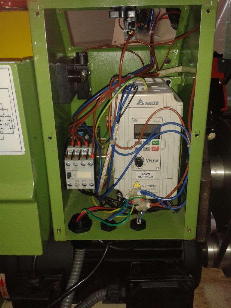

                      ChrisB
                        @chrisb35596
                        Thanks Dave, I just opened the front panel holding the F/R switch and On/Off switch to have a look, apart from a blown lamp on the On/Off switch everything looks fine, no loose wiring etc.
                        Next I checked voltage on the F/R sw in both forward and reverse directions, voltage readings are the same for both directions so the F/R switch should be fine. Supply on the On/Off sw is ok, and same with the emergency stop button. The problem must lie deeper inside the headstock, either in the VFD or the contactor.
                        Will post some pics later on this eve

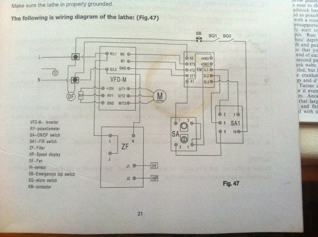

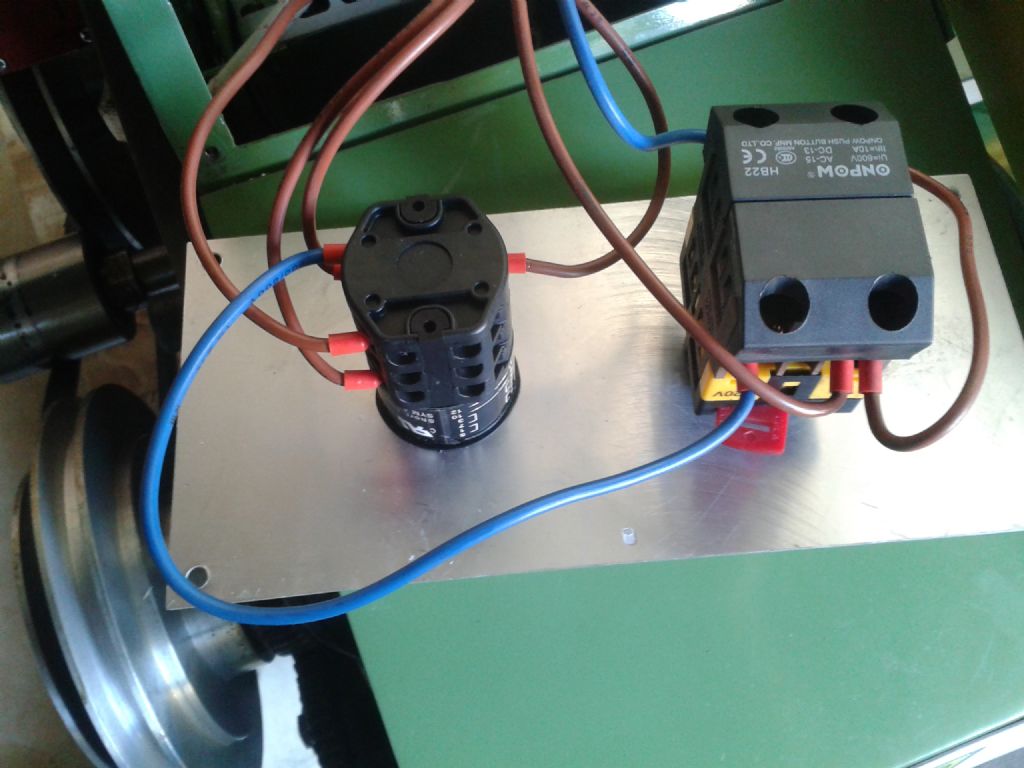

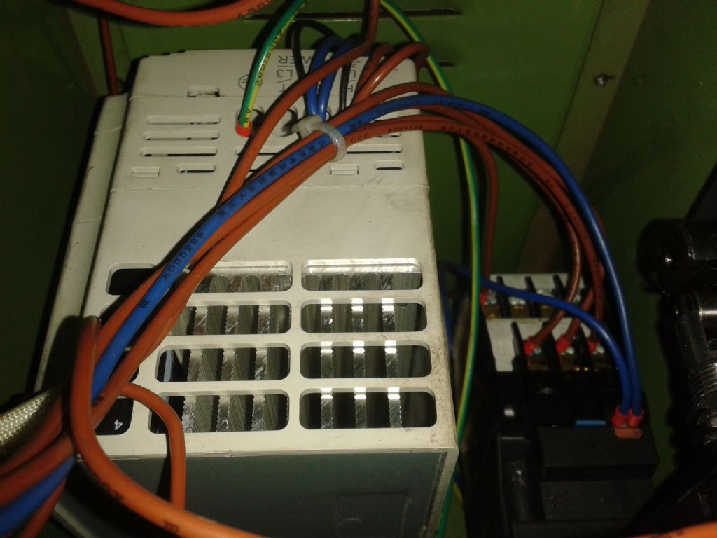

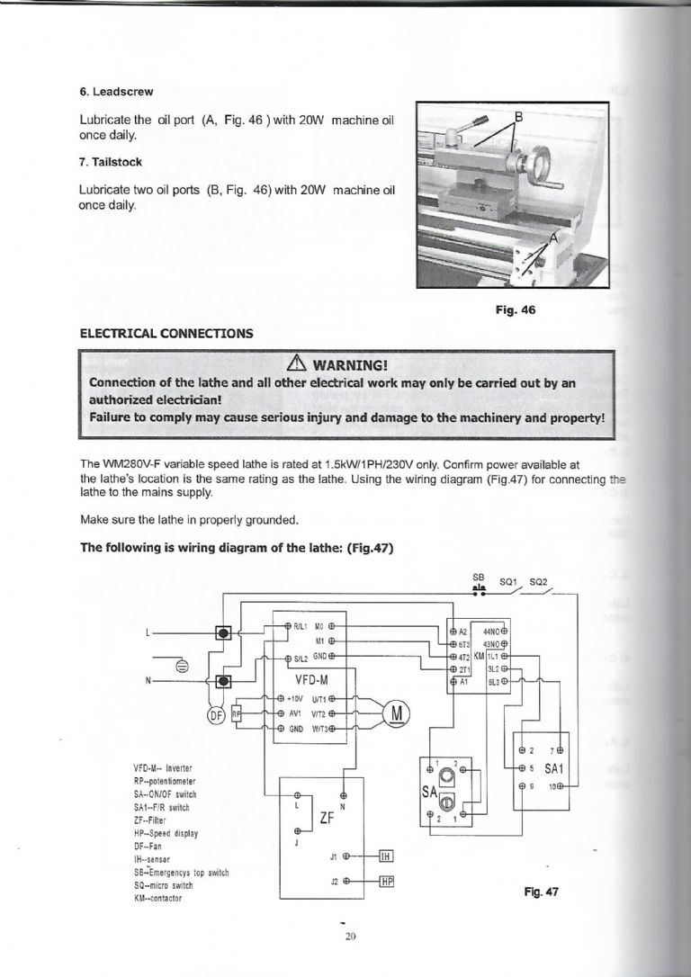

                                          @chrisb35596
                                          Hi Les, the schematic is identical to what I have on the WM280V-F manual so it should work out for me. I'll do those checks tomorrow morning and post an update. This afternoon I opened the switch covers an had a quick look inside before I left for work, wiring is not the tidiest I've seen but everything looks in place, nothing loose. Included some pics of what it looks like. I'll have a closer look tomorrow, maybe I missed something.
                                          Norman, I have contacted Warco in the mean time explaining my problem – I'm trying to troubleshoot and identify the faulty component, it would be much easier that way rather than just telling Warco that the lathe is not working ( I'm not expecting them to come over and check the lathe out, just as well as I'm not going to sent the lathe back!)

                                            Apart from being untidy, the wiring diagram looks a lot different to most other VFD controlled machines. However the schematic itself is not very informative (its not clear what is inside the various boxes on the diagram) so working out how it functions without having the thing in front of me is not easy.
                                            It appears that the interlock switches are at mains voltage which is not ideal.
                                            The filter (ZF?) does not appear to filter anything.
                                            Where is the speed control potentiometer? (not relevant to Chris's problem but shows poor documentation)
                                            What is the contactor for? Most (all) VFDs have logic that eliminates the need for an electromechanical relay
                                            Warco's electrician has some odd ways of working, if it was my lathe I would rewire it!

                                            #296758
                                              The contactor on Chris's lathe (like mine) is a Siemens 22E. That's left me confused because the spec says it has 2 normally closed and 2 normally open contacts, which I have yet to understand given the circuit diagram.
                                              Anyway, ignoring that, Forward and Reverse are selected by grounding VFD terminals M0 / M1 respectively. M0 and M1 are at 5V. Grounding is done via the contactor, presumably so that the lathe stops as soon as any of the interlocks are broken.
                                              An easy check is to flip up the hinged cover at the base of the VFD. (It's marked with the yellow warning triangle in the photo.) Lifting it reveals the control screw terminals which are labelled helpfully. M0 and M1 are on the left of the terminal block and the ground terminal is first right after M5. M0 sets forward mode. M1 is reverse. If you're lucky the M0 wire has fallen out.
                                              With the lathe powered up and the motor on with forward selected, there should be 0V on M0. With reverse selected, there should be 5V on M0.
                                              PS I don't think the bulb in the On/Off switch is connected.

                                                I have just had a further look at the photographs Chris posted.
                                                Warco would do well to heed their own advice and use an authorised electrician (whatever that means). When I have been involved in machine tool wiring there were rules and regulations covering the work.
                                                One glaring omission is an earth bonding wire to the detachable panel, there also seems to be a white cable passing through a hole in the enclosure and no grommet visible. None of the wire ends are identified that I can see. Using a 'chocolate block' in mid air is just crude and inexcusable.
                                                I'm a lot less than impressed!
