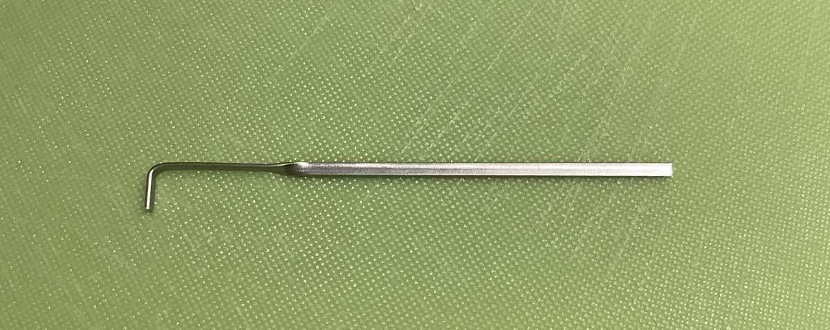

      Anyone know what the steel used in windscreen wiper flat springs is exactly? Is it a high grade spring steel or something cheaper ?
      This seems like a good source of free spring steel, my local Halfords has a never ending supply of the stuff.
      I’m using it to make lock picks at the moment.

        No idea but the stuff I’ve salvaged won’t take a tight bend cold. I tried a tight bend to make a tension wrench and the metal cracked. A slightly less tight bend was ok.

                    No idea but the stuff I’ve salvaged won’t take a tight bend cold. I tried a tight bend to make a tension wrench and the metal cracked. A slightly less tight bend was ok… …
                    Played with some in the workshop this morning, it will anneal, a good red for 45 seconds or something and let it cool.
                    You can hammer a sharp 90* over the edge of the vice without cracking..

                      I’ve not tried that but wonder how durable it is once softened? It’s reasonably workable as it is and I’ve not yet seen the need for a very tight bend.
