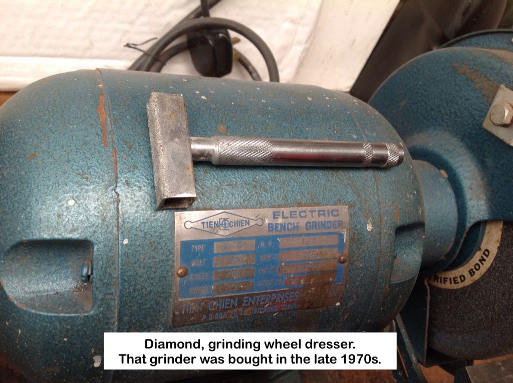

                  OuBallie
                    @ouballie
                    I use the one below.
                    Easy to use and guaranteed to get the wheels square.
                    Diamond grinding wheel dresser

                    #197947
                    mechman48
                      @mechman48
                      I use one of these; I made a ally block to tilt the diamond to about 5* down angle…

                      Ajohnw
                        @ajohnw51620
                        Posted by OuBallie on 24/07/2015 09:06:56:
                        Geoff – Time to take the Austin Seven body off of the chassis.
                        Those are the easy route to dressing a wheel without the problem of evenly feeding a single point tool across the wheel. It's what I use most of the time and my single point one hasn't come out since I bought it.
