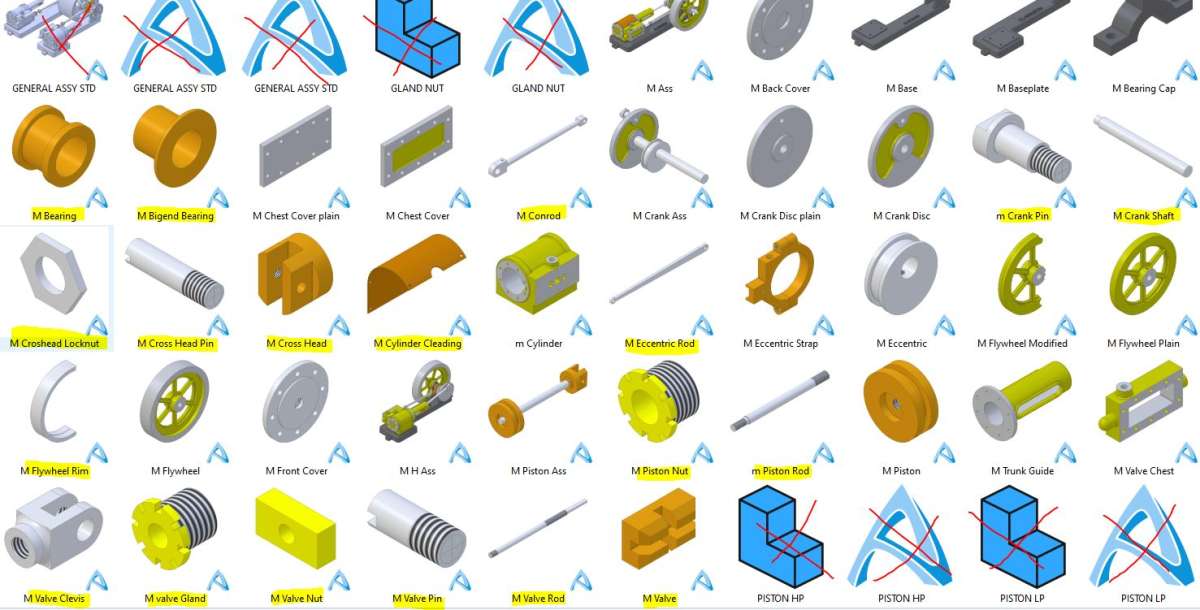

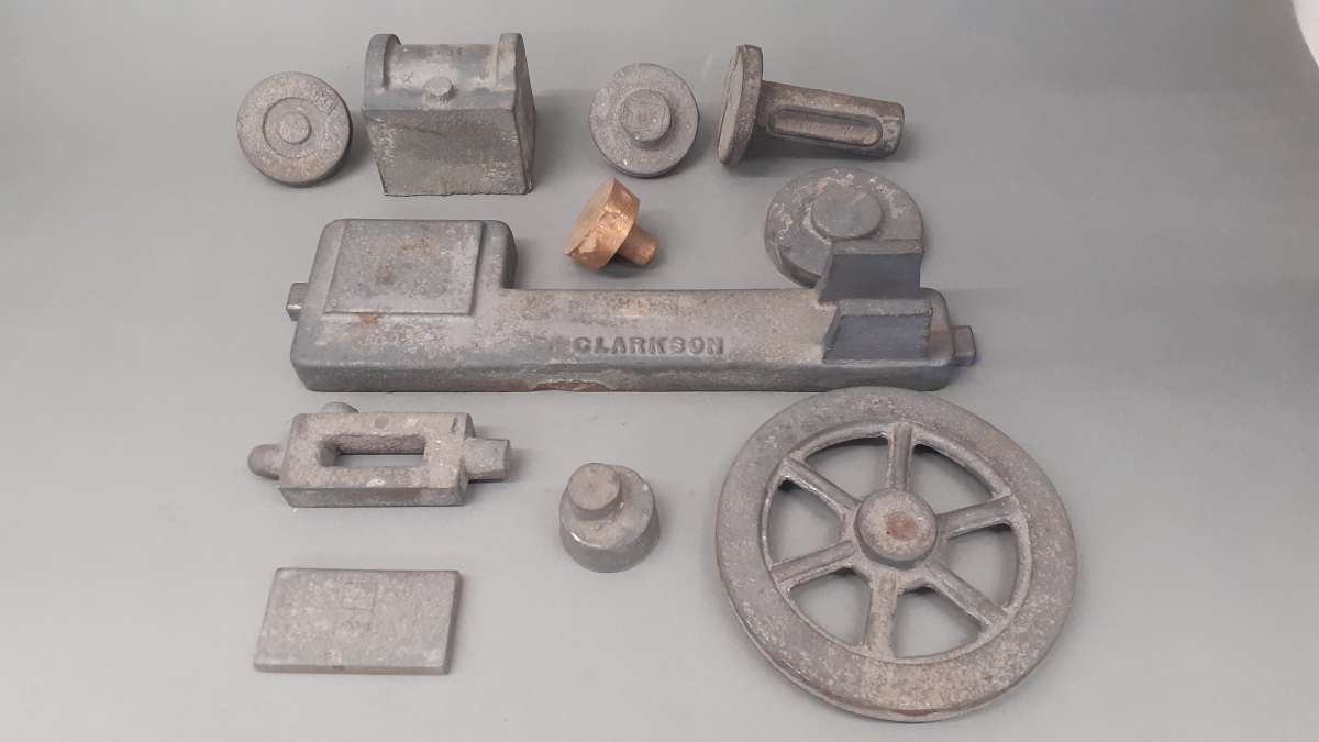

                    #756797
                      Nothing exotic needed for the Clarkson
                      PGMS or silver steel for crankshaft
                      Stainless 303 for piston and valve rods
                      Bit of brass or bronze for the glands for those two rods
                      ditto for valve and nut & cross head
                      0.5mm aluminium sheet for cladding if you want to fit it.
                      Steel round for conrod.
                      Although I am not keen of “bills of materials” I’ll knock one out later or tomorrow. This will give you an idea, items with their name highlighted are from barstock. I don’t tend to buy hex and square, you can mill that from round bar used for other parts so less sections to buy.
                      clarkson parts
                      The Blackgates catalogue photos do not do their engines justice, this is what you get in the casting set (plus the eccentric strap)
                      PM about to be Sent
                      Photo 2

                            There is a Bill of materials for the Clarkson 24 x 38 Horizontal in my Document Gallery now if anyone wants to see what is needed on top of the castings.

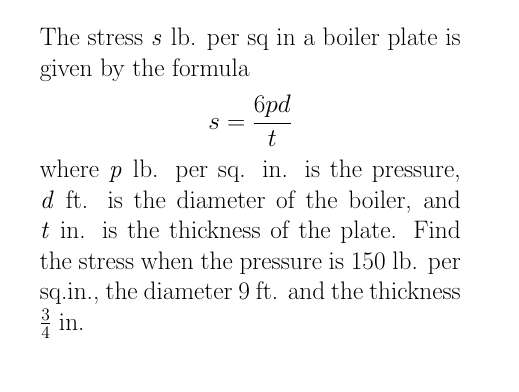

                                          On Pete Said:
                                          Converting fractional inches to decimals is a very easy process that only takes a few simple key strokes on any or even with the most basic of calculators with a method that many don’t seem to know about.
                                          True, but beware.  The problem is the process is tedious and a big plan may require lots of conversions.   The combination makes numeric conversions error prone.   Unfortunately double checking is even more tedious, so annoying mistakes still slip through galore.   It helps to be numerate, to have practised mental arithmetic, and knowing the common conversions off by heart makes it easier to spot sillies.
                                          …. Imperial or metric is just a mathematical concept and one verses the other really isn’t any better or worse than the other.
                                          Not so!  The problem with Imperial is it’s riddled with internal conversions.  Imperial units were derived in isolation, when measuring the weight of spuds hand no obvious connection with measuring length or time.  And before electricity, of which it has no concept!
                                          In a home workshop, there’s rarely any need to calculate using derived units, so all seems well.   But Imperial behaves badly when engineering calls for grown-up maths because Imperial requires multiple internal conversions.   Look at this simple example:
                                          boilerstress
                                          Applying the formula is easy enough and the answer is 10,800 lb. per sq.in.  But hang on, my question to the friends of Imperial is, what’s the 6 in the formula for, and where does it come from?
                                          It’s a ‘magic number’ resulting from mixed units.  The Imperial system being internally incoherent means that it’s littered with them, and they turn anything other than basic maths into a minefield. They’re an extra complication making more work and causing mistakes, definitely not a good thing.    In contrast, Metric was designed to eliminate ‘magic numbers’ and other faults.  Much simpler, and far better suited to maths based engineering.
                                          Fortunately for Imperial fans, Model Engineering rarely calls for the more advanced calculations that expose the systems shortcomings.   Advanced calculation is unlikely to be needed unless a ME is doing design rather than following an existing plan.
                                          As all conversions are bad, converting Imperial plans into Metric, or vice versa, is risky.  Small projects aren’t too awful, but converting a big one quickly turns nasty because bored people make mistakes.  Well I do!
                                          If it has to be done, a slide rule is surprisingly effective because the numbers don’t have to be typed in.
