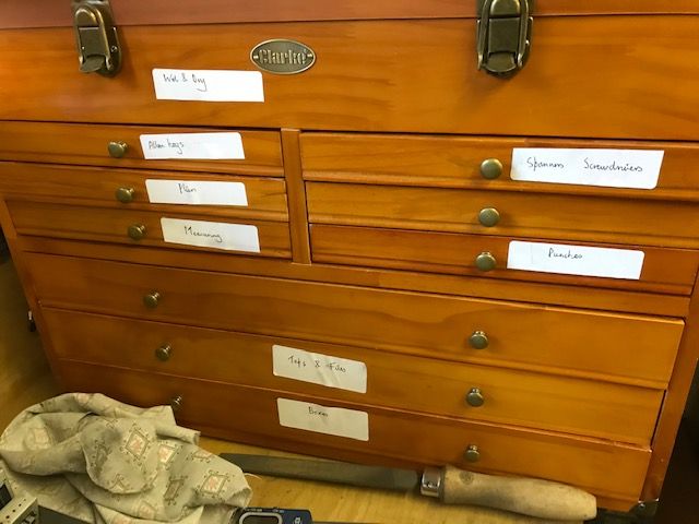

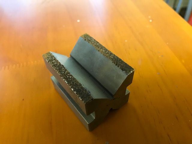

      Two months ago I bought a tool chest in an attempt to tidy up my workshop.
      To my horror many of the tools are going rusty, like this V Block for example:
      The only surface affected is that in direct contact with the bottom of each drawer. It look like there is a layer of material which looks like baize (but is not) glued to the wood and the parts are actually stuck to this. So the question is what has caused this, and more importantly how can I prevent it ?

          Moisture in the wood ??

                I would suggest the baize has been fixed in place with PVA adhesive ( Polyvinyl acetate).

                    Could it be the type of wood? Some types of wood can cause corrosion, I'm sure this has been discussed on the forum.

                      The tannic acid in Oak can cause corrosion in ferrous materials. Oak is not uncommon for Toolmakers tool chests.

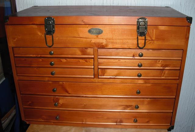

                              cabinet.jpgI have an identical tool chest (Machine Mart), which I bought to store my measuring equipment. It is kept in the house as my workshop has a damp problem in the winter. I have had no issues with rust, so perhaps it is the location of your chest rather than the chest itself.

                                        It is likely that the baize-like material on the bottom of the drawer is a spray-on coating of some description probably a plastic material either applied as one coat or as a dry flock onto a sprayed on adhesive. Would seem likely that the rusting is caused by an adverse reaction between the coating/adhesive and the tool face.
                                        A few choices, as suggested above return as unfit for purpose, further line the drawers with VLC paper or non-slip drawer liner or scrape off the offending coating and apply a new liner. Leaving the old lining in place it may eventually leach through the new liner. The current lining material may eventually "dry" and the volatile/corrosive agent may go.
                                        Seem unlikely to be the wood as this appears to be pine which is usually benign. Hopefully not the varnish either as this should have lost all the volatile agents by now.
