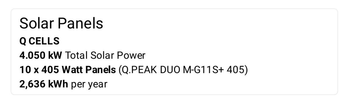

        As I understand it, the largest PV array that can be installed without advance permission from the grid is 4kW (16A) so this tends be the standard installation for a modest domestic dwelling, which ours is.  Michael and I are probably comparing like with like.

            and the next bit you are wanting is probably covered by the ’SAM calculations’
            [ not exactly sure what those are, but they appear to be a standard within the industry ]
            Incidentally, the panels for which I was quoted are surprisingly cheap as ‘raw’ items for the trade: … I will leave you to search for a ‘trade’ source, but they do advertise on the internet.
