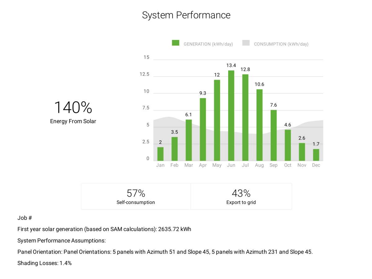

                                          #694715
                                            In stark contrast to Gerry’s enviable situation … My ‘reality-check’ came with the quote of more than £18k for a battery-backed system with ten roof-integrated panels.
                                            I won’t go into the details, but show here a snapshot from the overview:
                                            IMG_9104
                                            Given that I presently pay £55 per calendar month for all the Electricity that I use [the central heating being oil-fired] … this is simply not an economically viable proposition.
                                            The proposal was a masterpiece of wishful-thinking !

                                              Get multiple quotes Michael.

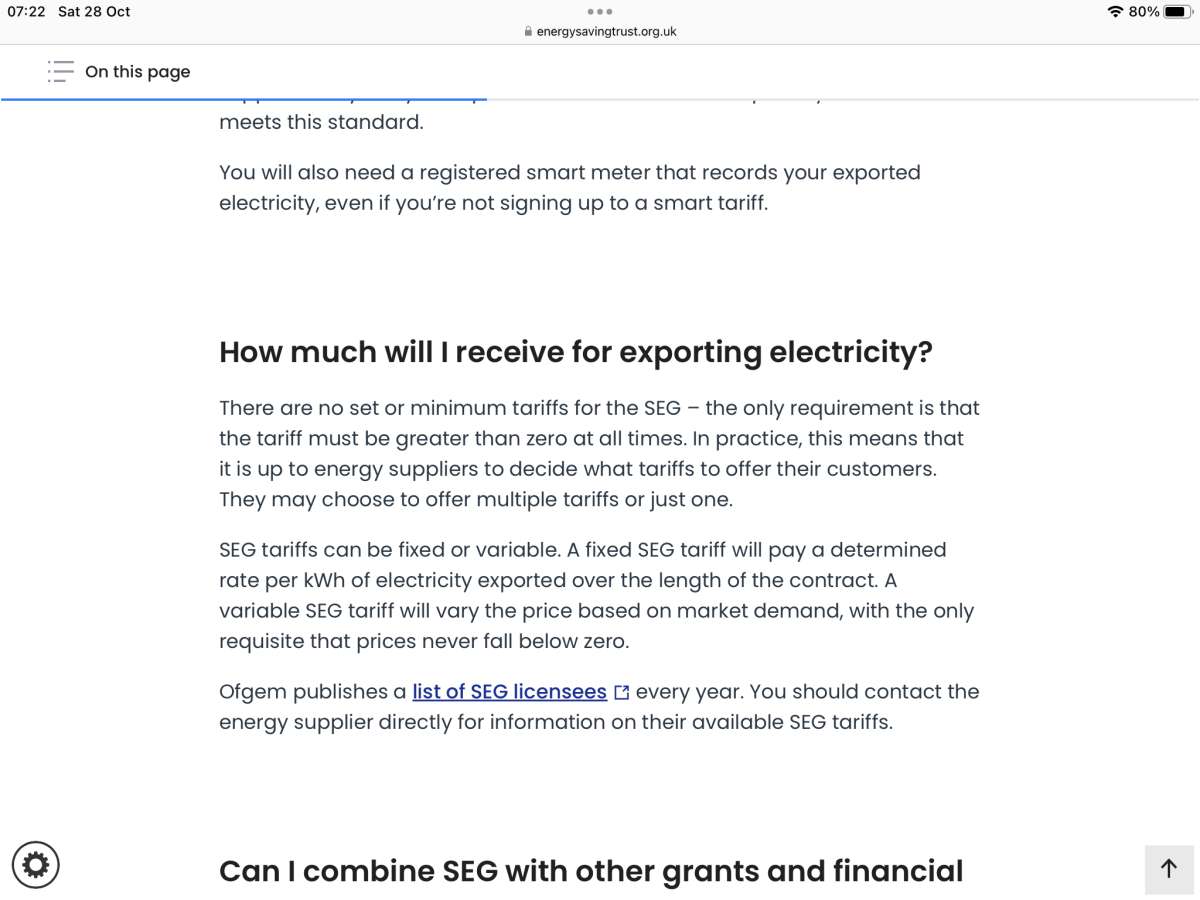

                                                  #694740
                                                    It wouldn’t make any real difference to the logic, Mark
                                                    … unless someone was almost giving-away a system
                                                    My Electricity costs £660 per year.
                                                    If I reduced my nett consumption to zero, the Standing Charge would still be £227 and the SEG tariffs are unpredictable beyond the current year.
