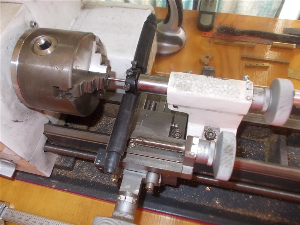

            Posted by SillyOldDuffer on 29/04/2016 20:19:51:
            Can anyone advise on the correct way to cut a thread using the set-up shown in Brian's picture? I have the same type of die holder and am not clear on how it is meant to be used.
            Read my previous post: next to last on the first page of this thread!!
            Pete
            #236816
            Brian John
              @brianjohn93961
              The reason I am using silver steel is because that is what was supplied in the Bengs kit for piston rods and crank bolts. I have cut many threads on this material before with no problems. I will try again this afternoon with some brass rod and see what happens ; I do not have any mild steel on hand.
              The above photo is not my usual thread cutting setup. I usually just remove the topslide and use a manual die holder in the lathe with the tailstock up against it to keep it on course. The lathe chuck is turned by hand but I usually reverse it out slowly under power when I have finished cutting the thread. It has never failed before.
              Rubber sleeves have been fitted over the handles to prevent damage to the lathe :

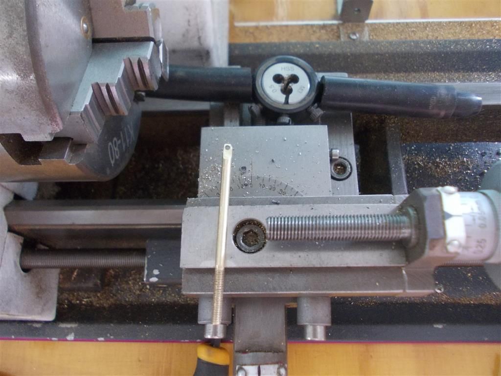

              Brian John
                @brianjohn93961
                I have successfully cut a piston rod using some 1/8'' brass. I turned down the end to 2.9mm to get it started and used a drop of tap magic on the end. It easily cut 15mm of M3 thread with no problems. I can only assume that by not previously using any cutting compound that I have blunted the cutting edges of the die and it is now having problems cutting silver steel. A new die will be ordered on Tuesday.
                Edited By Brian John on 30/04/2016 07:13:21

                  Brian are you sure they supply silver steel with the kit as it is a most unlikely material for this purpose. Stainless steel would be more usual. Is the material supplied in the kit magnetic?
                  If it is cutting brass OK then it is unlikely to be blunt as brass needs a very sharp cutting edge.

                            Anyway the clarification gives me the chance to report back on JasonB's suggestion which was to mount the die holder on a rod gripped by the drill chuck.
                            I just tried doing M4 the Jason way with a cheap nasty die and am impressed. His advice has two advantages over Option 3: first you don't have to fiddle with the drill chuck until to get a suitably loose grip; secondly it is much easier to firmly grasp the die holder whilst cutting the thread.
                            I had to turn down a length of rod to fit into the die holder and then tidy up the die holder's bore to get smooth running. Took about 10 minutes and I was probably being unnecessarily fastidious in cleaning up the bore..
                            Thanks again Jason.

                                I always turn the lathe chuck by hand ; I never cut under power.
                                Please excuse my ignorance but I really do not understand that photo above : why is putting the die holder on a rod in a chuck better than putting the die holder directly in the chuck ?
                                Edited By Brian John on 01/05/2016 17:17:15
                                #237074
                                  You can lock the tailstock to the lathe bed so its all nice and rigid. Then the die & holder will simply be drawn along the work as the die cuts. A lot easier than a loose tailstock that needs to be pushed up against the work and if it starts to drag could strip the thread if it is a fine one.
                                  #237080
                                  Peter Krogh
                                    @peterkrogh76576
                                    Yes, with the die holder 'loose', cutting under power is really safe and easy as you have full control. When you want to stop, just let go of the holder and it will spin on the rod or in the chuck depending upon how you've set it up. A long time ago I made a double ended holder (13/16 and 1) with a 1/2" hole all the way through. I have a 1/2" rod that goes in the tail stock chuck for it to slide on. The 'standard' gadget. Haven't gone back yet!
                                    I have found that inexpensive dies can suffer from a variety of defects, from just plain dull to little or no 'top rake', the flute holes being quite small thus not giving the right rake or enough room for chips to clear. It really pays to closely examine your dies. I have had good success sharpening/increasing rake/enlarging holes with a small stone in my flex shaft tool. A few minutes can turn a dud into a good 'un.
                                    For steels I use the old lard/sulfur cutting oil, plain lard or Crisco for aluminum. Dies for aluminum must be very sharp.
                                    And always a lead-in chamfer on the end of the material.
                                    Best of luck sorting this out,
                                    Pete
