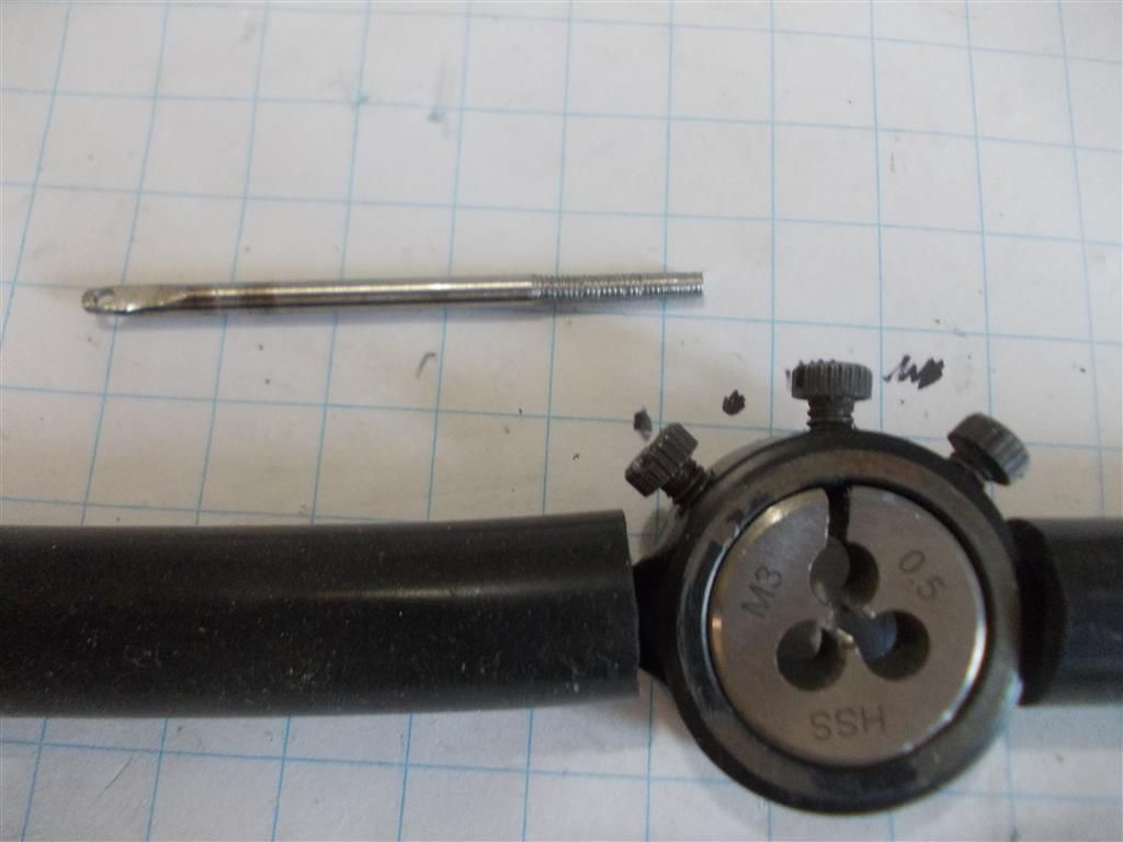

        I have used this M3 HSS die to cut numerous threads on piston rods before. I hold the 3mm silver steel rod in the lathe chuck and I use the tailstock to keep things even. There has never been any problem before but today it just will not cut the thread properly. I hope you can see the photo. The die looks okay ( but what would I know ) although I am surprised by the gap in the split ; I thought it should close up more than that but it will not. The silver steel rod is 2.95mm in diameter.

          Is that a bit of silver steel in teh background or an old screwdriver blade?
          make sure your middle screw is loose before tightening the outer ones and nothing stuck in the slot

            That silver steel is the piston rod with the badly cut thread.
            Yes, I made sure the middle screw was loose ; I even took it out to make sure.

            John Stevenson 1
              @johnstevenson1
              You didn't answer Jason's question.
              Is that an old screwdriver blade because it certainly looks like it and as such has probably been heat treated
              #236639
              Brian John
                @brianjohn93961
                No, it is the silver steel rod I usually use. It is not an old screw driver blade.
                I remember that I did chip part of the cutting thread on my original M2 die but that was quite obvious to the naked eye. I cannot see anything wrong with this M3 die. I may have to buy a new M3 die just to eliminate that possibility.

                #236645
                Chris Evans 6
                  @chrisevans6
                  Did you cut 1/2" or so off the end of the silver steel before starting ? Silver steel is cut to size for dispatch with an abrasive cut off wheel, this locally hardens the end and may have coursed your problem.
                  #236647
                  Rex Hanman
                    @rexhanman57403
                    Try using the die on a bit of mild steel. If it cuts ok it is probably the bit of silver steel that is the problem.
                    #236654
                    Bernard Wright
                      @bernardwright25932
                      Why not try undoing the pinching side screws.
                      Then tightening the centre screw to make a bit larger thread.
                      It would show if the die is duff.
                      Are you threading dry or with lubricant.
                      The suggestion about the end of the rod is a good one too.
                      Bernard
                      #236661
                      Brian John
                        @brianjohn93961
                        This is not the raw end of the rod ; I cut a bit off with the hacksaw to start.
                        I thread dry ; I have never had a problem doing it this way before.
                        If I opened the die up much more than I doubt it would cut at all but I have tried everything else so I may as well give that a go. The die was in the same setting as I used to successfully cut a thread on some rod three days ago….this is why I am so perplexed.
                        #236667
                          Is it a bit you have used as a toolmaker's reamer?
                          Full diameter silver steel is a challenge to any die – you could either skim a fraction of a mm off it before threading OR make a first pass with the die sligthly opened up, and then do a final sizing pass if the thread is tight.
                          I would ALWAYS use a lubricant on any steel, and silver steel in particular, as it will rarely give a good finish cut dry. Plus it make expensive dies last much longer – cutting silver steel unlubricated could have bluntened it a bit but not enough to be visible.
                          #236675
                          julian atkins
                            @julianatkins58923
                            Hi Brian,
                            Firstly there is no need to make the piston rod out of silver steel, so you are making things far more difficult for yourself.
                            My guess is that the die is not lying flat in the die holder. A proper tailstock die holder is a better method, again making sure the die is inserted correctly.
                            The die may also now be blunt.
                            If the material is accurately dead central in the chuck or collet, then you can turn down the first section to 'core' diameter with a chamfer between core and OD.
                            Get some decent tapping compound. I use Rocol, usual disclaimer.
                            The correct closure of the die in holder can be tested by inserting a screw of known standard/size and same thread as the die into the die to check.
                            Cheers,
                            Julian

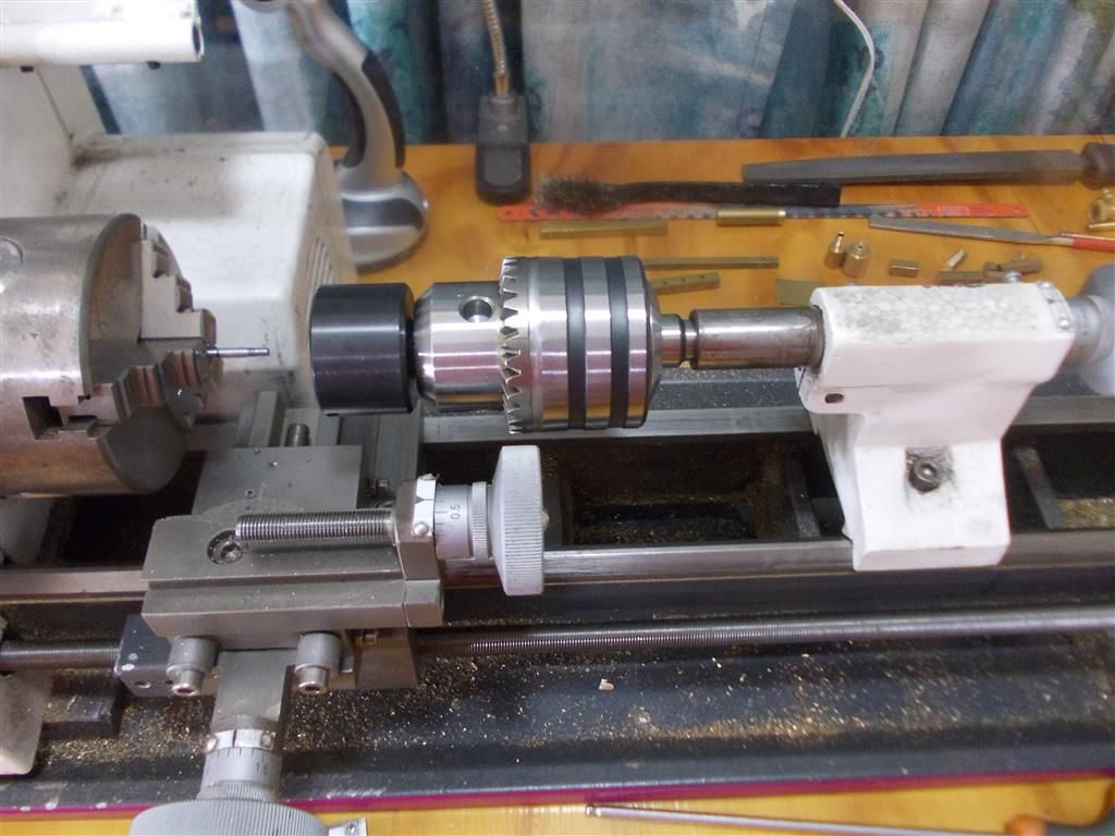

                            #236680
                            Brian John
                              @brianjohn93961
                              I have checked the die with an M3 screw it threads okay.
                              I opened up the die a bit and applied some tap magic to the die : the result is still a mess. It just will not cut.
                              I think we can assume that the die has become blunt so I will order a new one tonight. That is the only way to find out for sure. When the new die arrives I will use tap magic every time. The lack of a cutting compound might explain why it has become blunt.
                              If the new die does not cut then I have a problem.
                              I also tried the die holder. I ordered this months ago but when it arrived it did not fit in my tailstock drill chuck. I then ordered a larger drill chuck which arrived many weeks later. At the time I was busy with something else and I never actually got a chance to use the two of them together until now. It still did not solve my problem
                              I am 99% certain that a new die is required. I cut a thread on this material only yesterday with no problem.

                                      Howard Lewis
                                        @howardlewis46836
                                        All the foregoing advice is good. To which I would add,:
                                        Chamfer the end of the rod, to help the die to start cutting.
                                        Use lubricant (Rocol / Trefolex / Bacon Fat – Don't laugh, it works very well!)
                                        Use a Tailstock Die Holder (Make one?) You are asking a lot to ask a M3 thread to drag the Tailstock along the bed. AND the Drill Chuck does not allow the Die to float to pick the rod.. The Tailstock Die Holders will be a relatively slack fit on the Arbor for just that reason.
                                        Commercial Tailstock Die Holders usually have the ability to accept a variety of sizes of Dies.
                                        I made myself a Sliding Tap Holder, to fit the Arbor for the Die Holder, for Tapping. Again, a slack fit to ease picking up the drilling. (Mine uses ER25 Collets).
                                        Making your own tools is often time well spent, since you can make exactly what you want, you learn, and save money, (and in view of your location, time).
                                        Hope that you get things sorted.

                                                  #236776
                                                    Posted by Brian John on 29/04/2016 12:07:17:
                                                    Edited By Brian John on 29/04/2016 12:14:17
                                                    Edited By Brian John on 29/04/2016 12:15:18
                                                    Edited By Brian John on 29/04/2016 12:27:48
                                                    Can anyone advise on the correct way to cut a thread using the set-up shown in Brian's picture? I have the same type of die holder and am not clear on how it is meant to be used.
                                                    The die holder simply consists of a wide tube at one end to hold the die with a hollow narrow tube or shank at the other. The die holder doesn't have any arrangement that allows the die holder to move forward as the thread is cut. Nor is the holder obviously intended to be hand held.
                                                    A few ways of using the tool occur to me none of which seem quite right.
                                                    1. The drill chuck is wedged into the tail-stock so that it can't turn. The shank of the die holder is firmly gripped by the drill chuck. The tail-stock is unlocked and free to slide on the ways. Whilst the lathe chuck is rotating, possibly under power, the die is engaged with the end of the rod and the whole tail-stock pushed towards the lathe as the thread cuts.
                                                    2. Exactly as above except the tail-stock is locked and pressure applied by winding in the quill.
                                                    3. The shank of the die holder is loosely aligned by the drill chuck but not gripped by it. The die holder is held by hand and pressed on to the rod by moving the tail-stock. As the lathe chuck is turned by hand to cut the thread the die holder slides out of the drill chuck.
                                                    Methods 1 and 2 in my hands are likely to mangle the thread. Method 3 works but doesn't feel like "industry best practice"
                                                    I now use a more conventional sliding die holder. The way that's used on the lathe seems obvious in comparison to the simple type.
                                                    Thanks in anticipation,
