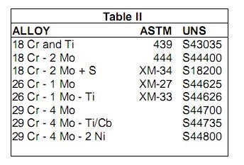

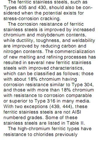

                    I would have thought a grade of ferritic stainless would be the best option for this sort of thing.

                      #212996
                      Ajohnw
                        @ajohnw51620
                        I've seen it used in situations where corrosion would be a serious problem but don't have any precise details about what it actually was other than it was slightly magnetic as they all are.
