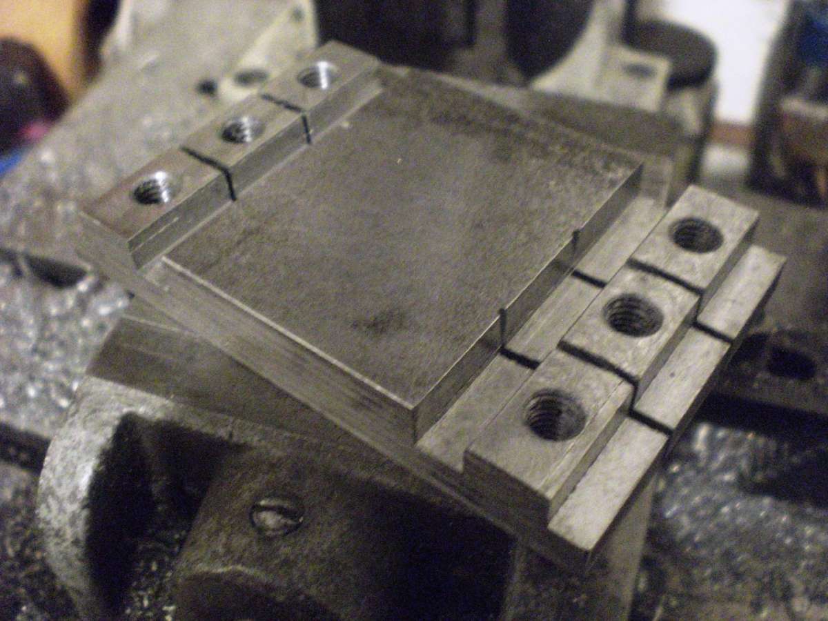

        Hi, I needed four more T- Nuts for my tilting table, so today I decided to make some from a piece of 12mm thick flat black bar. After cleaning off the mill scale, I trued up all the four edges, and set it up in my vice, on my mini mill, then reduced the thickness down to 11mm, 20mm in on each side. I then mill the two outer edges and two channels, to a depth of 5mm, to form the part of the nut, that fits into the slots of the tilting table surface.
        T - Nuts 1
        When these were done, the piece of flat bar was long enough yo make six T-Nuts, and so I drilled and tapped six holes for 6mm threaded rod, and then hacksawed two slots in each side to produce my six nuts.
        T - Nuts 2
        Tomorrow. I will now be able to cut the nuts off the rest of the bar, in my band-saw.
        Regards Nick.

            I am impressed. Despite much grubbing around with the adjustable parallel, my last attempt at a T-nut was much too tight and only worked one way around, which I thought was impossible.
            Yours look like they will all work perfectly without further fettling.

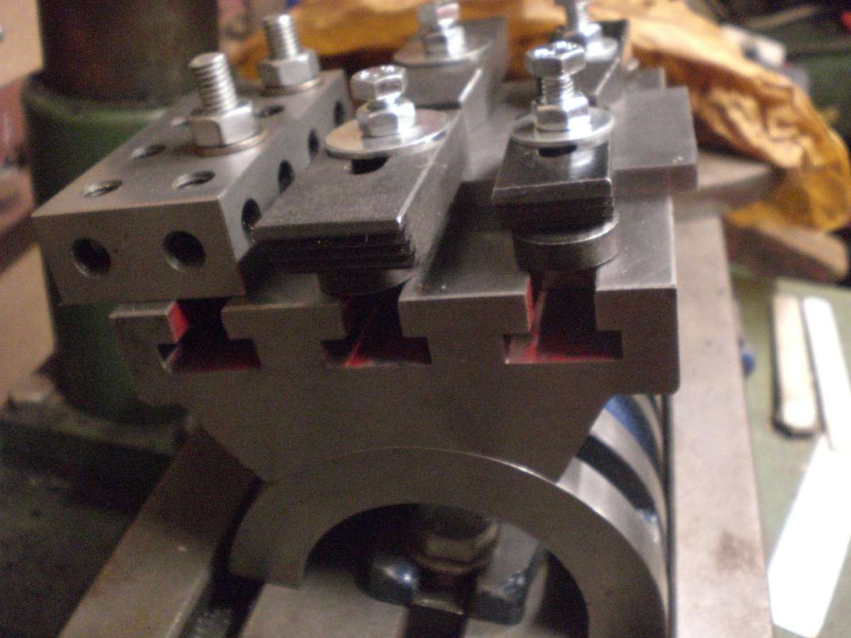

              Hi Robin, they did need a little bit of fettling, but only to smooth them down a bit and to break the corners, as it was black bar I was using, but they all fitted nicely.
              T-T 1
              T-T 2
              Set-up ready for a bit of machining tomorrow.
              Regards Nick.

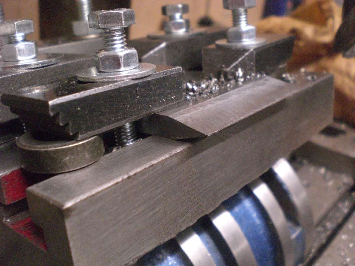

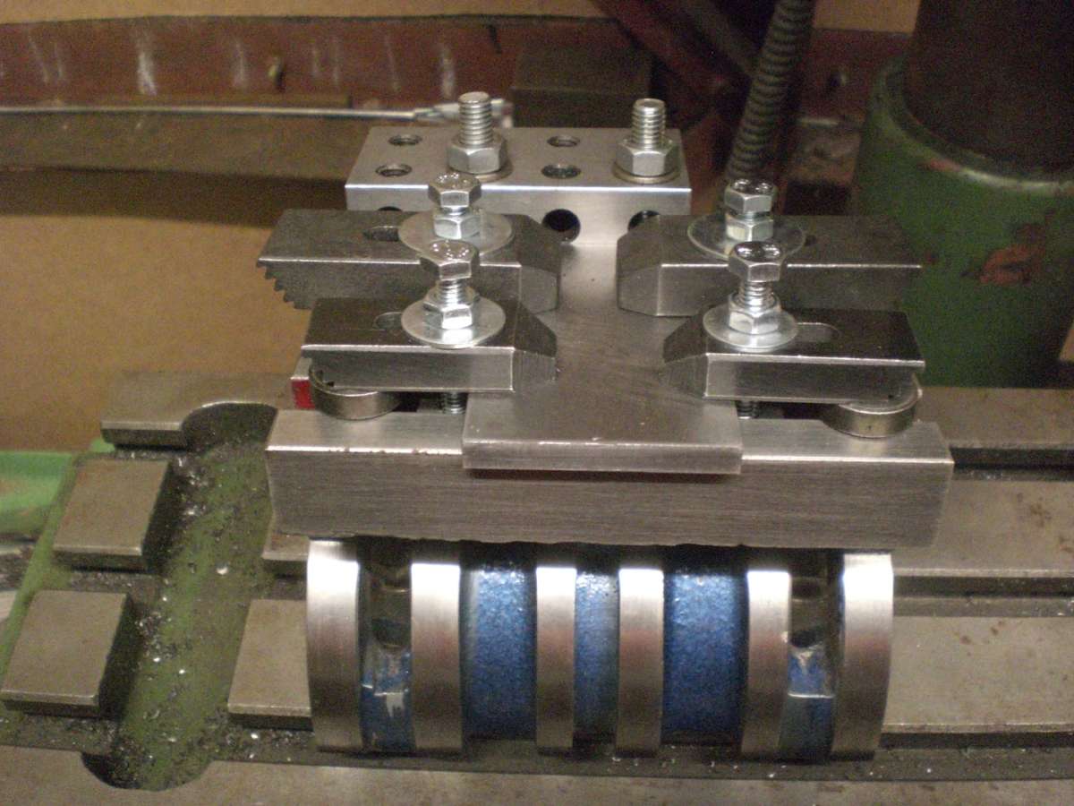

                  Hi Duncan, no need to worry, no tee nuts were injured while cutting them off, and no anesthetic was needed. However, the machining went as well as expected, to produce an equal shallow bevel on each side of the protruding blade, and a little work on my Indian oil stone, produced a nice smooth tiny radius on the resulting edge. The blade was then put into my four inch vice break, in place of the ones that were supplied, which I used on a Tee bar in my Fly press, with a Vee block.
                  CIMG3432b
                  CIMG3433b
                  CIMG3434b
                  I now need to make a narrower one, for another fold at the other end, but I don’t have a suitable piece of steel at the moment, but hopefully I will be able to get a piece at the up and coming Midland’s exhibition.
                  Regards Nick.

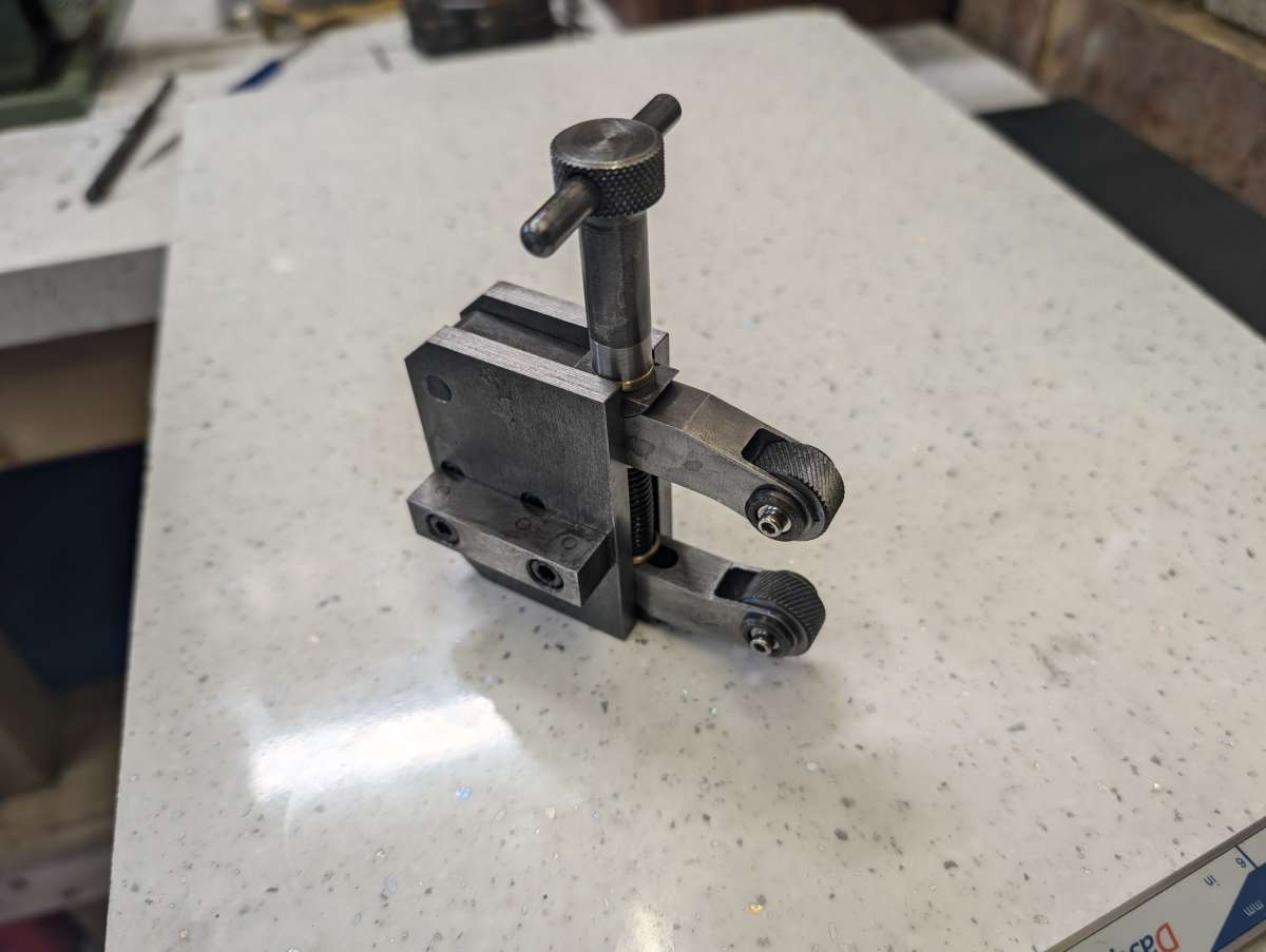

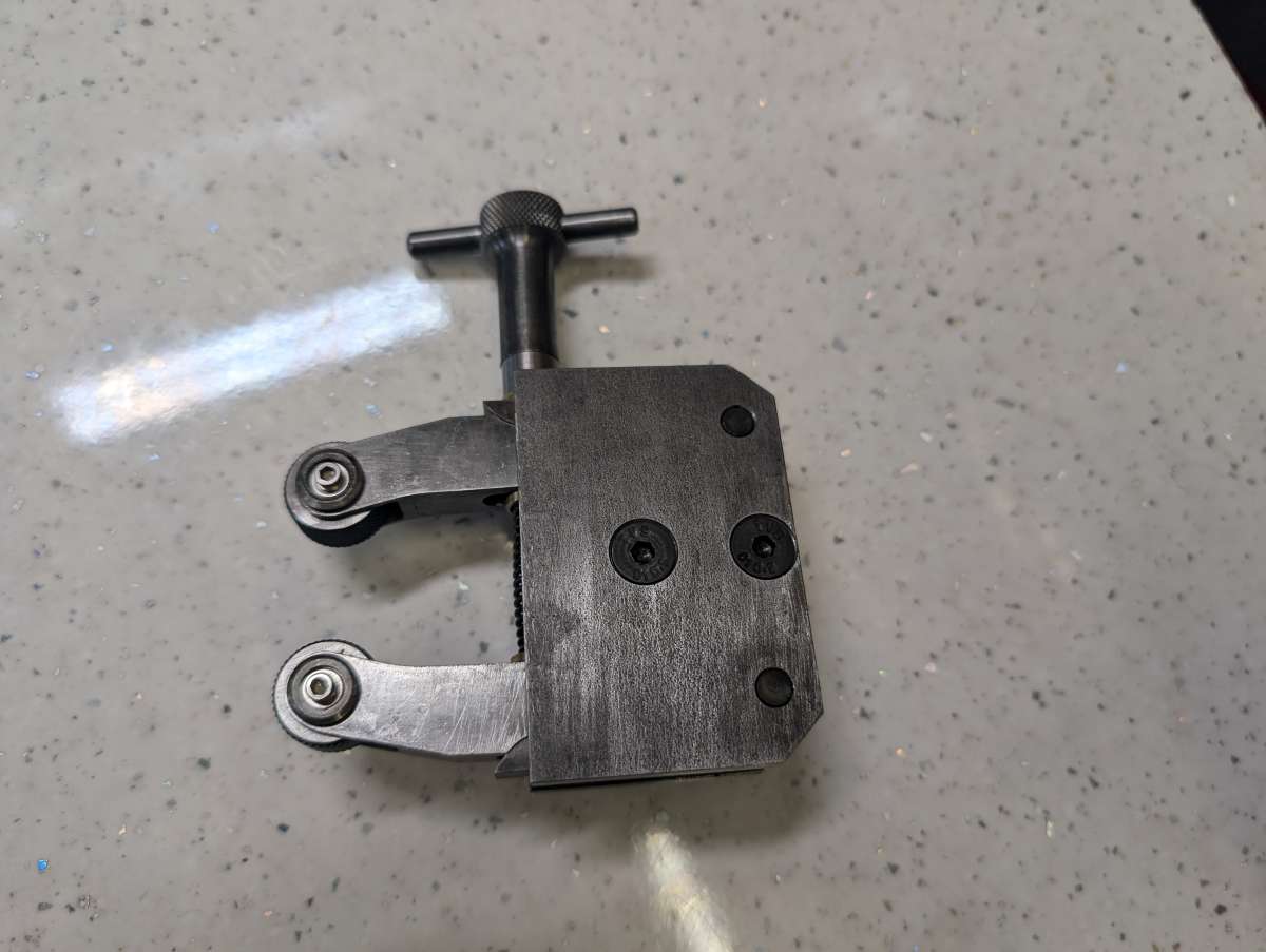

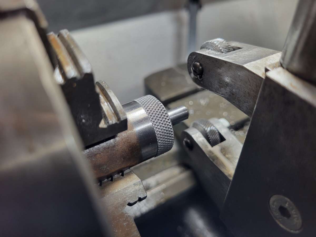

                                    I completed by first “proper” build this weekend, the basic Hemingway knurling tool.
                                    54099710170_6553203719_c54099507533_8e651344ab_c54098392582_fb1ebf084a_c
                                    Built per the plans (albeit in metric), other than I added a couple of cupped (rebated?) washers to the spring ends.
                                    MOD EDIT. Robert can you edit your post so that the images can be seen. You don’t need the IMG code at either end, just paste the url.

                                    Bill Phinn
                                      @billphinn90025
                                      Robert, I can’t view your work for the moment except via the sample photo Jason has posted in a thread started today by Ian P, but from that image I see you have used rather thicker knurls than the kit provided by Hemingway envisages will be used.
                                      This is not in itself a problem but it means that in slotting the arms to accommodate the knurls you have had to remove most of the 1/2” thickness from the centre of the arms. I wonder whether what you have left in the way of side support is going to be rigid enough to stop the knurls from flexing excessively as the knurls pass up or down a piece of work.

                                        Robert Bowen-Cattry
                                          @robertbowen-cattry70600
                                          Sorry chaps, not posted pics here before. Lets try again.
                                          https://live.staticflickr.com/65535/54099710170_6553203719_c.jpg
                                          https://live.staticflickr.com/65535/54099507533_8e651344ab_c.jpg
                                          https://live.staticflickr.com/65535/54098392582_fb1ebf084a_c.jpg
                                          Bill, I was also concerned about this, so added a 2mm washer to either side of either knurl. It give me a little less travel toward the chuck, but the test piece I tried seems OK.

                                            Bill Phinn
                                              @billphinn90025
                                              Thanks for reposting the images, Robert.
                                              I think you’ve got very creditable results there on steel. Well done!
                                              I started making this kit myself over a year ago, but haven’t found time to complete it yet.
                                              I was thinking that if I use the 1/4” thick knurls I’ve got I might use slightly thicker stock for the arms and spacer.

                                              bernard towers
                                                @bernardtowers37738
                                                I noticed the thicker knurls as well, the original marlco knurler used thin knurls for a reason possibly less  strain on the machine and easier to traverse although the knurl looks good from the photo

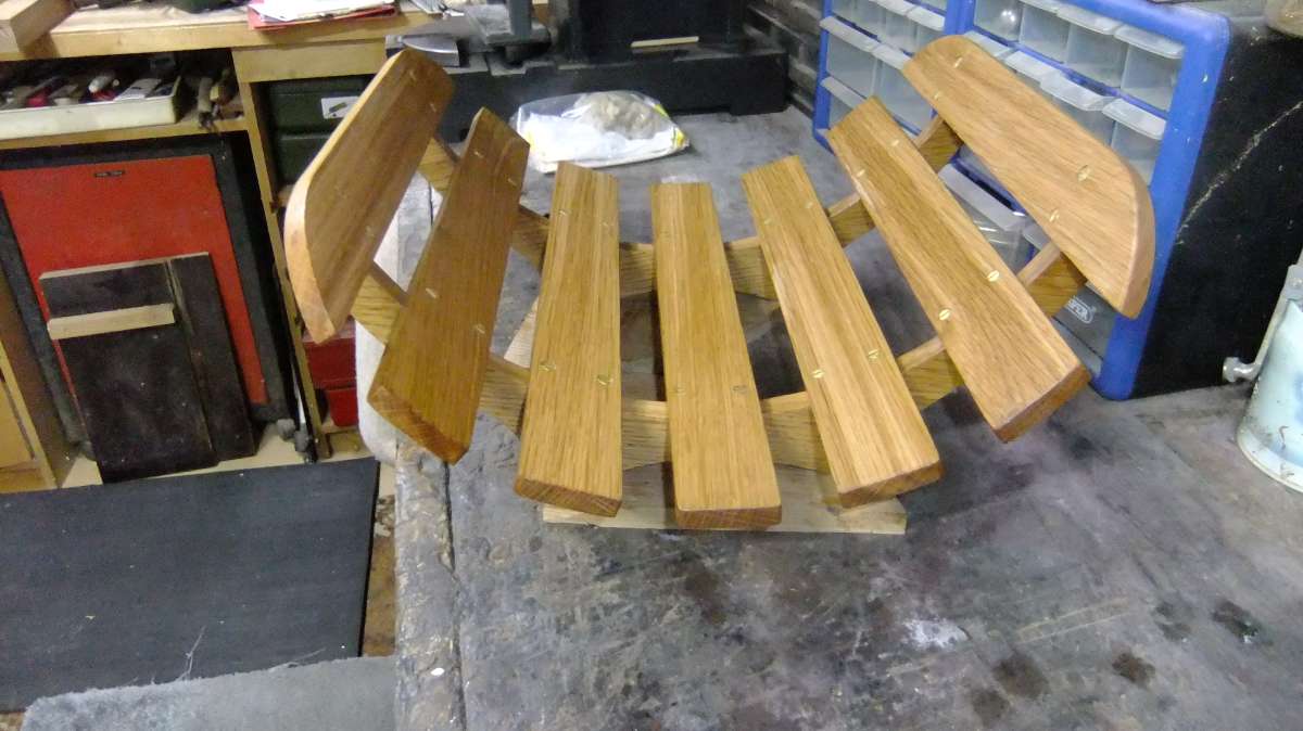

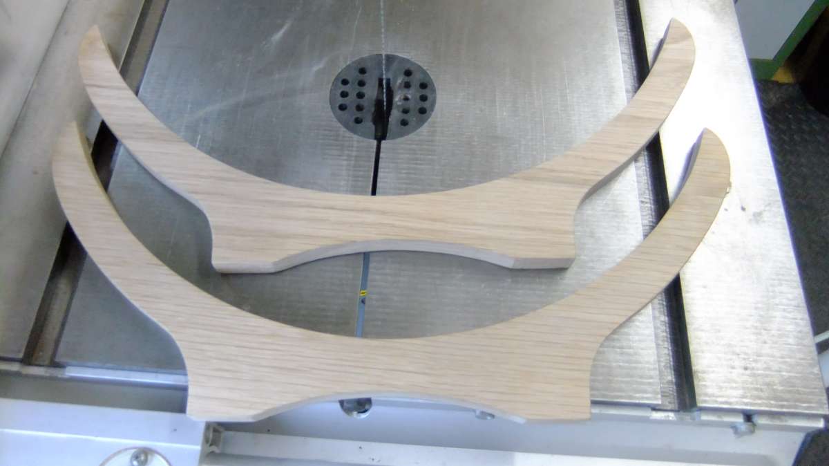

                                                Dalboy
                                                  @dalboy

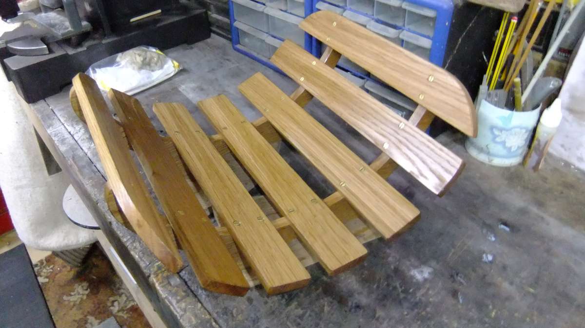

                                                  Back playing with wood for a couple of days. No, not logs for woodturning, but rather for a log burner as a Christmas present for one of the family. Finished with oil still wet in the photo.
                                                  log storage (2)log storage (4)log storage (5)log storage (6)log storage (7)

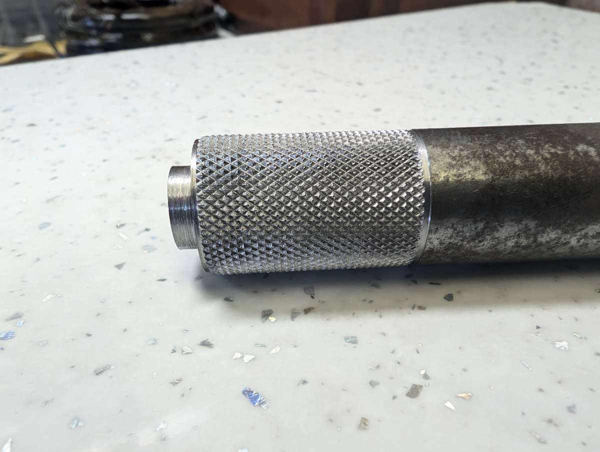

                                                  Craig Brown
                                                    @craigbrown60096
                                                    When I built the Hemingway Knurling tool, I increased the dimensions of the required parts to allow me to fit the more commonly available knurls. I only have one picture currently but I always have good success with the tool

                                                    #762011
                                                    Robert Bowen-Cattry
                                                      In my case, I wanted to use the knurls from a previously purchased knurling tool, though stupidly I didn’t measure the knurls until I was ready to slot the arms. Still, a lesson learned, plan better in the future. 🙂
                                                      Rather than scrap the parts or buy new knurls I decided to push on and use what I had. The wheels are ~9.5mm, and the arms 12.5mm, so I was left with 1.5mm either side. I did think this looked too thin so made up some outer washers at 2mm each to hopefully give some additional support. The pins are drilled and tapped straight through.
                                                      Only time will tell if this works, worst case scenario I will have to remake the arms, but at least I have learned something from my mistake.
