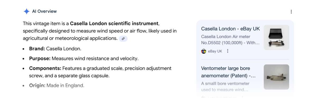

        The mighty Google tells me:
        IMG_1450

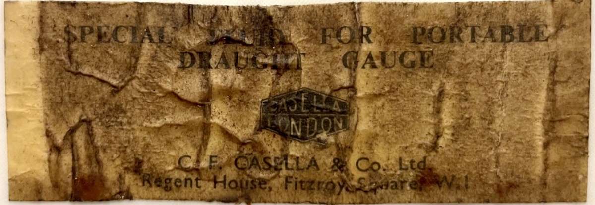

                        I soaked the label off the bottle, and have the text [with only the single most important word being illegible ! ]
                        Maybe tomorrow, in daylight
                        IMG_0389
                                    That says “FLUID”
                                    Rob

                                      Well done, Rob !
                                      I’ve just woken-up, realising that it was the only word that could reasonably fit.
                                      … a cruel joke by Casella, methinks !
                                      Edit: from Bill’s reference, the bottle likely contained something from the photographic industry, or plain water with a drop of Fairy Liquid.
