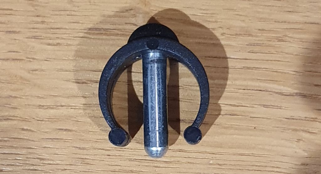

      Does anyone know what clips like this one are properly called, and where I might buy a few of a different size?
      This one was originally used to set the extension on some crutches, and I'd like to get hold of a smaller size for another application.
      My own searching comes up with "E-Clips" as a name, but that is also the name of the external circlip type things, which doesn't help with searching at all!
      Thanks.

        Milly S
          @millys
          Hi I think what your looking for are called locking tube clips
          as used on medical frame’s /crutches & wheel chairs
          #638450
          speelwerk
            @speelwerk
            "crutch horseshoe clip" or height adjustment clip gives result. Niko.
            #638451
            Martin W
              @martinw
              A quick search of Ebay has turned up, Quick Release Actuator Retaining Clip Pin with Loop, which are not quite the same but work on the same principle and should be more robust. See ebay page here.
              May well be others but these turned within 2 or 3 mins of looking.
              Cheers
              Martin
              #638456
              YouraT
                @yourat
                Thanks everyone – I think the *real* problem is that no-one makes these for smaller applications – in my case I need the pin that goes through the parts to be 3mm in diameter. The medical device/crutch adjusters are the smallest I can find – I'll either have to make something myself or change my design to do it another way.
                The major attraction of this design is that there's nothing sticking out too much to catch if the items it goes through rotates.

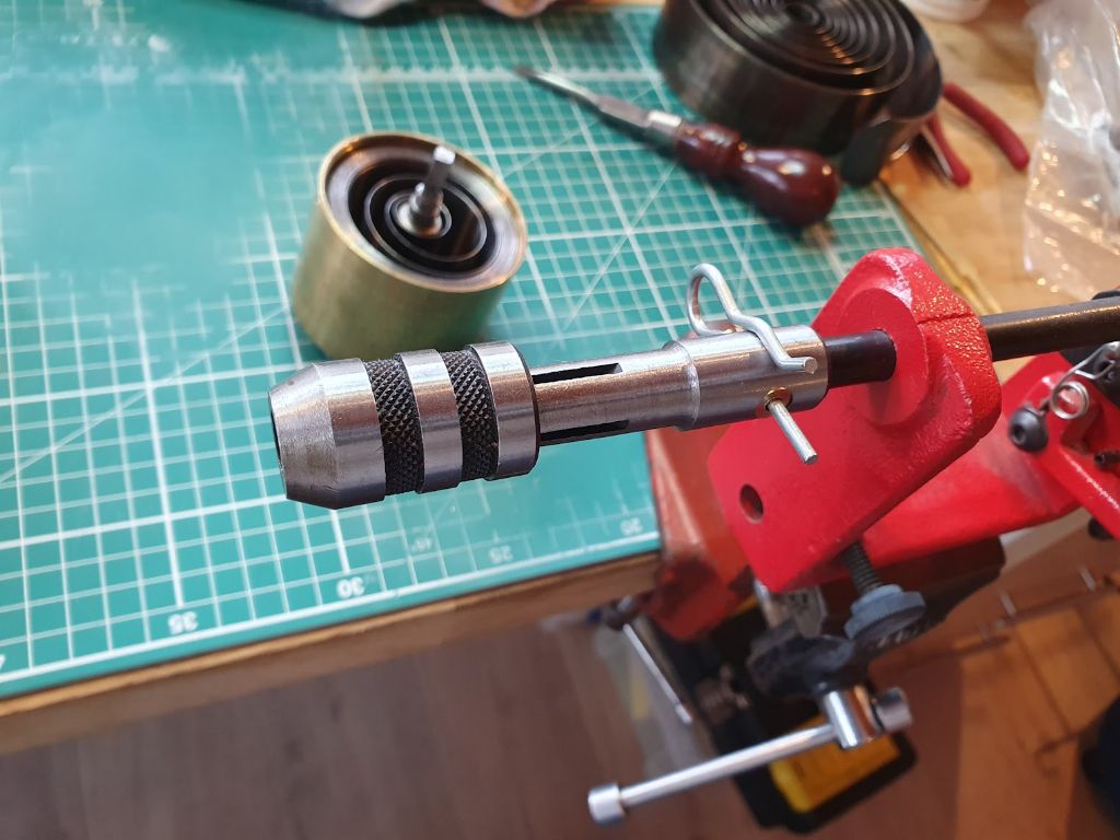

                        Yes – in fact an R-Clip is what I'm using at the moment, but I can see a circumstance when it will either get in the way or catch on something (a hand for example) with unpleasant consequences.
                        It needs to be removable as I only need to use the large winding arbor gripper (adapted from a tap wrench) for large fusee springs, and want to use the original, smaller gripper most of the time. Originally there was a roll pin.
                        Tool clips could work, not as smooth as I want, but better than the R-Clip, and the pipe clips also, and I could file the corners off to make them smoother.

                        DC31k
                          @dc31k
                          For smooth and unobtrusive, use a slip fit plain pin and make a plastic sleeve that fits the OD of the modified tap wrench. Slide the sleeve sideways when you want to release the pin.
                          My cheapskate version would be a slice of bike inner tube, an elastic band or a wrap of insulation tape.
                          Have a look at how black oxide impact sockets are retained – semi-circular groove with O-ring stopping pin escaping.

                          bernard towers
                            @bernardtowers37738
                            Could you put your 3mm pin through the hole (just long enough) then slide a collar over the pin?

                            Spurry
                              @spurry
                              Following on from bernard's idea, copy the method used on Makita impact wrenches which is to have a shallow
                              groove which holds an O ring to keep the pin in place.

                              YouraT
                                @yourat
                                DC31k, Bernard and Spurry:
                                genius ideas – I will do something along those lines – I love the O-Ring concept especially
