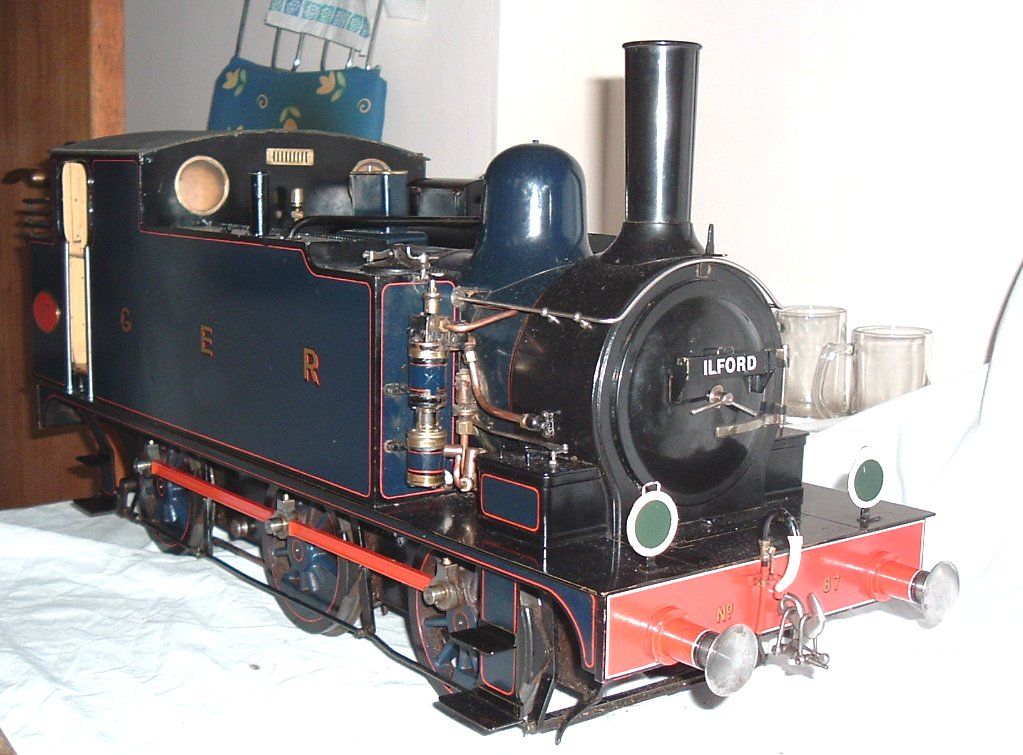

                                Greetings, A long time ago, I built a Great Eastern Railway S56 Class "Buckjumper" in 5 inch gauge, which had a working Westinghouse pump, which was based on the Roy Amsbury design.
                                Roy was very helpful with details, and the pump worked fine, but tended to run a little fast.
                                I have to say that I think it used more steam than it put water in the boiler.
