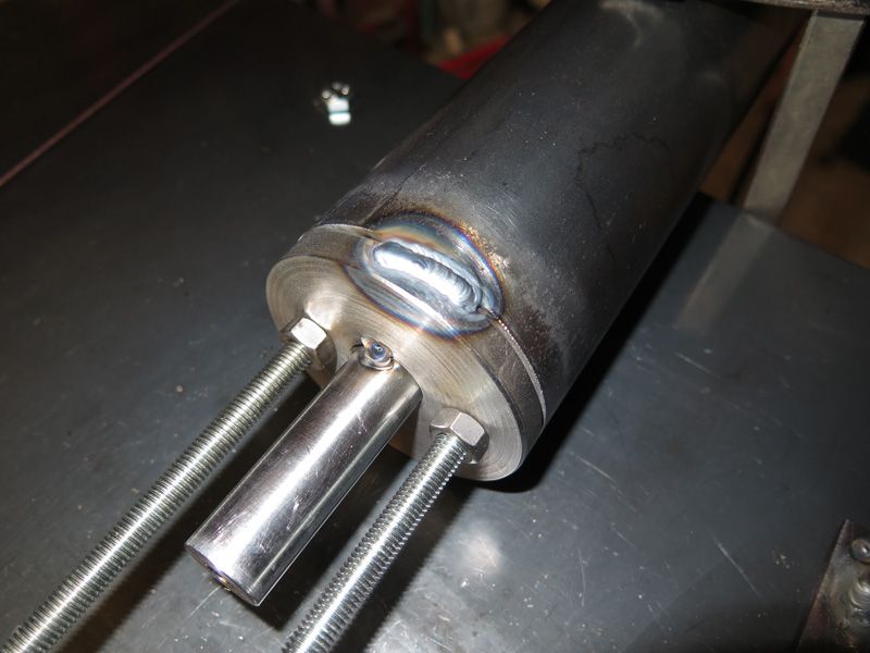

      Hello All

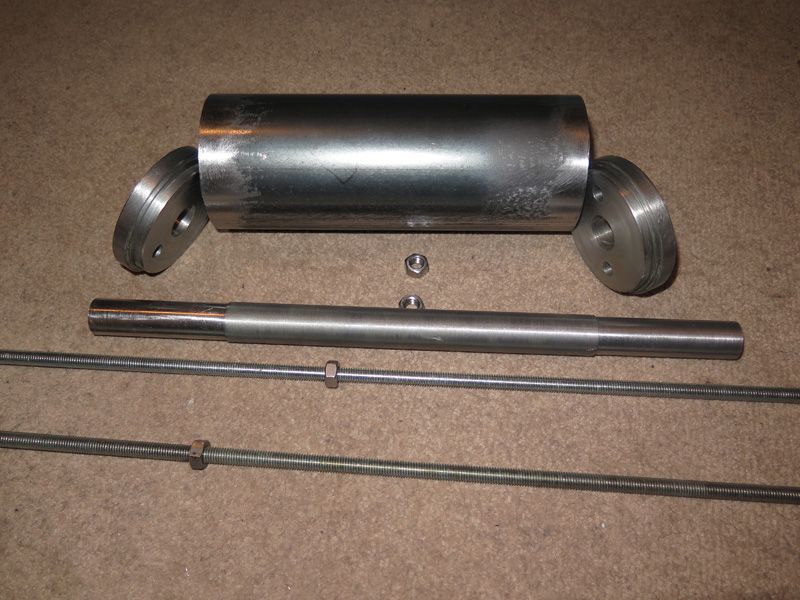

      My wife spends a lot of time making Lino prints. It’s a process where she carves a picture into lino, puts ink on the Lino, and then prints the image onto paper. Now, before I’m allowed to move on to my next model engine project I’ve promised my wife I’ll build her a printing press smiley. So apologies that this isn’t model engineering, but I have a problem with regards to making part of the press. The press is essentially two rollers, a bit like a mangle, and the paper and lino pass between the rollers. According to the plans it’s essential that the rollers are absolutely true and parallel , and if I don’t manage to achieve this then the ink will not be applied evenly. And, I’ll be in trouble!
      The parts for the roller are shown below.

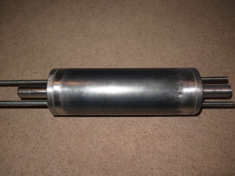

      My plan was to clamp everything together as show.
      Next I tack welded everything in place.
      Finally I welded all the way around with the intention of then tidying up in the lathe.
      Of course, what has happened is that the heat of the weld has distorted the central axis. Before welding it was completely true (to within < 0.01 mm across a length of 34 cm), but after welding the axis was bent at one end. Maybe with a runout of plusminus 0.15 mm.
      Does anyone have any tips that I can use for MK II. I was thinking of taking things far more slowly (so the bar never gets too hot), and perhaps not turning the outer diameter until after it’s welded ? (The welding process was TIG). Any help is hugely appreciated as it took quite a while to make the parts so messing up again will be really frustrating – and delay even further the next model engine!

          Any way you could fasten parts mechanically i.e. lock tight adhesive, screws, rivets, press fit etc. to do away with welding and heat distortion.
          #215236
          duncan webster 1
            @duncanwebster1
            I would guess that the distortion is where the spindle exits the end flange, not in the main tube. I'd be tempted to address it with a hammer and try to get it a straighter, if this doesn't get it staright enough then mount it in the 4 jaw one end, fixed steady the other end, centre drill and and skim the spindle true, reverse and do the other end. If it's still not straight enough then mount between centres and skim the big diameter

              As a long time fabricator I can say that the rule always is weld first then machine. Any other way can be much more work!!!
              Pete
              #215244
                Make the spindle from the next nominal size up and put a ctr drill hole on each end. Then when welded mount between ctrs and true up the two spindle ends as well as the main roller.

                      If you want it dead true,and the rollers do not look that big I would machine from solid,rough it out leave for a few days,then finish machine. In my apprenticeship days,the company made a prototype high speed continuous stationary printing,perforating and folding machine ,for the early green stripe computer paper (1961) the rollers were fabricated from tube with the ends pressed in.no loctite in those days,and welding was something that garages did,the ends were one piece ,short shaft plus the larger diameter,after pressing the whole assembly was finish machined.The perforating rollers which carried the perforating blades were machined from solid,as no deflection could be tolerated.

                        Have you considered using heat to correct the error, after all this is what caused it. All welds shrink as the weld pool cools from freezing point down to room temperature and no amount of mechanical restraint will stop it. The forces involved are massive. Judiciously applied heat that creates a small weld pool in the correct location will pull the part back to the desired position. If you are likely to scrap the part otherwise it is worth some time trying this.
                        The other option is to try to relieve some of the tensions in the welds by normalising as Tony suggested but this requires taking the part to high temperature and holding it there then reducing at a controlled rate. May be hard to do correctly in a home workshop.

                          As above, skim in the lathe including the main roller if required. A job like this is not size critical. Make bronze bushes to suit the new spindle size or sleeve the spindle to suit roller bearings if that was your plan. I would not make it again.

                            Could you not salvage this by finishing your intended welding. Then turn down the shafts at either end to size 'X' bringing them true.
                            Then make sleeves with an internal bore with a close sliding fit to size 'X'. Loctite with 638 and return (if required) to desired size.

                              Putting all of the problems together I would still use the tube and make the ends in one piece and then loctite it all together. Keeping the tube will keep the weight down compared with it all being solid.
                              There is always a chance the the bore of tube isn't concentric to the outer diameter so I would be prepared to skim the entire thing up after assembly. You could do this after welding it all up anyway maybe even fabricating the ends.

                                    I think you’ve all saved the day! Thank you for all the very helpful and detailed replies.
                                    The lesson I’ve learnt for next time is weld then machine, not the other way round (i.e. ‘when welded mount between ctrs and true up’ and ‘the rule always is weld first then machine.
                                    The plans call for the roller to go in take up bearings and they come in sizes of 20mm, 17mm , and 15mm. The plans also call for a 20mm shaft, and so I didn’t want to turn the shaft down to the next size of 17mm in case if flexes too much in use. Hence I’d originally dismissed that idea. Anyway, after that some of you then subsequently suggested that I try and salvage by turning down and that made me rethink. Next I discovered that I can get imperial bearings that are 19.05mm – which should be fine.
                                    I really wasn’t excited about making it again! After a quick spin in the lathe it’s looking great!

                                              Sometimes a shaft like yours can be straightened just by grinding back the weld opposite the bend a bit then rewelding, it's a bit hit and miss, but worth a go.

                                                As per what the others mentioned you can machine the OD after welding.
                                                Also smaller tacks spaced around the diameter. Potentially bevel the end of the tube and disk so you have a V to weld into, that should allow you to focus the arc more easily allowing lower amps.
                                                Your heat affected zone looks large for the size of the weld, potentially the tungsten is too far from the work?
                                                Use your existing roller to practice some more welds and experiment with different settings.
                                                I have successfully used pulse settings on thinner material to keep the heat down.
