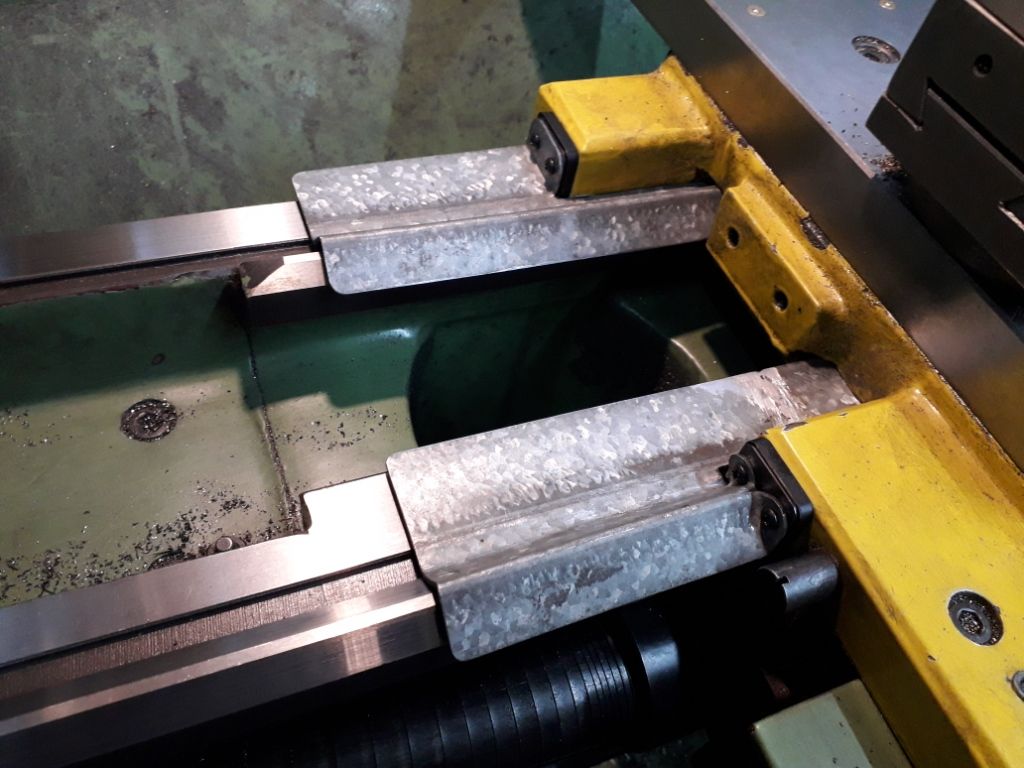

              Henry Brown
                @henrybrown95529
                I kept the standard wipers and fitted a couple of home made extensions as the photo. Under the free end I put a strip of 3mm thick rubber to act as a primary wiper. I made these because most of the swarf and muck falls straight down into this area, I've seen similar on industrial lathes, and felt that some protection would be worthwhile. I did it a couple of weeks ago and they really do work well.slide covers 2.jpg

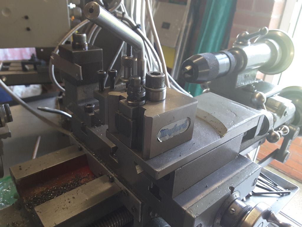

                duncan webster 1
                  @duncanwebster1
                  Posted by woody1 on 14/12/2020 20:13:46:
                  Evening all,
                  ……. I have my compressor and blast in between operations, ……..
                  Woody.
                  aaaagh nooooooo! Vacuum by all means but blast forces muck into small gaps.
                  I have a tray fixed to the front of the saddle of my myford which catches most of the swarf, and a backplate arrangement behind the milling machine vice which deflects chips away from the Y axis slide at the back
