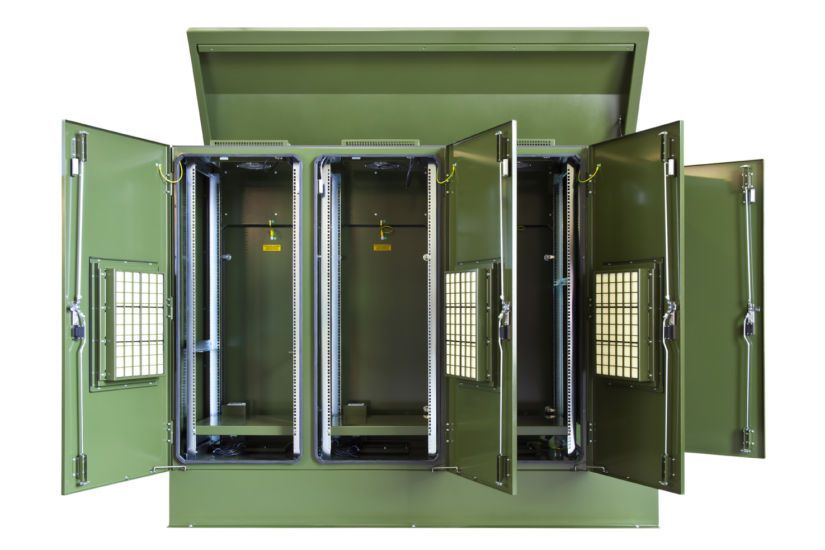

      I'm looking to site my Transwave rotary converter out of my workshop. Firstly I don't have a suitable floor space for it and secondly, if I put it anywhere else, the vibration is too much – ie on top of a cabinet or on a shelf.
      So the thought was to site it outside in a waterproof box or cabinet.
      Anyone got any thoughts on this? and, of course, where I may get one!

          How about a box from this lot. I think the hard part will be wiring it up. The regulations were tightened sharply a few years back. I expect one of the electricians will know.

                      Keeping the rain off and stopping fog and temperature changes making the guts damp are different things. Electrics don't like damp, especially 400v electrics.

                        If you put it outside you may have to put in a small tubular heater and thermostat in the enclosure to keep condensation at bay, have done similar for compressors etc in the past. You can wire a cooling fan if necessary to cool down equipment as well. We just knocked up a wooden and board structure with plenty of room and loovered door

                              It has to be said that every cable company, no matter who built the network does exactly what is being discussed in their streetside equipment cabinets.
                              They all have mains in them and they can all be touched by the public.
                              Some get slugs crawling over the cct boards wink.
                              Nothing dies except the slugs and I don't believe any cabinets catch fire.
                              The worst thing that happens is single skin ones bake in the summer sun, which kills the batteries.

                                      Cable cabs don't have mains or even the ELV, it's normally 48v, and all the electronics are in sealed boxes. The telephone wire terminations are the only exposed elements which is why they can suffer from noise on the line.

                                        I suppose it depends how much you want to spend.
                                        Here are links to 2 suppliers of steel cabinets:
                                        Ritherdon
                                        Glasdon
                                        Or you could make a brick cubicle with a concrete flag as a roof.
