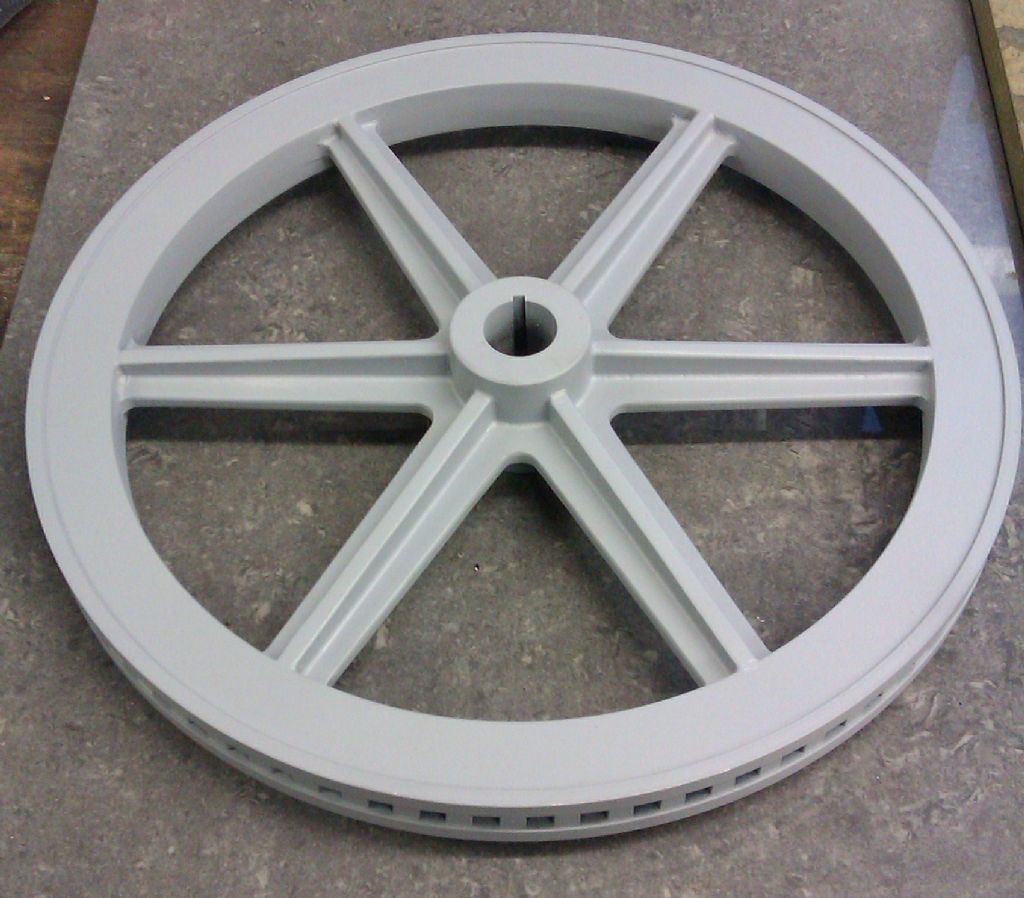

      You may recall that Neil ( Stub Mandrel ) posted this thread a while back about lazer cut flywheels, well I've just done one with water jet cut parts which may be of interest.

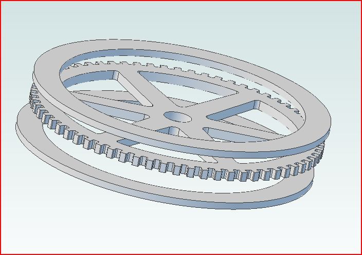

      As some of you know I'm building a larger version of Anthony Mount's Easton and Anderson Grasshopper engine which should have barring holes in the rim and + section spokes

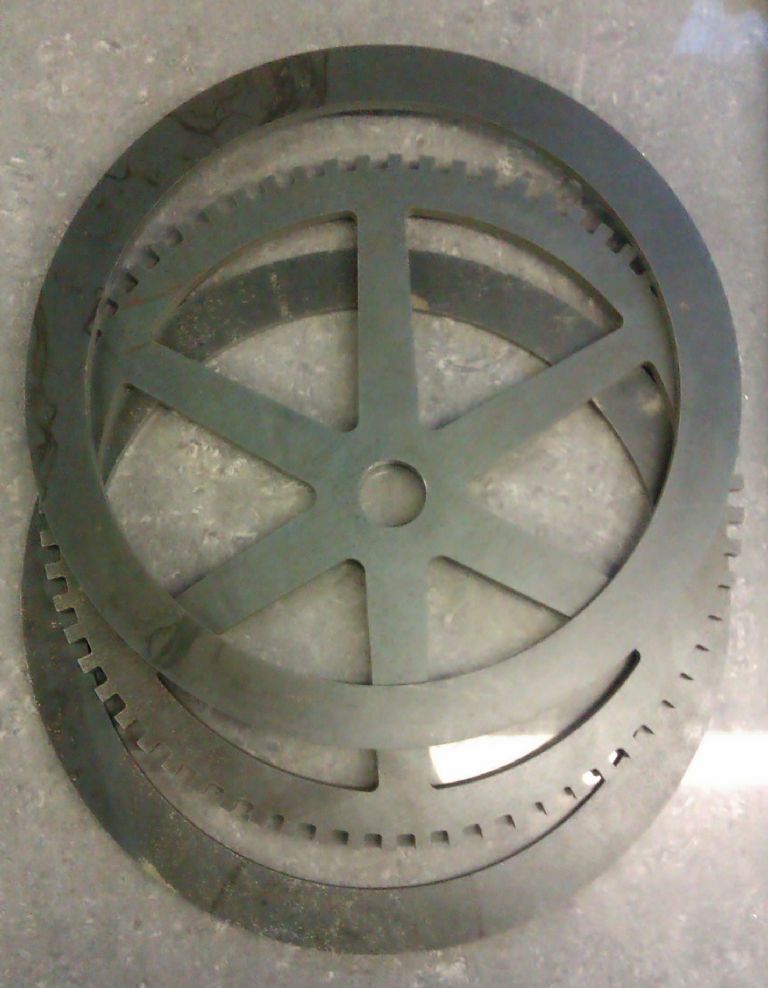

      I e-mailed .DXF files of these parts to the water Jet cutters (Sciss)
      And this is what I collected a few days later

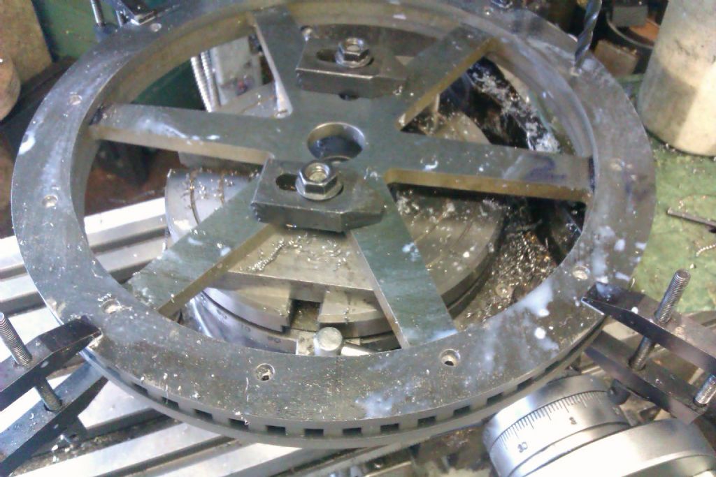

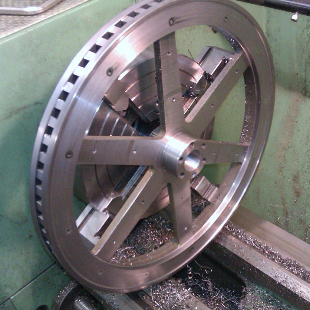

      Add a few screw holes to hold it all together

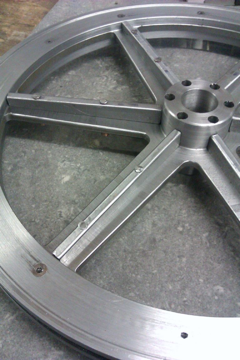

      With a hub added it was trued in the lathe and the spokes reduced in thickness from 8mm to 5mm

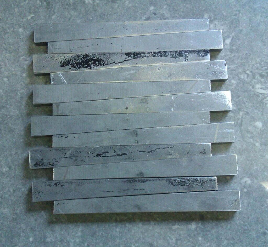

      The spoke webs were a bit pricy so I cut my own
      And rivited them into place
      All the internal corners were filleted, keyway broached and a quick spray of primer

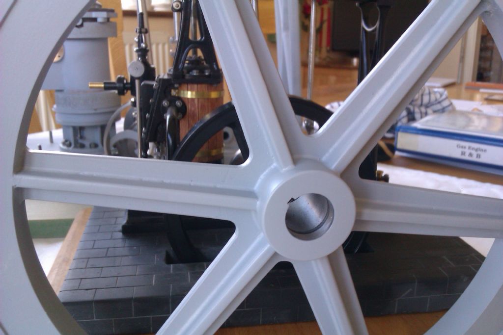

      And just for comparison here is fellow member Jo's nicely machined one looking through my flywheel

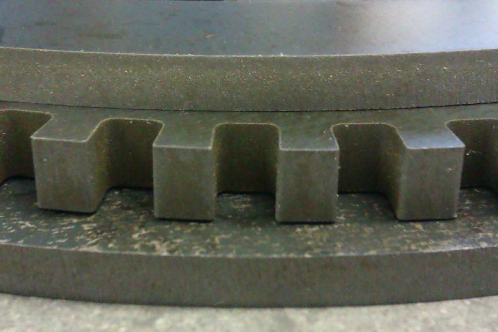

            With water cutting I assume there was no hardening of the steel.
            #111907
              No thats one of the reasons that I went for it, machined a treat even on the 10" outside diameter with no backgearsmile p
              There is a slight draft angle, if you look at the MEM thread there is a picture that shows a bit of light shining through between the edge and a square
