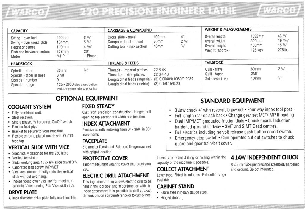

        Hi new to this forum. Can anyone tell me the length and the weight of a warco 22 please. Not sure if I got a bargain or not but just got one for £400.

                Hi Vernon, this scan should help.
                Warco 220
                I don't know how heavy the stand is exactly, but two people can move it easily, the cabinet part is 845 x 410mm including the door and is 865mm to the top of the tray, the tray being 910 x 465mm.

                    At 125 Kg it is going to be too heavy for lifting by just two people.
                    If you use an engine crane to lift the machine, it looks as if the Sling would need to go behind a firmly clamped Tailstock.
                    I don't like suggesting it, but the sling looks as it it will need to be behind the chuck.
                    Positioning the Saddle can be used to help balance the machine fairly level.
                    Alternatively. for some lathes, (including my 300Kg machine ) it is suggested to fix a clamp to the bed, suitably positioned for balance, and hook then crane onto that.
                    It looks to be a deep bed casting, so should be reasonably free of twist.

                      As I said, based on experience, take t/s off lathe and lathe off stand, 2 people can move reasonably easily.

                            Hi, 125Kg between two reasonably strong people is easy enough and there was only the guy I bought mine off and myself to carry it from his shed, through his back gate and on to my trailer, neither of us had to struggle with it and I had the headstock end and the tailstock was still on, use a decent pair of leather gloves and it won't dig into your hands.
