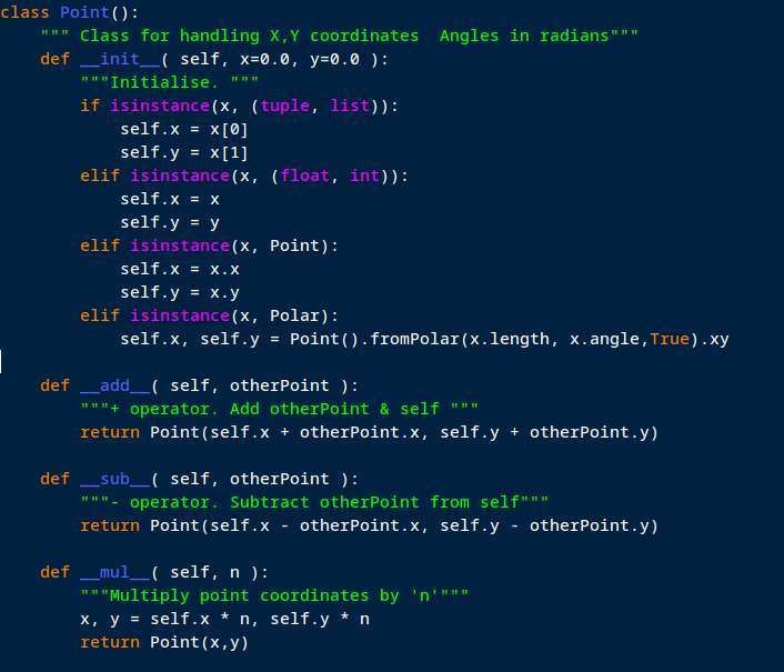

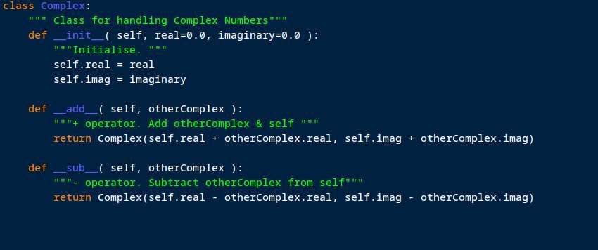

Might help to see how a computer language that supports classes might handle Complex Numbers and Points under the bonnet. A class is a user defined type, that can be added to extend the language and make the code easier to understand by hiding implementation details.
My point class was developed to support 2D graphical applications. X,Y coordinates are handled as a unit, and the class overloads the usual mathematical operators accordingly. This is a snippet showing new Points can be created from x,y, or a list, or another Point, or a Polar. The code needed to do +, – and * is shown.
Given the class has been defined, the programmer can write:
a = Point(100,200)
b = Point(200,333)
c = a + b
Minus can be implemented to give distance between rather than another point. Either the straight-line distance as the crow flies or the Manhattan distance, which is the sum of distance along and up, when diagonal movement is forbidden. Both are valuable when computing cutter movements in a CNC system; moving the cutter the shortest distance is great unless it crashes into the job, in which case Manhattan can be used to steer around obstacles.
Complex numbers are rather similar to 2D Points, but the rules differ. This example shows similarities! Many differences as the class if developed. I don’t think it makes any sense to take the square root of a Point, but it is useful to compute the square root of a complex number. Including support for the square root of -1, which is a floating point error (NaN, Not a Number), but legal in Complex Number maths. Makes my head hurt!

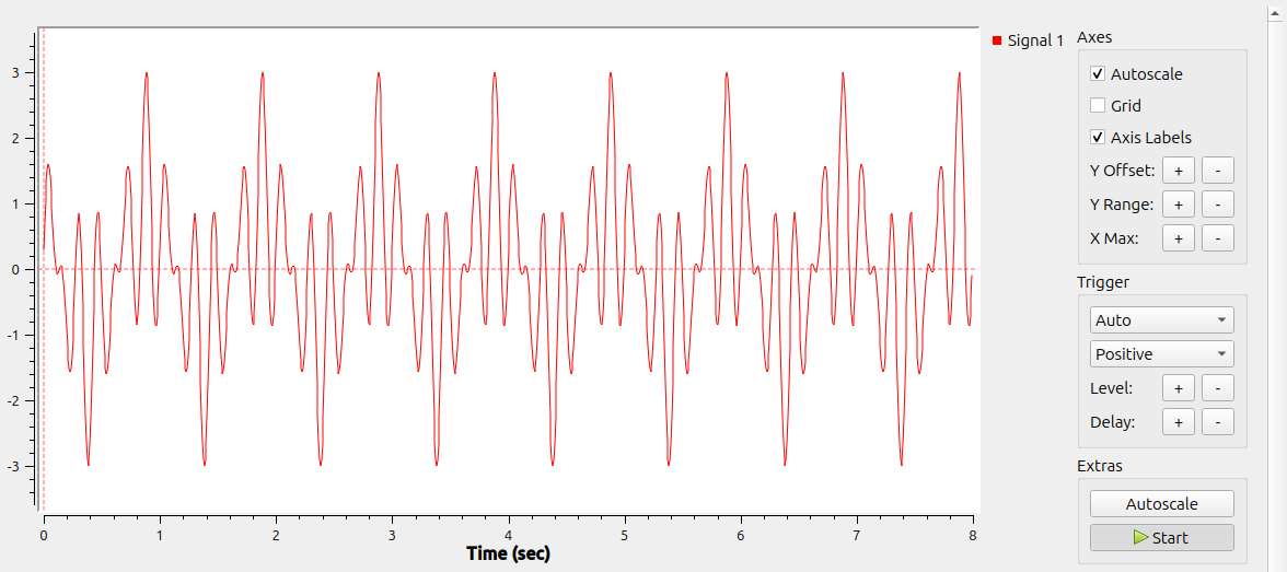

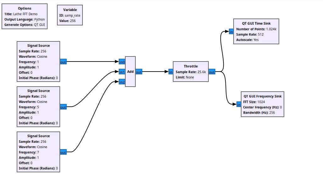

Back on topic, I’ve found that double-clicking on an Instrument Block opens a tabbed window. The config tab allows a Control section to be added, and this can be tweaked to improve the display when the defaults aren’t right. This gives a better time view of my 1Hz + 5Hz + 7Hz test mix:

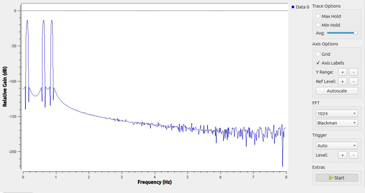

Reducing the sample rate down to 128 per second produces a clearer Frequency Domain. The example is displayed ‘Half Spectrum’:
The 1Hz, 5Hz and 7Hz spikes stand out. The x-axis scale is better, still wrong. More work!
The control panel lets me switch FFT windowing options on the fly. Now possible to see which one looks best, even if I don’t understand why yet.
Progress, not quite as foggy as when I started!

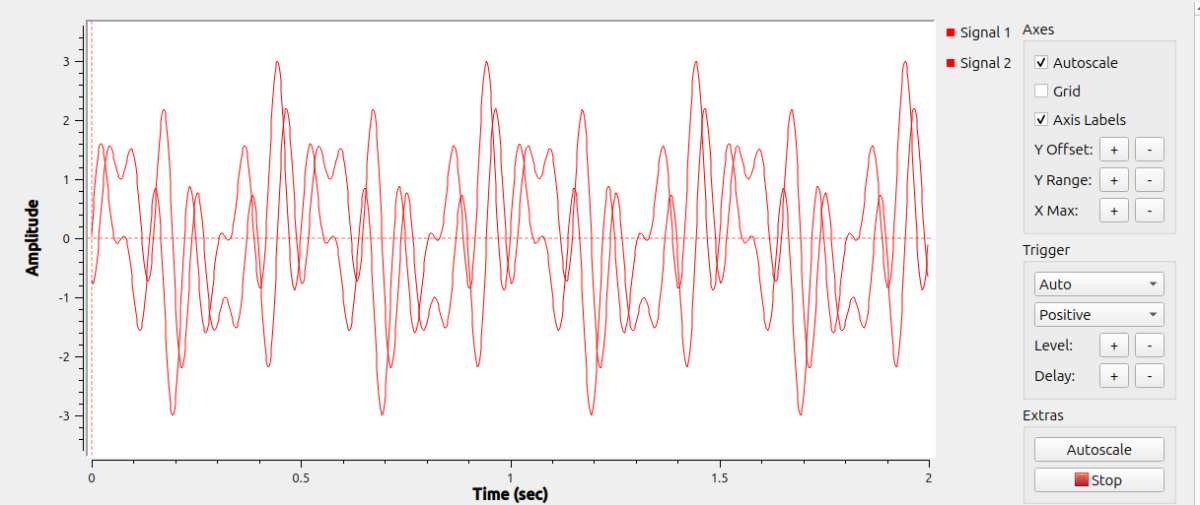

I altered the model to use Complex Numbers throughout:
Now the time display has two signals, presumably real and imaginary, and they’re a bit different. Hmmm.
The Frequency Domain scales correctly, and the peaks are at 1, 5 and 7Hz as expected. Oddly. the option to only graph positive results disappears when the input is a Complex Number stream, I don’t know why?

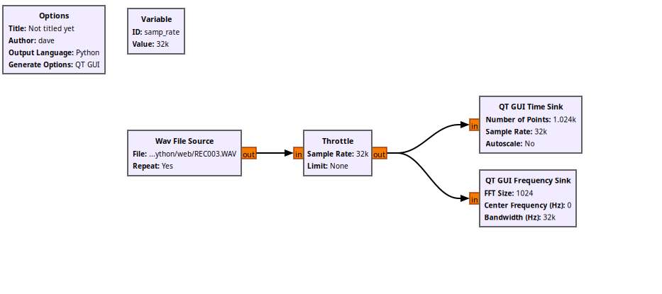

The model:

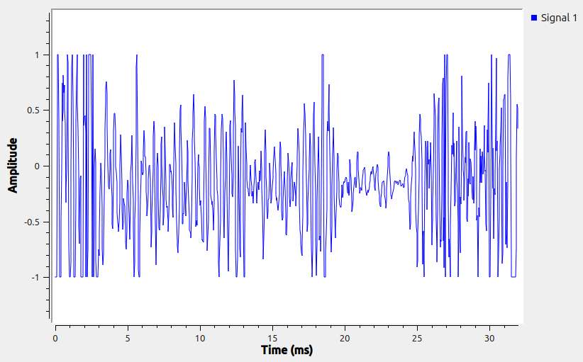

The squealing fan waveform:
TThe squeal frequencies are all dirty harmonics of 560Hz, the loudest being 1.68kHz. No need for a spectroscope, that it’s due to the VFD fan was bleeding obvious!

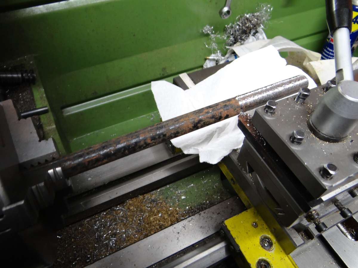

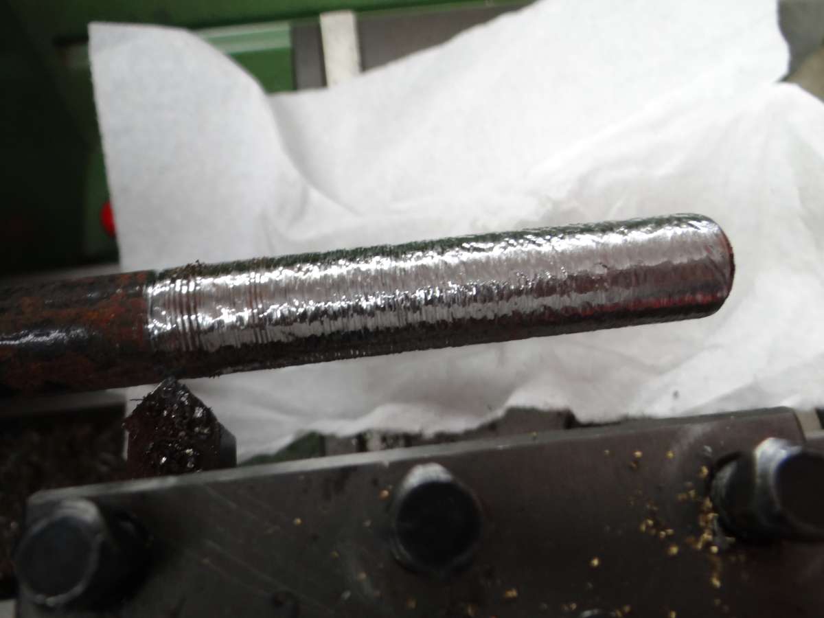

Next cutting metal, incompetently. 250mm of ⌀15mm welded gas pipe protruding unsupported from the chuck, and attacked with a blunt square insert, the saddle traversed jerkily by hand. Made a horrible noise.

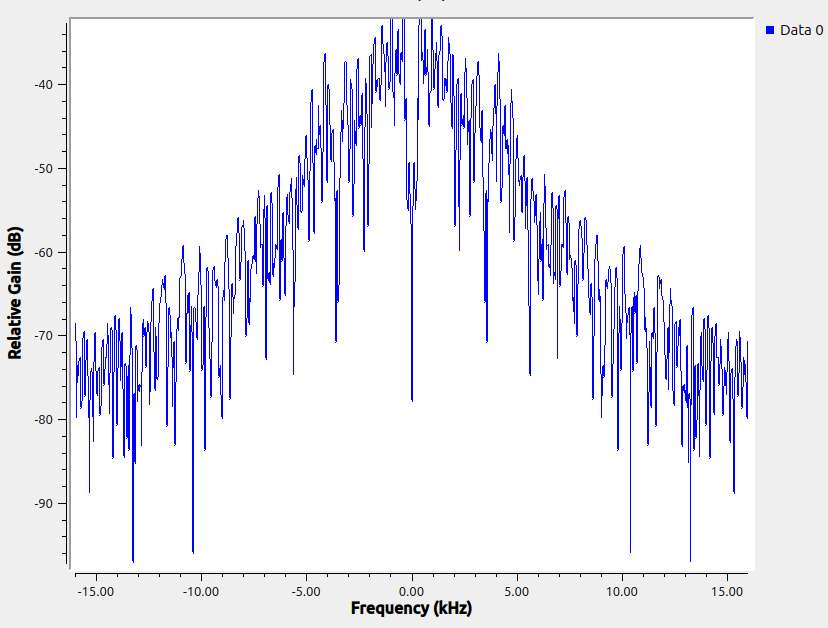

Nigel thinks he has a banding problem, see this mess!
The waveform is messy too!
And the spectrogram shows dozens of frequencies. Too many to identify by hand, but can be done with a program.
Again, no need for electronics and software to identify root cause here, it was me torturing a lathe! But the example shows an ordinary microphone on an ordinary MP3 player successfully picks up audible vibrations. Have to think of a way of getting my lathe to vibrate at low frequencies to test if it can record them.
