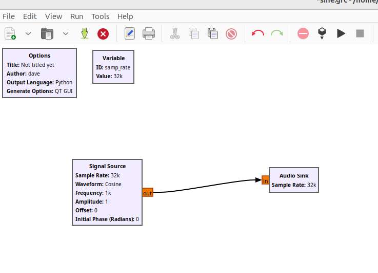

      The tool is the GNU Radio Companion.  Free, and no programming required – models are created by dragging and dropping function blocks, and then linking them.  Download from here.

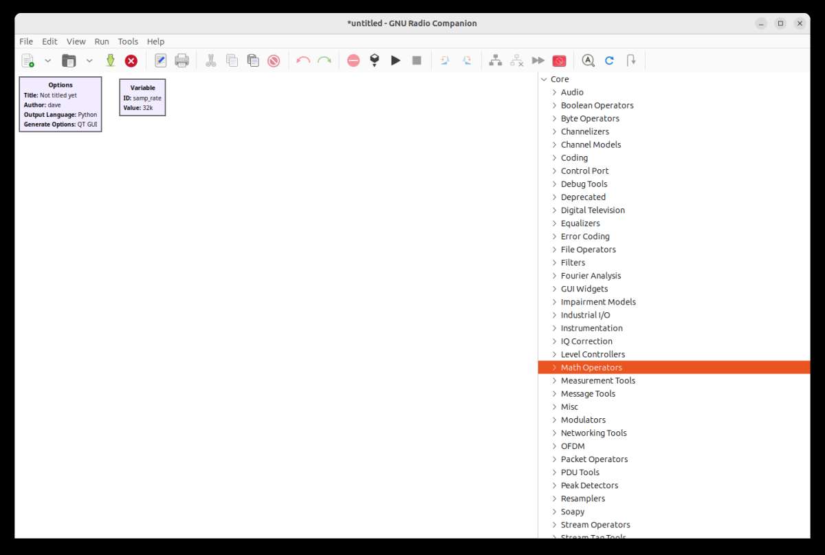

      When the tool is installed and started, try this:
      Should open a screen like this.  On the right, is a list of available function blocks.
      Screenshot from 2025-03-05 19-53-30

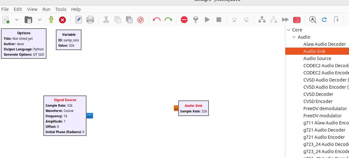

      Go to the Waveforms section (bottom of list), expand it, and click on Signal Source, hold the button, drag left and drop.  The box can be moved about later.  Then go to the Audio Section and drag and drop an ‘Audio Sink’.  Should get:
      Screenshot from 2025-03-05 20-01-38
      Note Signal Source has a blue out box and Audio Sink has an orange in.   Blue means ‘complex number’ and orange means ‘float’.  A booby trap because they aren’t compatible, so double click on Signal Source and change its Output Type from complex to float, making both out and in orange:
      Screenshot from 2025-03-05 20-06-42
      Then move the mouse onto Signal Source out, click hold, and drag the resulting arrow ended line onto Audio Sink in:
      Screenshot from 2025-03-05 20-08-27
      This models a 1kHz audio oscillator connected to the computer’s sound card.  Pressing the black triangular Play button top right on the tool-bar should activate it, making an annoying whistle.   No programming, soldering transistors, or plugging in cables!

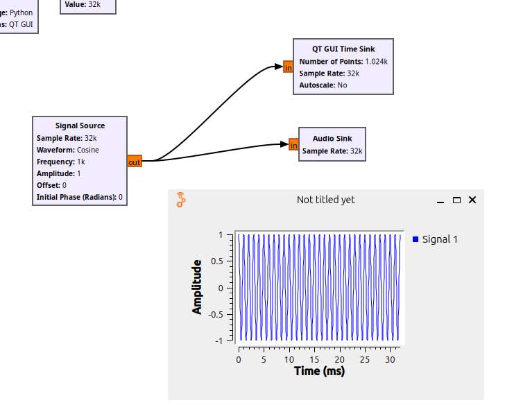

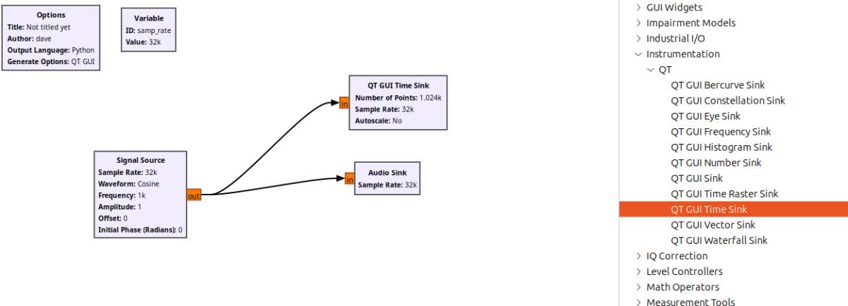

                      Back to scene setting before I tackle FFT though.  Yesterday’s example showed how to output a sine wave to the sound-card, but that’s not useful here.  Just a demo.   What’s needed is a graphical oscilloscope display, and this is found in the Instrumentation list.
                      Drag and Drop ‘QT GUI Time Sink’ onto the main page.  On my machine it defaults to Complex (Blue) input, so double click and change it to float.  Then connect the Signal Source to it, giving:
                      Screenshot from 2025-03-06 10-08-22
                      Playing the model displays the waveform:
                      Screenshot from 2025-03-06 10-10-16
                      I’ve added an oscilloscope!  Though the Audio Sink could be left in parallel, it’s annoying, so delete it, unless listening to the output helps.

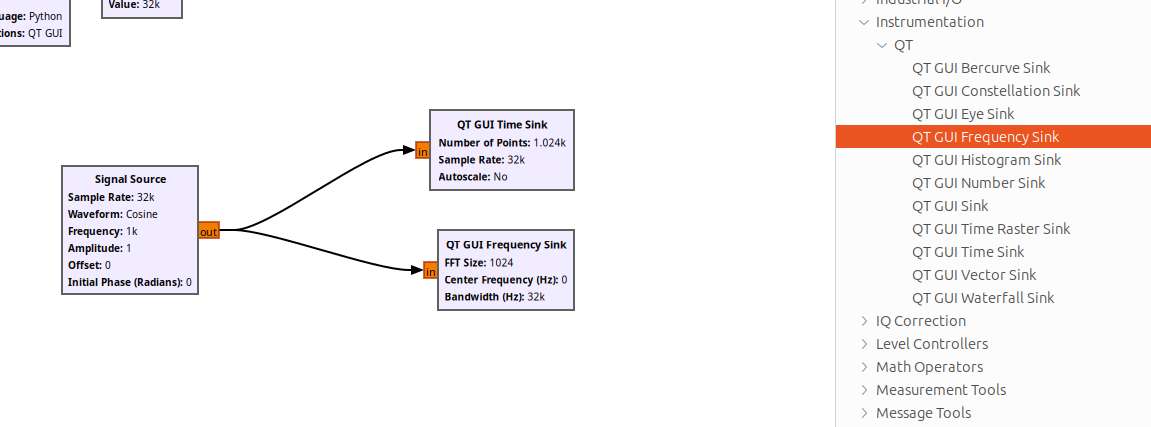

                      Then drag and drop ‘QT GUI Frequency Sink’ from the Instrumentation list, configure it for float input, and connect it:
                      Screenshot from 2025-03-06 10-18-44

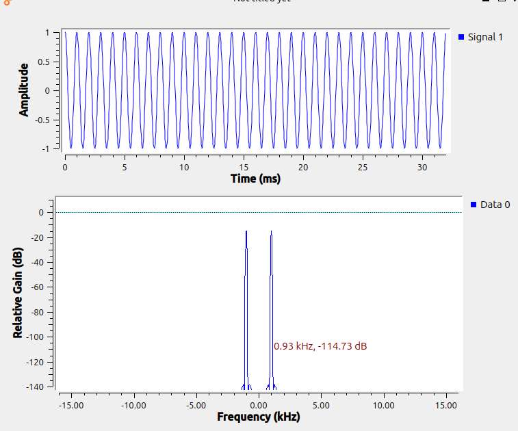

                      GUI Frequency Sink applies FFT and displays the result.  FFT generates a positive and negative result, so two spikes expected.  (GUI Frequency Sink can be configured to show only the positive result.)
                      Screenshot from 2025-03-06 10-17-58
                      Now the instrumentation shows a waveform in the time domain as an oscilloscope does, and the frequency domain extracted by FFT.   The frequency domain identifies the frequency and amplitude of the signal.  Roughly hovering the mouse on the positive spike says 0.93kHz, which is close to the 1kHz input.  Hurrah, this works!   But it’s only on one signal, and I need to identify several frequencies.  More work needed.
                      Instrument displays can be zoomed, doing so allows me to see FFT correctly puts the peak at 1.0kHz.

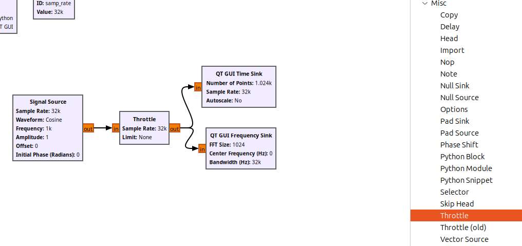

                      There’s a practical problem.  Running the model eats 100% of a CPU, so the cooling fans come on.   Reason, I think, is that the Audio Source is a short loop of code generating the numbers representing a sine wave running flat out continuously.   Real audio input is much slower, constrained by the microphone.   This being a simulation, it’s necessary to throttle the racing Audio Sink, for which purpose there’s a Throttle block in Misc. Change the model to:
                      Screenshot from 2025-03-06 10-39-22
                      Now, the fans don’t come on!   Why is the throttle set to 32kb/s?  Seems to be a compromise.  Too slow and the model becomes sluggish, too fast and the CPU gets hot.  16kB/s is fine, but 8kB/s causes a noticeable delay.

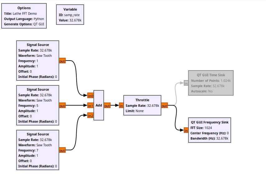

                          Moving on, here’s my first wild attempt at simulating a vibrating lathe.
                          I believe most lathe vibration due to worn bearings, set belts, bent lead-screw, worn rack / half-nut and loose gibs are all low frequency and hard to identify.  High-frequency squeal is likely more obvious: seized bearings, cutter vibrating due to being off centre height and such.
                          Does this analysis make sense?
                          Assuming a motor rotates properly at 3000rpm, it would vibrate at about 50Hz.     Conversely, a knackered ball-bearing in the motor, would vibrate at 50Hz x the number of faulty balls or less depending on how the race is brinelled.  Perhaps 50Hz x 20 = 1000Hz.
                          A flexible belt in good order would tend to stop motor vibration reaching the spindle. A set-belt (stiff at two points) would halve 50Hz vibration at the motor to 25Hz at the small pulley.
                          The spindle typically rotates at less than motor speed, so less than 50Hz, unless a bearing fault multiplies it.
                          The change gears and gearbox are a rich source of vibration.  All those crude teeth meshing and maybe with a maladjusted mesh. I might run the permutations later.  However, in general, these gears turn the lead-screw slowly, so rack, lead-screw, half-nut and gib problems should all be well below 50Hz, especially on fine feed.

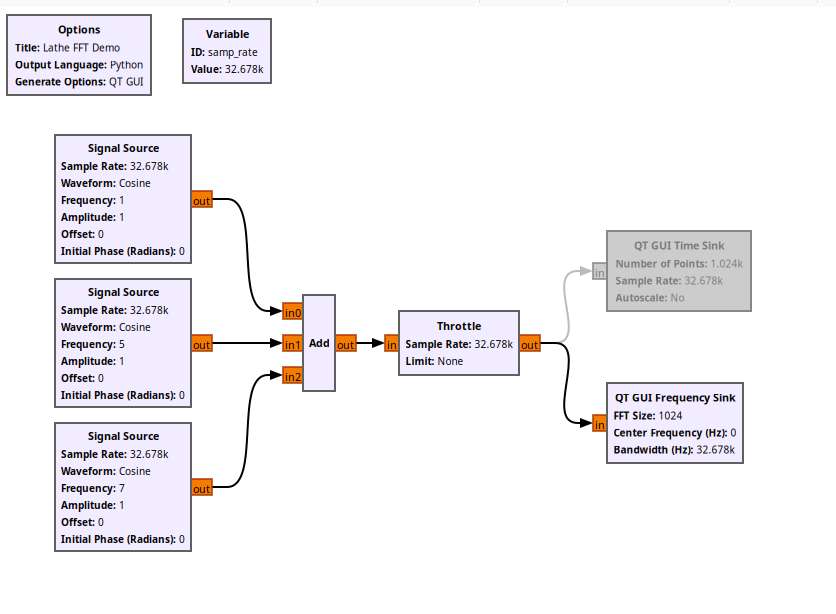

                          For the moment I’ll model 1Hz, 5Hz and 7Hz.  Don’t take these values too literally – just examples for testing.  But if anyone knows the frequencies faulty lathes really vibrate at please say so!

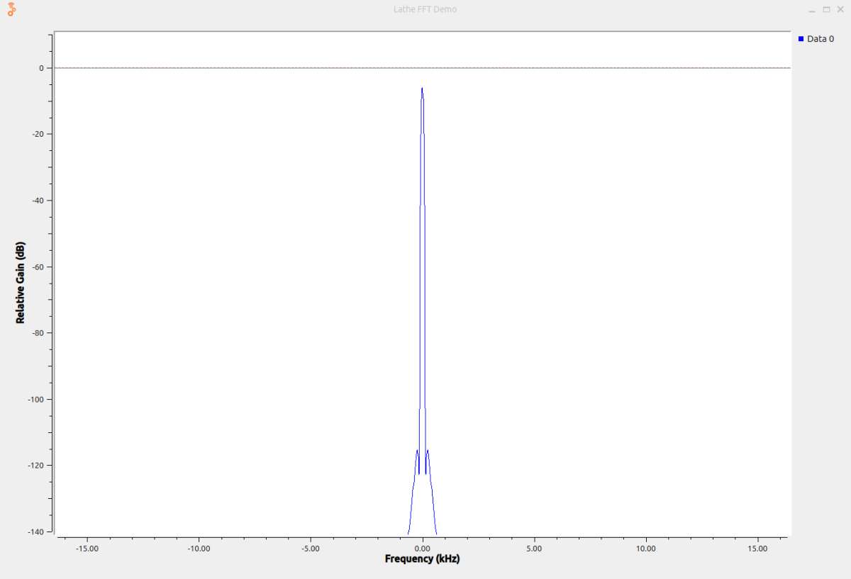

                          Anyway here’s the Mk1 model.  Three signal sources at  1Hz, 5Hz and 7Hz are added together and then FFT applied to the mix.  The oscilloscope is disabled temporarily (greyed out) to get a big frequency display. It’s the FFT result that matters.
                          The model, using default sample rate and other settings:

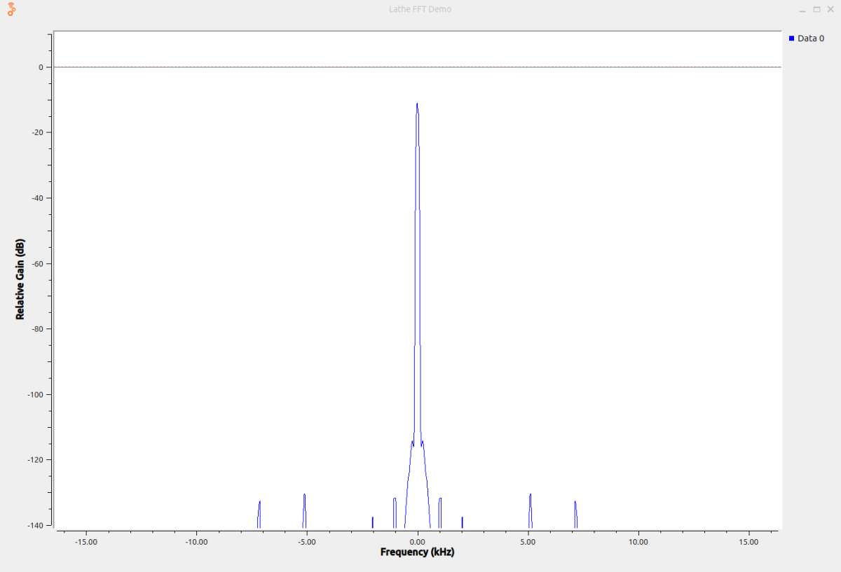

                          Screenshot from 2025-03-06 11-46-25
                          Sort of works, but the scale looks wrong by a factor of 1024, and the display is noisy.  Big DC spike at 0Hz, the signals are low, and there’s an unexpected spike near 2Hz.
                          Screenshot from 2025-03-06 11-44-10
                          My guess is the default values in the blocks aren’t a good match to the input signal. The scaling error is a clue.   Possibly set for frequencies typical of radio and audio applications.  I shall have to try tuning them.
                          My belief is that digital signal processing works on streams of numbers arriving at a given sample rate.  This works in conjunction with other parameters to get the desired result, and I don’t understand the relationships.   I’m roughly equivalent to a learner driver attempting a hill start in 5th gear, without knowing why that’s wrong.

                                                      […] For the moment I’ll model 1Hz, 5Hz and 7Hz.  Don’t take these values too literally – just examples for testing.  But if anyone knows the frequencies faulty lathes really vibrate at please say so!
                                                      For most vibration analysis, levels are expressed in ‘g’ and the relevant physical displacements vary enormously with frequency … I predict that you will have great difficulty in extracting useful low frequency data from a noisy beast like a lathe.
                                                      Is g amplitude expressed relative to the acceleration due to gravity?   And if so, is there a practical reason for using g?  I suspect g facilitates the maths sense in a mechanical world, where metal objects are moving, how much and how quickly.   My experience of waveforms comes from electronics and amateur radio, where it’s convenient to express amplitude in decibels (like g but relative to a voltage or watts reference).
                                                      At the moment I’m concentrating on frequency and ignoring amplitude.   FFT extracts amplitude too, so I’m hoping the size of a frequency spike on the graph will decide if it needs investigation.  (Guess: only big spikes are bad,)   As the detector is electronic, I’ll stick with decibels for the moment.
                                                      Thanks for the hint about the difficulty of extracting low frequency data: you’re probably right!  Robert suggested: For a DIY pickup rather than a microphone the “speaker” from a pair of cheap ear-buds works well and even better if you add a bit of mass to the center of the diaphram. A small nut fixed with something flexible like contact adhesive works well.
                                                      I’m some distance from processing real data:  have to get FFT sorted first, and it’s easier to explore it with a mix of known frequencies.
