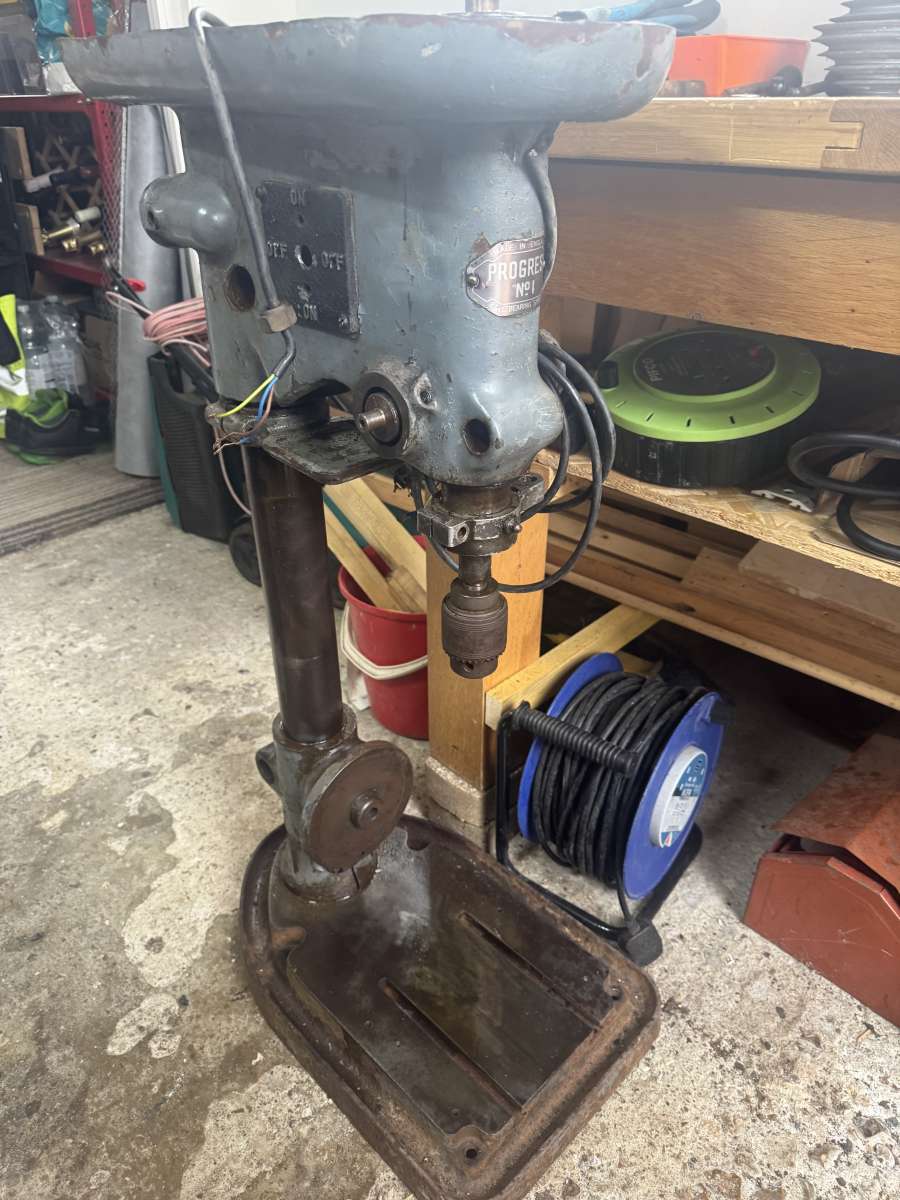

      Good afternoon all,
      we you can see below I am part way through the strip down of my progress no.1 drill I believe a mk.2 after looking on lathes.com
      however my quill is absolutely solid as is the work bench slider below
      best suggestions for freeing these up very welcome I have hammers wood fire and a 100T bearing puller wish me luck
      Thank you
      Jack
      IMG_5284IMG_5283IMG_5285

        Maybe destroy the bearing cage and remove then fill with some freeing fluid of some sort, Plus Gas etc.and be patient. And by the look of the inside of the casting its been full of water at some time

          Try to remove the cross shaft which the handle and return spring fit on first. The gear teeth which mesh with the quill will likely be straight, so careful drifting with a brass or aluminium bar should move it. I cannot see which way it should go, but there should be clues if you look carefully. Also, there should be a screw to stop the quill rotating, probably on the right side of the main casting which needs to come out, and will provide another entry point for the Plus Gas.

            So here is a much overdue update on the progress of my progress or should I say lack of.
            I have been unable to free the headstock from the pillar
            I have been unable to free the work piece holder from the pillar
            I have been able to free the quill
            most annoyingly I have been unable to remove the taper pin form the RH side of the
            All of these have basically bought the project to a stand still
            In good news I have deep cleaned and got he electric motor working

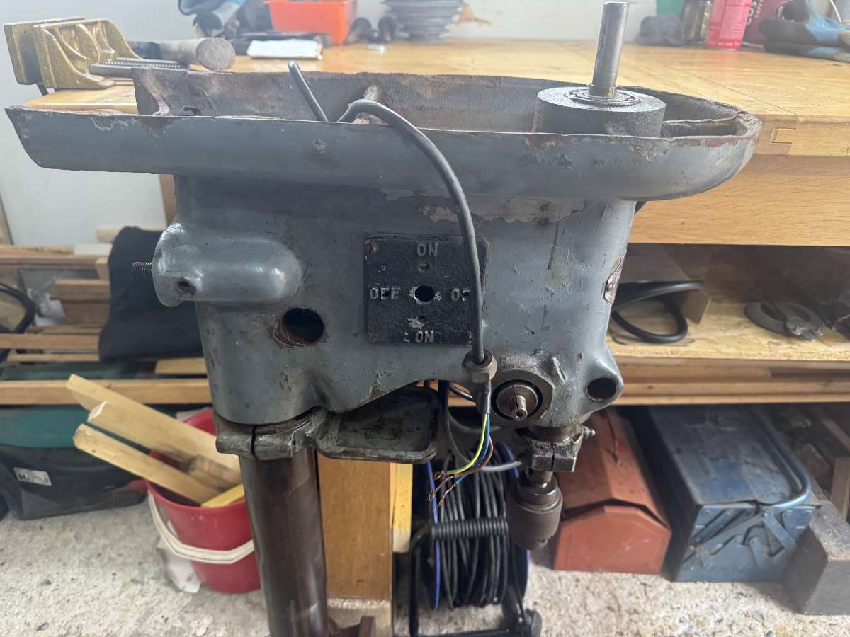

              Remove the switch/wiring/other combustible parts & get a blowtorch on the head clamp area, until it’s ‘smoking hot’.
              The top of the pillar looks ‘beaten’ – you might have to push the head down a bit first and remove any burrs before it will come off the top.
              Then the key tray.
              Then the table swivel.
              If it was mine, I’d bolt the base to the floor so there was a solid foundation to work from, one can then twist the head to and fro and ‘work it’ a bit, etc..
              Are you sure you are hitting the taper pin from the right end – it’s not always easy to tell, if they’ve been around the block a bit..
              #813637
              Adrian R2
                @adrianr2
                It’s going to need something bigger than a plumbers torch to get enough heat into it I suspect – perhaps one, or even two, of the yellow MAP kits from Screwfix etc?
                I agree on bolting it down, plus a get a smaller steel pipe to put through the centre as a kingpin and a 3ft lever to apply torque to the head once hot.
                Do a dry run cold first, wear PPE and and take fire precautions.

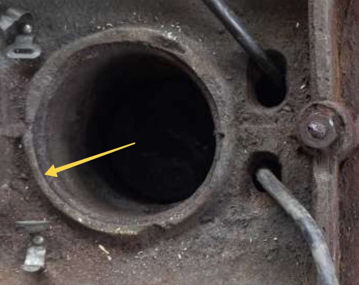

                  My own use of PlusGas tends to be on smaller items, but the general principle is universal:
                  It needs to seep into the joint by capillary action, and the best start for that is to clean the area where it will be applied.
                  It seems reasonably clear that the column of this drill ends slightly below the head casting [yellow arrow] … so get a scriber into that corner, and clean the debris out.
                  Then, and only then, apply PlusGas in small quantity, all the way round and let it seep-in … repeat periodically !

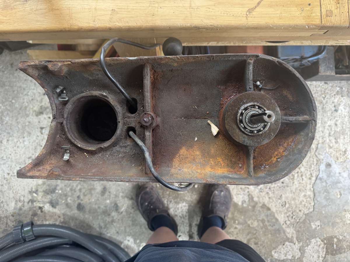

                    If the quill is starting to move, can you drop the whole assembly downwards? If the top bearing is holding things up, it would be asyto destroy the bearing cage and remove the ball bearings as Bernard suggests. The inner race looks to be a smaller diameter than the quill bore. Things should be easier with that out of the head. You can read the bearing numbers off the races and sellers like “The BEARING BOYS” can supply imperial sizes. You will probably need all three bearings.
                    I cannot see where the taper pin is that you are having trouble with.

                        If your any where near me ( N Norfolk )Then bring it over and I will put oxy propane on it, it will soon come off. I have numerous hydraulic devices for pulling or pushing things. The intermediate table support, push a tapered chisel or wedge in GENTLY to the split to open it up slightly, it should easily free. The top/ head may be grub screwed to the column. Noel.
