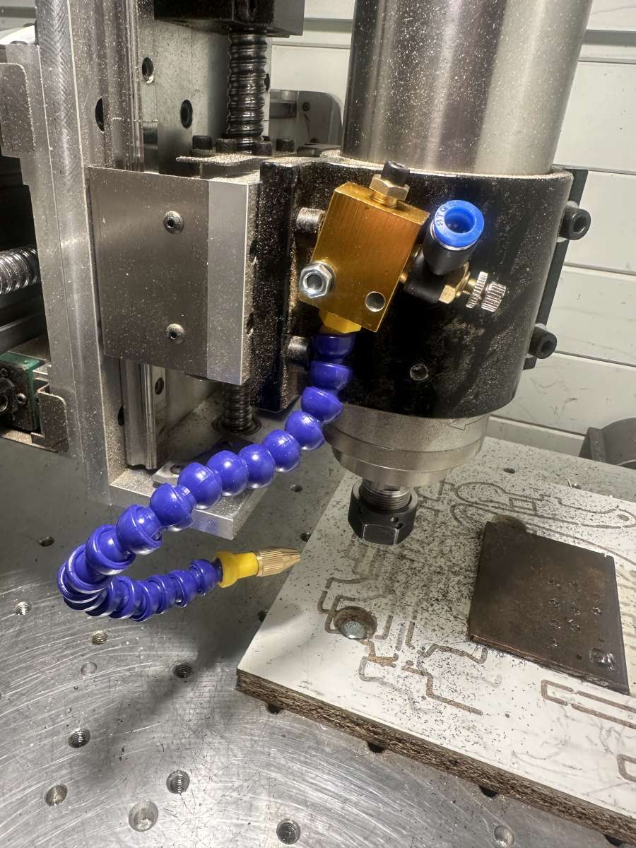

                  Does anybody have any thoughts about the fittings to plumb a compressor fitting onto a 8 mm air pipe? (I think – it says 8 on it)
                  I’m guessing I’m gonna end up with a block of aluminium screwed to the wall somewhere near my CNC machine, which will have a compressor fitting on one side, and an air hose coming out of the other side?
                  Furthermore, does anybody have any advice about the best air compressor fittings? There are a myriad of different ones, I’ve always wanted to settle on one system for my workshop, but I always end up messing around with them because different air tools come with different input fittings.

                    Simple connection would be  a QR with a 1/4 BSP male screwed into an 8mm pushfit with 1/4 BSP female and that will join the two.
                    If it is a manifold then tap it 1/4″ BSP and screw in a male QR fitting with 1/4″ bsp male end as the inlet. ( you want female QR connectors as outlers to compressor and compressor hoses as they shut off the air).
                    Outlets tap the block to what you fancy – 1/4 or 1/8 BSP, M10 or M8.
                    If you want to regulate separate outlets then the banjo type flow regulators with a thread to suit your chosen tapped hole and 8mm pushfit outlet. Unregulated then just a straight male thread to 8mm pushfit.

                      #809842
                        That’s it, screw a male QR into that which will plug into the hose or compressor. Other options I mentioned also shown below

                          Do a material test with the coolant to see if the brass is going to make the coolant turn green.
                          From  Memory HysolX is just fine. I mix at 10-12 %, Work is using Blaser fluid.
                          I do like the look or clarity of the Blaser full synthetic coolant. It is a pro biotic coolant. Very different to that of Hysolx.
                          I only use the IPA hand gel where for what ever reasons, the surface finish is not as expected. It just gets a very thin brushed on amount.
                          There are companies that do use IPA as a cutting fluid. They use antistatic hoses, and it has a water mist that is injected into the vac hose. The mister nozzle looks very similar to what Jason posted.
                          For the cnc router I use a mister and the Blaser CFS35 oil in combination with shopvac system. The shopvac has a cyclon between it and a 20 l catch can. The combination of the blow and vacuum to control chip evacuation works very well.

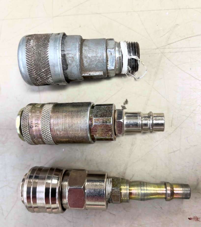

                              Concerning connectors this picture shows the two common general purpose quick release airline connectors. I had both types floating around and made adapters as a temporary measure pending exploiting very attractive LiDL prices for Euro connectors to convert everything to Euro. As ever temporary became permanent and mumble-mumble years on I still have a mix.
                              1) Fittings
                              Bottom is a Euro female to PCL male adapter. Note the bulge in the main stem characteristic of the standard PCL
                              Middle is a modern style PCL female to Euro male adapter. Note the parallel stem characteristic of the Euro.
                              Top is an old style PCL female.
                              Pull back on the sleeve to release the female coupling on both types.
                              Generally standard PCL females have knurled rings to assist grip whilst Euro have plain rings but you can’t assume this is true for everything.
                              Many PCL females are positive latching requiring the sleeve to be pushed forward to unlatch before pulling back to release the coupling. Generally if there is a gap between the sleeve and the connector entry, as per the middle one in the picture, it will be positive latching. Unless the system is completely de-pressurised it’s usually necessary to push the male connector towards the female one to get the positive lock latch to release. The whole point being that you need two hands to undo the connection which is obviously safer. Ageing positive latch PCL females can be a right pain to undo.
                              Euro connector has a slightly larger bore and tends to be bit easier to release. It is said they are less durable than PCL but how much of that is due to the proliferation of inexpensive import ones made to slack tolerances I know not. I seriously doubt that any member of our fraternity will use one enough to wear it out.
                              A major trap for the unwary is that PCL branded PCL-XL range connectors are Euro type not proper, standard PCL.
                              The female end is self sealing and should be fitted on the pressure side. The male goes on the tool or whatever. Should be obvious but I have encountered a hose connected the wrong way. Fortunately I had a good grip, even with only about 50 psi in it the hoes was, ahem, energetic in attempting to escape.
                              The simple nylon tube push fit types make effective quick release connections if you don’t mind de-pressuring things before you attempt to disconnect. Alternatively (better) put a tap in the line to cut off pressure.
                              I would consider a tap on the entry side of the very neat Euro inlet to multiple push fit outlet manifold pictured in previous posts essential.
                              Theoretically the push fit pipe end should be cut off and re-chamfered before re-connecting but in practice you can disconnect and re-connect several times before the nylon hose deforms where the O-ring seal(s) run leading to leaks. Industrial rated (aka expensive) ones have two O rings and are more reliable at high pressures. Watch the temperature ratings. The cheap and cheerful plastic breed don’t like getting hot. Typically maximum of 60°C. Metal bodied versions rated up to around 150°C can be found, at a price.
                              Nylon air pipe is generally stiffer, stronger and has higher temperature range than the (cheaper) polyurethane type.

                                  I’ve used PCL type for 50 years and they work well, more to the point they are available easily, well made and are reasonably priced. Whilst 1/4″ BSP is the standard thread, for larger flow there are 3/8″ and 1/2″ types, the 1/2″ are 100 series. The modern (ish ) female type have the sleeve set back so as to avoid accidental release, and ALWAYS hold the male end tight when releasing – being hit by a flailing end fitting can hurt ! As has been mentioned the PCL- XF type are euro style and will not fit standard PCL. Both male and female fittings are available in male, female and hosetail style to suit the application.
                                  On the point of compressors check out the duty cycle and cooling. One of the common brands we have will cut out on hot days if asked to run at high delivery – at least the thermal cutout works. At 3Hp and twin cylinder with a 150L tank it is NOT fit for industrial use ! If being used unattended on CNC a low pressure alarm may be a good plan. Even if fitted with a 13A plug it should be wired through a proper motor starter/overload device NOT a fuse or MCB, which will only save the wiring.  Good Luck. Noel

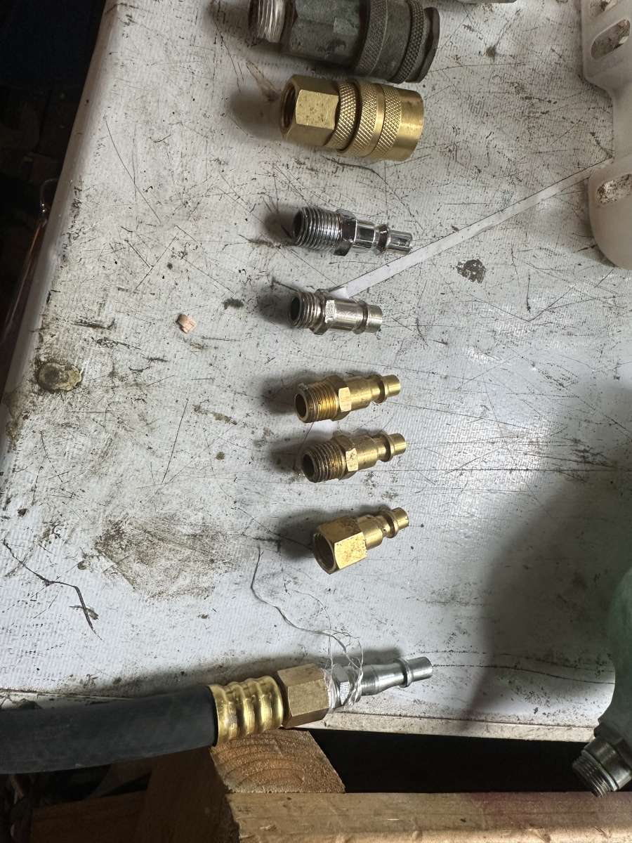

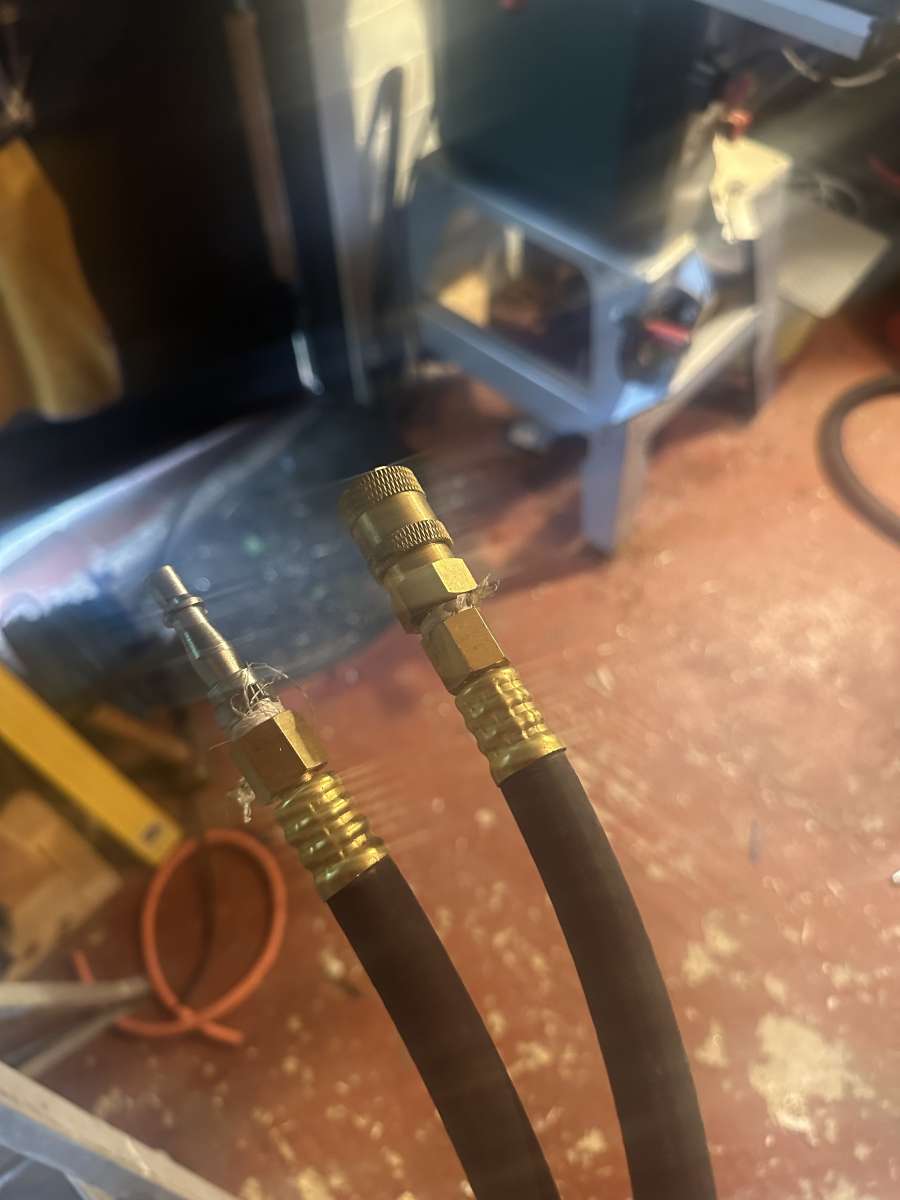

                                    Well, I went to Lidl today in search and found there none.
                                    Looking at what I have lying around, and I have at least 4 types. As far as I can tell, they are all called PCL. One way or another tomorrow I’m going to choose one type and chuck the rest out.
                                    I suppose I should  check all my air driven tools to see what’s on them too. Might be more variations on the PCL theme.

                                      Any type of air mist system ideally requires a totally enclosed machine and an extraction filter system to prevent high levels of noxious mist.  While a flood coolant is easiest a higher pressure system will clear chips from the cutting edge better, but ideally an extraction system would be best.  As a hobbyist you may be better to just use a hand spray bottle filled with a water based coolant to just spray as needed.  One objective of full coolant systems is get a long tool edge life to give a high part count per tool.  Cutting oils will differ according to the metals being cut, a general oil when used on varying metals will obviously be a compromise.

                                        Eek!
                                        PCL is a brand.
                                        They make a wide range of connectors but, like Hoover and vacuum cleaners, the brand name became synonymous with one particular style of connector. PCL Standard.
                                        Looking at the male connectors.
                                        Bottom one is PCL standard.
                                        The three brass ones look to be Euro style. Google is less than helpful at finding any official specification with dimensions but I think :-
                                        overall length forward of the nut 21 mm
                                        diameter of front parallel nose 10 mm
                                        diameter of rear parallel part 11.8 mm
                                        is correct. Too late to go out and measure one.
                                        Not sure about the other two, to my knowledge there are at least 6 connectors sufficiently similar to Euro to be confused at a casual glance.
                                        Verify your females by checking against a known male.
                                        Either type will do just fine so make your choice and stick to it.
                                        Euro has the advantage of being more likely to come as standard on an affordable air tool.
                                        Hose barb fittings in various sizes tend to be easier to find in PCL.
                                        Threaded fittings on both types are almost universally BSP but one trap is whether the thread is taper (BSPT) or parallel (BSPP). If it’s not specified it will almost certainly be taper (BSPT). Air tool bodies et al tend to be taper but if rolling your own fittings parallel (BSPT) is far more convenient. But you will need PTFE tape on a parallel thread.
                                        It’s unwise to assume that the threads on bottom of the range air tools are BSP. I’ve had some right weirdos through my hands, usually just enough smaller than BSP in a minimum metal body to make re-tapping hinkey.

                                            When the mister is correctly set, it should take at least 20 seconds to see oil on a piece of printer paper.  if you see oil before then, it is far too high of oil flow rate. Used to say that if the oil was dripping on a plate placed infront of the mister in less than 30 seconds, also too much oil.
                                            The air blast removes the chips and gives a far greater cutter life. Any vacuum system will help too.
                                            If the shop is cold, then heating the oil with a baby bottle heater to 30c or so what ever temp they heat baby drink to, does have a real effect on controlling the oil flow amount.
                                            1 drop of oil every 30 seconds or so is about right, even 1 drop in a minute is still ok.
                                            #810423
                                              I thought we were talking MQL or “Fogbuster” type systems where it is not a mist but coarser though still small droplets carried by the air not atomised in with it. These do not form a fog and you are only looking at maybe 10mls per hour of liquid being used at the most.
                                              Just looked back at an old post and for 6hrs of machining I used 40mls of fluid. No Fog, No dripping wet pile of swarf.
                                              I built my head, rare thing for me to make tooling. The liquid is pumped VERY SLOWLY into the airflow so does not atomise, mist systems are more like a spray diffuser and suck up the liquid which vaporises it into timy drops which cause the fog.
                                              I useit on aluminium to stop tip build up, air clears the chips from the immediate area around the tool, I doubt there is much in the way of cooling.
