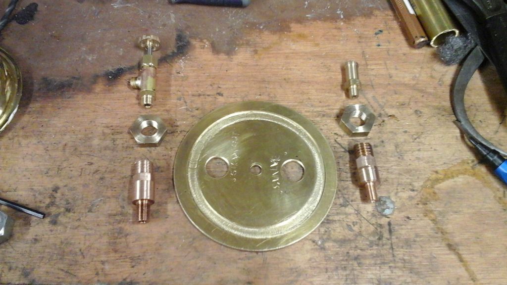

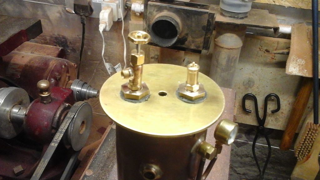

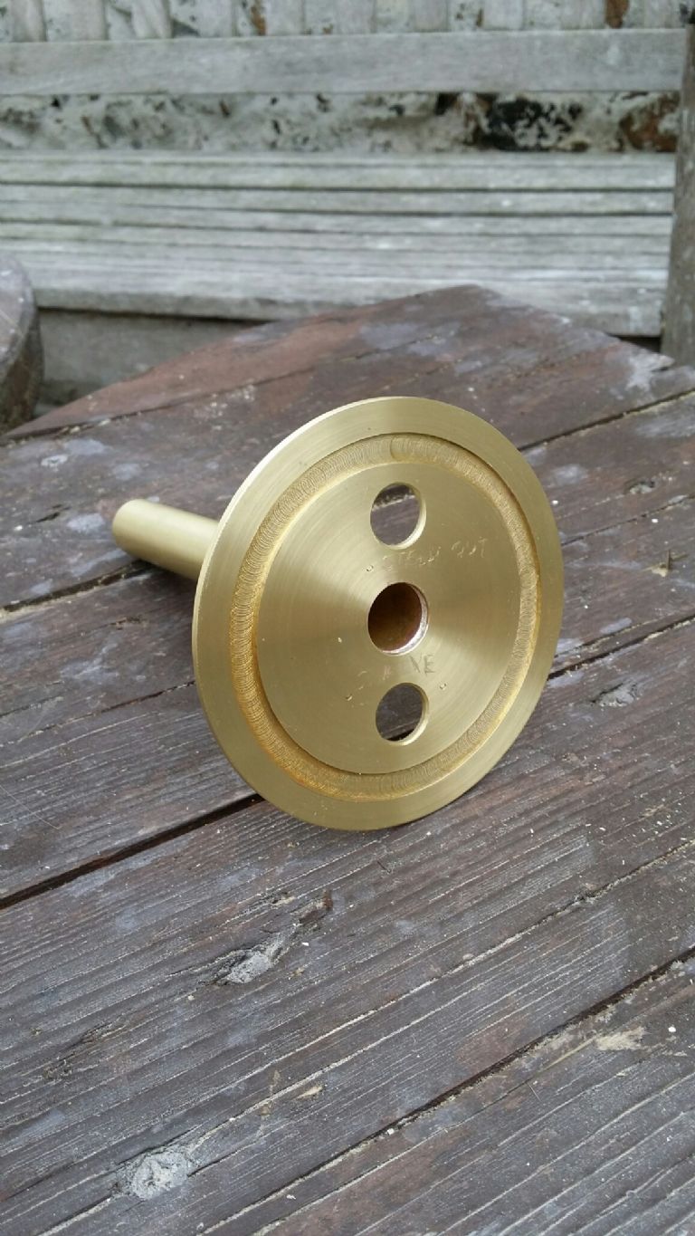

                                            Progress has been slow due to hot weather (barbie season) followed by a major renovation of our living room which is currently ongoing. However, I took today off and spent some time in the workshop.
                                            Stan Braye (on whose design this boiler is based) has little to say about he configuration of the cap, smoke stack and steam stop and safety valves, so I found myself having to figure it out myself. It was necessary to make extensions for the bushes on the top of the boiler so that the valves will sit above the cap. The first picture below shows the internal thread on one of them being tapped in round bronze bar in the lathe using a piloted spindle (which is a godsend – no more squint threads!):
                                            I figured it would be easier to gauge the required heights for the extensions if I made the cap first. The photo below shows that the underside of the brass cap has a circular locating groove into which the top edge of the boiler fits. This was milled on my Dore Westbury Mk I using a rotary table. This is not the tidiest piece of milling in the world – a result of several issues which currently beset the mill (a situation which will be addressed in the near future…). It's not critical though as it won't be seen. You will also notice that the groove is a bit on the wide side – it's the size of the smallest endmill I currently have. Below you will see the cap (in which the hole for the smoike stack has not yet been made), the bush extensions, the cap retaining nuts (made from brass hex bar tapped M12), and the two valves:
                                            The last photo shows a trial fit of the unfinished cap assembly. Unfortunately the two valves are out of perpendicularity with the top of the boiler. This happened either at the end plate forming stage or while silver soldering. They look squint but there is nothing I can do about it now other than put the fiery flame on it again and that isn't going to happen. It's not perfect but it shouldn't affect the functionality and will be good enough given it's my first effort. It does however mean that there is a small gap between one side of each nut and the cap. To prevent combustion gases from escaping via that route I would like to close this using some kind of soft washer or gasket which would have to be heat-resistant. Any suggestions from you good people regarding what I should use for this would be welcome. In the photo you will also see that most of the fittings are now in situ. They are sealed (hopefully) with Wellseal. Not so far away now from the second hydro test at 1.5 wp…! The picture shows the boiler in its current state sitting on the belt sanding attachment of my beloved Coronet Major woodturning lathe/all bells and whistles wood machining workstation:
                                            gary

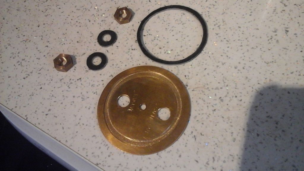

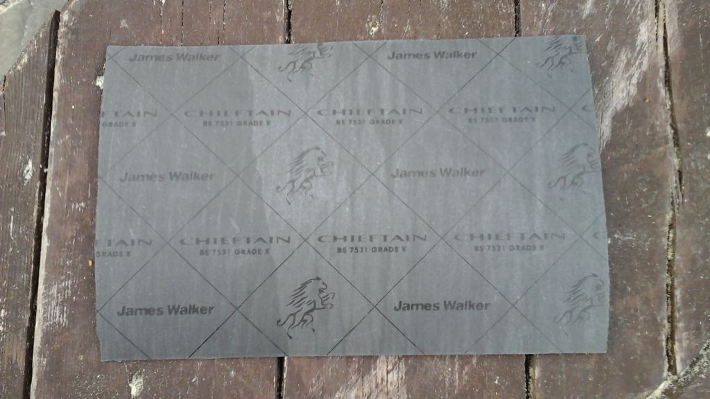

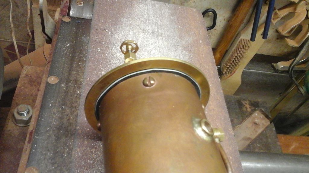

                                              To answer my own question above –
                                              I went to a local suppliers and found this:
                                              It's carbon gasket material, rated at 500 degrees centigrade. I reckon that will do! The stuff is very expensive but he had an offcut which cost me a fiver. It's plain black on the other side, and surprisingly easy to work. I scribed it with dividers, cut it with scissors, drilled it, and cleaned up the edges as best I could on a small drum sander chucked in the drill press. All very easy. Here's the finished set:
                                              Here are the top gaskets in situ:
                                              And here's the one under the cap, viewed from below:
                                              The gaps appear to be closed and I have no reason at this stage to think it won't do the job.
                                              When I was cutting the bush extensions to height, I forgot to take into account the thickness of the gaskets. This turned out to be a blessing in disguise because rather than make new extensions I just skimmed the nuts down to size in the lathe, making them look slimmer and (imho) better.
                                              gary

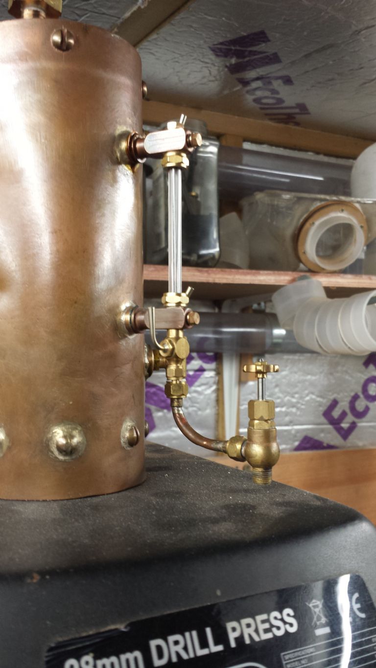

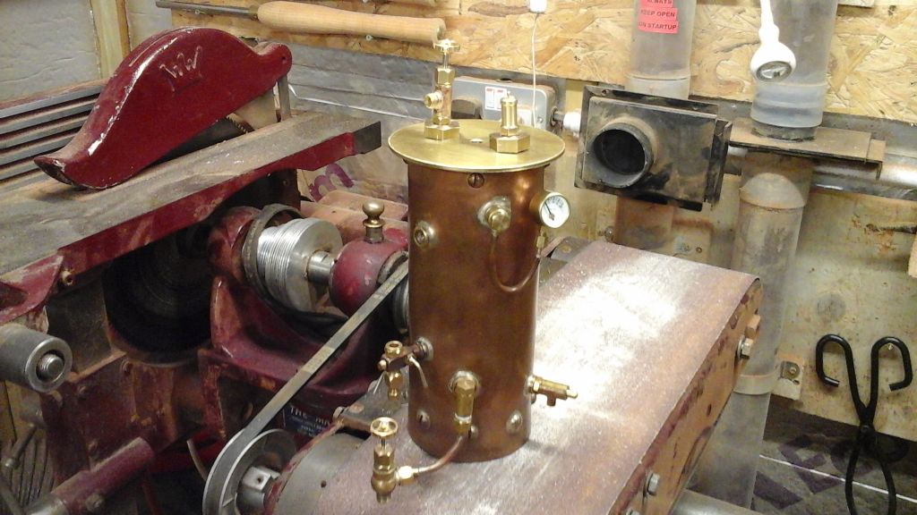

                                                A little bit of progress this evening after a major episode of DIY in the house.
                                                All fittings (apart from the safety valve and the steam pressure gauge) are now in situ for the second hydraulic test at 1.5 x working pressure:
                                                Apologies for the somewhat fuzzy picture. I'll carry out the test at the weekend. The cap and chimney are not yet silver soldered together – the chimney is resting in a circular rebate which I cut around the central hole to approximately half the thickness of the cap. My idea is to give the silver solder somewhere to flow into. Any advice anyone can offer on how to silver solder brass without ruining it will be most welcome!
                                                The photo below shows a close-up of the water level gauge. Fitting it was easier than I expected, though I won't get too cocky until I have seen it not leaking under pressure. I had to make a 1/4" to 5/16" adaptor for the top bush due to a mishap back when I was silver soldering the boiler. It seemed to work ok, but time will tell.
                                                gary

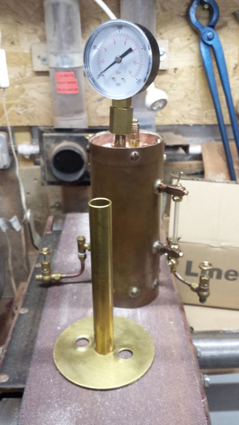

                                                  Chimney silver soldered on to cap:
                                                  #374300
                                                  gary arthur
                                                    @garyarthur48070
                                                    Second water pressure test at 1.5 x WP successful smiley
                                                    All fittings were in situ apart from the steam pressure gauge and the safety valve.
                                                    On to the first steam test next, using gas to fire it with.
